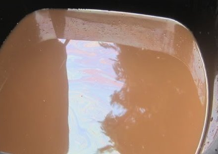

Hi sir, i want to know that how we can know engine continence position from its exhaust. what does black , white and whitish blue smoke mean? secondly how we can know access engine condition by smelling engine oil when buying? can anybody send me picture of blue smoke and white smoke from engine exhaust so i could see the difference in both of them used car? waiting for reply, thanks indeed.

Engine oil -
Black oil - has not been changed or engine is sludged up inside.
Coolant in the oil, will smell sweet, look like a chocolate milkshake and be sticky. (see picture) If the vehicle has been sitting long enough the coolant may settle out. This is even worse as coolant does not lubricate and will destroy the bearings in a short time.
