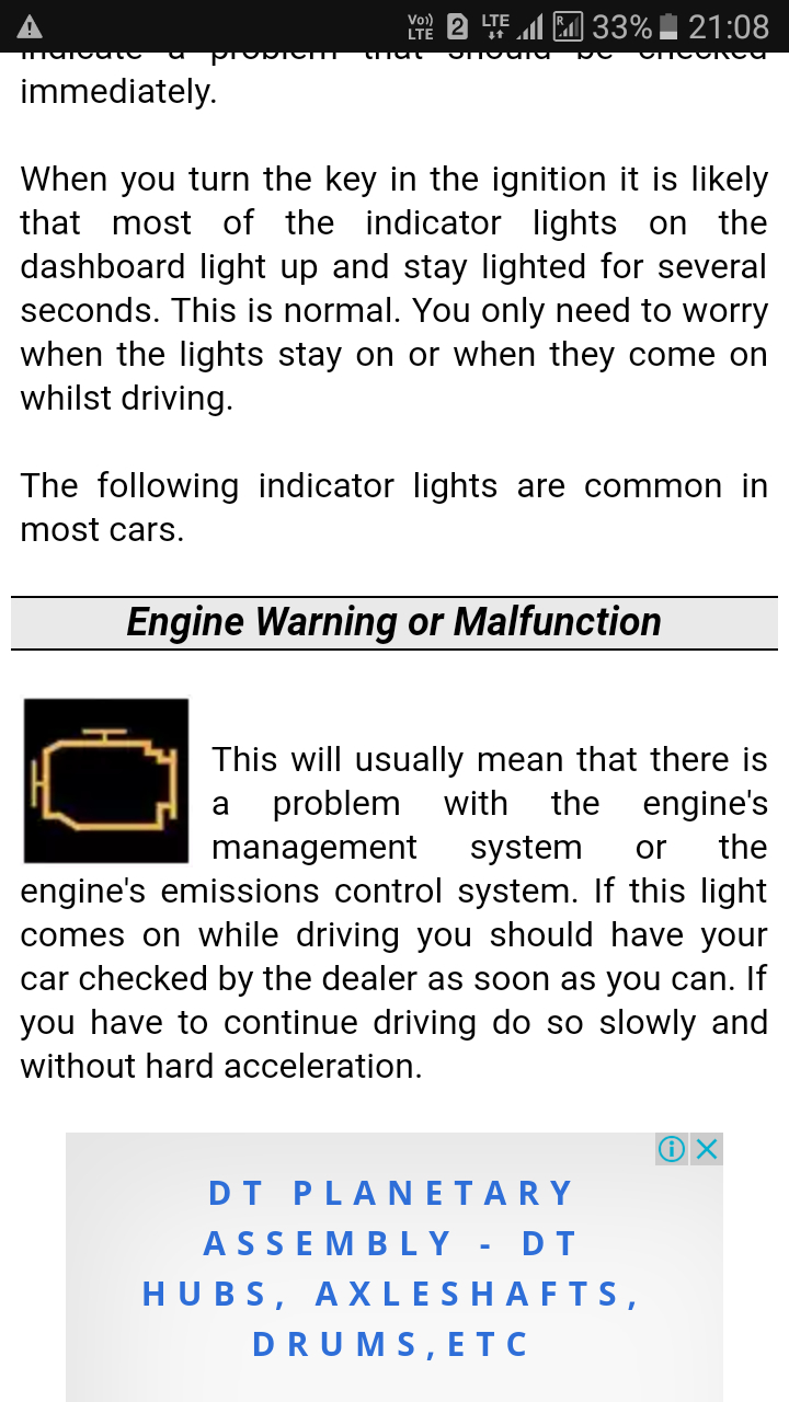

When we drive the vehicle about forty km's it heats up. One alarm is also getting blown continuously. Attached alarm is getting display. Please suggest.

The is indicating that there is a fault code set in the ECU, you will need to get a scan and report the code for further assistance, the code will indicate the problem you are having.

You can also start with checking the thermostat, check that the cooling fans are working and check for any external coolant leaks with a cooling system pressure test, never remove the cooling system cap with a hot engine as you will get scolded.
