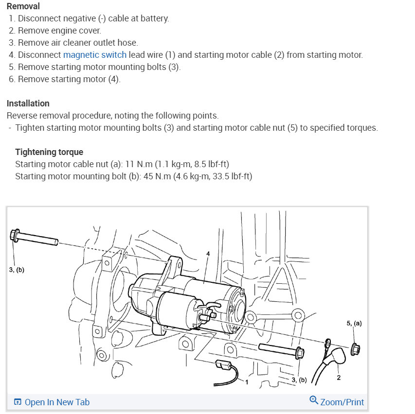

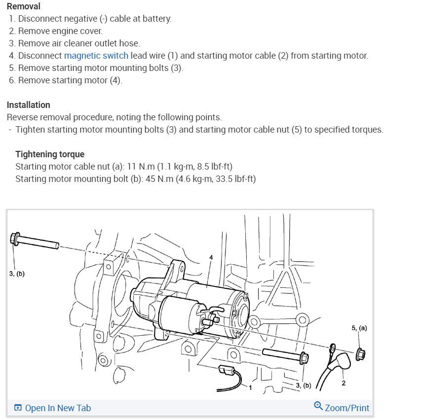

Hi all I have a Suzuki alto 2010 auto, the car will not start I can hear a click sound at the fuse box under the bonnet, but that all the starter doesn't even engage, does anyone have any ideas??? All ideas would be greatly appreciated as I'm in a real hurry to have this problem rectified asap
Feb 22, 2019 at 2:27 AM (Merged)
HMAC300
  • 48,601 POSTS
If the headlights are bright it sounds like the starter motor has gone out but to be sure here is a guide to help walk us through the repair with starter replacement diagrams below.
Check out the diagrams (Below). Please let us know what you find. We are interested to see what it is.
BOOPERIII
Thank you for your post I had this problem and had to get a new starter motor cost me $176.00 all fixed!
