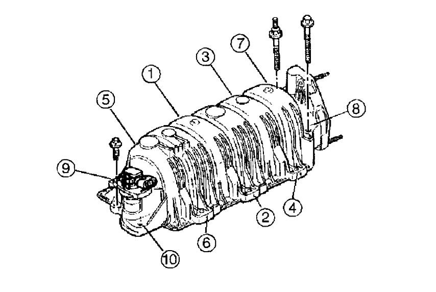

After 4 days in the carport, I turned the ignition switch to start the engine and there was a big bang and smoke and burning smell coming from the engine. When I opened the hood, the force of explosion had thrown the plastic cover ripping the oil filler and the upper manifold. I am sorry I could not attach picture since there is no paste option.

The car backfired in the plenum and that is what caused the explosion. That was a common issue in the older days with the plastic intake manifold.
https://www.2carpros.com/articles/engine-backfires-while-running
The manifold will have to be replaced along with any other damaged parts and then the reason for the backfire needs to be traced down.

12. Remove the upper intake manifold bolts.
13. Remove the upper intake manifold.
14. Remove the upper intake manifold gasket.

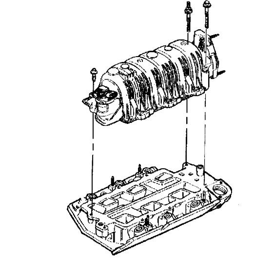

1. Install the upper intake manifold gasket.
2. Remove the upper intake manifold.
Notice: Refer to Fastener Notice in Service Precautions.
3. Install the upper intake manifold bolts.
- Tighten the bolts in sequence to 10 Nm (89 inch lbs.).
