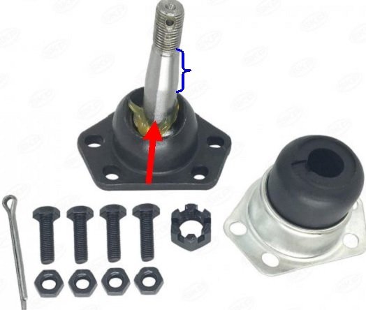

There's two things to be aware of. First, these vehicles eat upper ball joints, I suspect because the upper control arm sits at such a high angle relative to the road surface. I was involved with a half dozen owners, including a coworker, who needed to have their upper ball joints replaced every two years. The good news is since you've replaced them already, they're bolted in, not riveted. That makes replacing them rather easy.
The second issue to be aware of is sometimes rather than design and produce a new part, one that is already in production can work with minor modifications. That includes these upper ball joints. On some models the thickness of the spindle is smaller where the tapered stud goes into the mating hole. You'll see part of the smooth tapered part sticking out after the threads have run out too soon. When that is a possibility, the manufacturer of the ball joint supplies two stainless steel washers for spacers. Those go under the castle nut. The additional clue if these are needed is when the castle nut is snug or tightened to specs, the cotter pin hole will be fully visible outside of the notches on the nut.

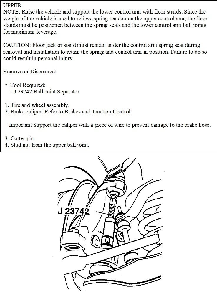

https://www.2carpros.com/articles/how-to-release-a-ball-joint
For this job, jack the vehicle under the lower control arm, not under the frame rail. Jack stands still go under the frame, but only as a precaution. If supported there, the spindle will fly outward when the tapered stud is released, then you'll still need to jack under the lower control arm to reassemble the spindle and tapered stud.
Raising the truck's ride height will also lead to early failure of the upper ball joint. You'll see evidence of that in rub marks on the housing and on the stud by the red arrow in this photo. Two-wheel-drive trucks use coil springs, so ride height sags over time, unless the suspension was modified. It's the four-wheel-drive models that use adjustable torsion bars. People have been known to crank them up too high. That puts the upper control arm in a steeper angle, which will lead to binding in that area with the red arrow. When ride height is correct, the lower control arm will be nearly parallel to the ground. I was going to post the ride height specs for you, but GM didn't include a drawing of where to take those measurements, so the values are useless. Instead, this type of ball joint requires an alignment after they're replaced. The specialist should check the ride height before attempting an alignment. If you want to check it yourself, every alignment shop has small books that show every model and year, the height specs, and where to take them.

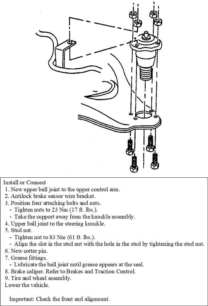

I added the procedure, again for others who might need it, but also because it shows the torque spec for the castle nut. 61 foot - pounds is specified, but if different, use the spec given on the instruction sheet that comes with the new joint.
If the castle nut is not tightened to spec, or you run out of threads as I described, the tapered stud will not be wedged tightly into the hole. The hammering action will break the stud loose, then it will wobble around and elongate the tapered hole. The pounding will also peel the threads and let the nut back off. Either condition requires replacement of the spindle. If you try to reuse it, the stud will wedge in tightly only right next to the last thread. Closer to the ball and the fatter part of the stud, there will be a gap. By not being supported there, the stud will wobble and come loose again. If you're lucky, the nut will back off and cause a clunking noise. If you're not lucky, the stud will snap. Any time you find a loose tapered stud, both the ball joint and the spindle must be replaced at the same time. If only one part is replaced, the wear on the worn part will transfer to the new one, so nothing will have been gained.

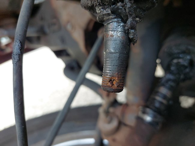

This vehicle didn't seem to go through ball joints before. It went about 120,000 miles when they were changed the first time, then about 95,000 miles the second. I think this could be a manufacturing defect because it went only about 3,000 miles before it went out.
I found a lab that will test the part and see if the metal was up to spec for the purpose it was used. I do respect and appreciate your answer. I really do. I just don't understand how it could only go about 3,000 miles before shearing the threads like that, unless the part was faulty.

Dandy photo. Thank you. The cotter pin looks too rusty for only 3,000 miles, unless you live in a state like I do where they throw a pound of salt on an ounce of snow. There's pitting too on the tapered part of the stud. Water had to get in to do that. This looks like the castle nut wasn't tight enough or it didn't pull the stud in far enough to wedge it tightly in place. Be sure to inspect the hole in the spindle for the same problem and replace it if you see that, otherwise the new stud will develop the same condition.

I forgot to let you know what happened. My mechanic used old ball bearings from the previous suspension and the threads gave out.
