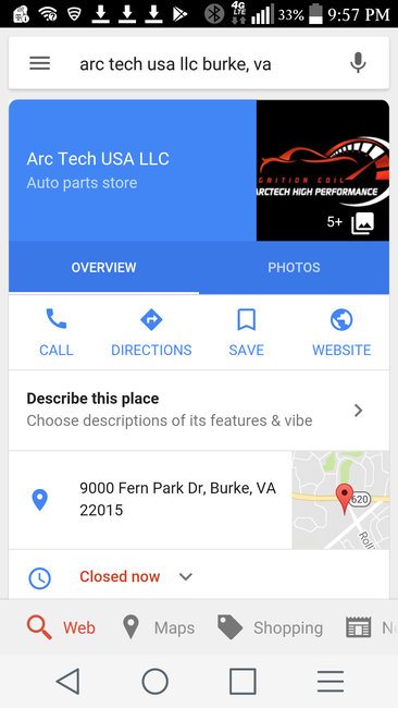

Would you buy car parts online from a website that does not return your emails of questions or never answers the phone? I like to talk to live people and for them to email promptly. If they stand behind their products and offer a lifetime warranty with a defect rate of 0.5% will that be a good aftermarket choice for a set of eight coils for $59.99 for a 1998 Lincoln Navigator? The photo is the website I do not trust because of three days trying to get in contact with them and there is no response or interactions.
Dec 6, 2017 at 11:12 AM
CARADIODOC
  • 34,415 POSTS
At first I thought the price was too good to be true, but I looked the coils up on the Rock Auto web site and found it is in the ball park. I expected the cost to be a lot higher.
I have mixed opinions on customer service. Most parts suppliers have a regular store or multiple stores that are staffed with numerous employees. They are expected to wait on live customers as well as answer the phone. E-mail messages typically get answered by different people as time permits. Those people are likely to be computer people who are not car or parts experts. Their job is to find out the answers to your questions, then e-mail you a response as soon as possible. How long it takes to get an answer may depend on the types of questions. For example, "What will it cost to ship this item" is a lot easier to answer than, "what type of lifters can I use with this camshaft", or "which type of vibration damper do I need if my engine is externally-balanced"? Stores like this have a lot of people who do not make money for the business, yet they expect a paycheck. When a salesman sells a part, the profit has to pay for the office workers, night cleaning crew, delivery drivers, all the utilities, taxes, and insurances, plus the people who answer e-mails, so you know you will be paying a little more for the parts.
Some of these employees are paid on commission for the parts they sell. Not only do they not make any money when they are on the phone, they cannot be taking care of paying customers. The better employees understand a phone contact can turn into a person walking into the store and buying their parts, but do not expect them to discuss the weather or a favorite sports team. They need to end the conversation as quickly as possible while still meeting your needs.
There are some parts suppliers that do not have a regular store front, or even multiple employees. They may not even stock any parts. With such low cost of doing business, they do not need to make as much profit. Their goal is to provide low-cost parts, not good customer service. The ignition coils you want might be "drop-shipped" from the manufacturer right to your house. You pay to the web site, and the site owner pays the part manufacturer. A lot of mail-order companies work this way to keep costs down. If the owner keeps his customers happy, and there is lots of repeat business, he could be running around like crazy trying to keep up with orders. He may forget to check for e-mail messages until it is time to quit for the day and go home. It is also possible he does not know the answer to your question, and needs time to find one. There are times I do not post a reply here right away because I need time to think about it and formulate the best reply I can. A lot of parts sellers on eBay are drop-ship stores too. All they do is handle the money, coming and going. They may never actually touch your parts.
Probably the biggest drawback to buying from a drop-ship company is what do you do with parts that need to be returned? You may need to make the request first, then the site owner contacts the plant where the part was made, they issue a return authorization with a number you have to include, so they know where the part is coming from, and why. Parts warranties and returns are part of customer service, so if this is a possibility, it is best to order those parts from a company with good customer service.
My opinion is to order parts from the lowest-cost source when you do not need special help or have questions, and when there's little chance the new part is defective or will not work in your application. You are getting less personal attention but saving money. Place the order, get the part, and you know what to do with it. When you do need advice or need to talk directly with a knowledgeable person, that is the time to put a premium on individual service, but remember you still might be talking with someone who needs to research your answer. It is rare to get someone who knows every technical answer right away, and you do not want someone making things up in an attempt to look like an expert. I would rather buy from someone who says, "I do not know" than from someone who thinks they can make up an answer that I will believe.
