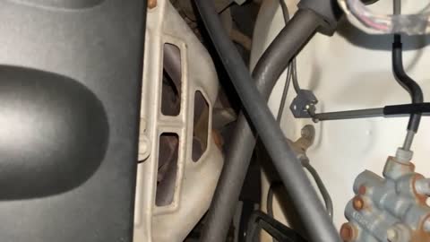

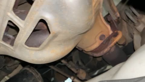

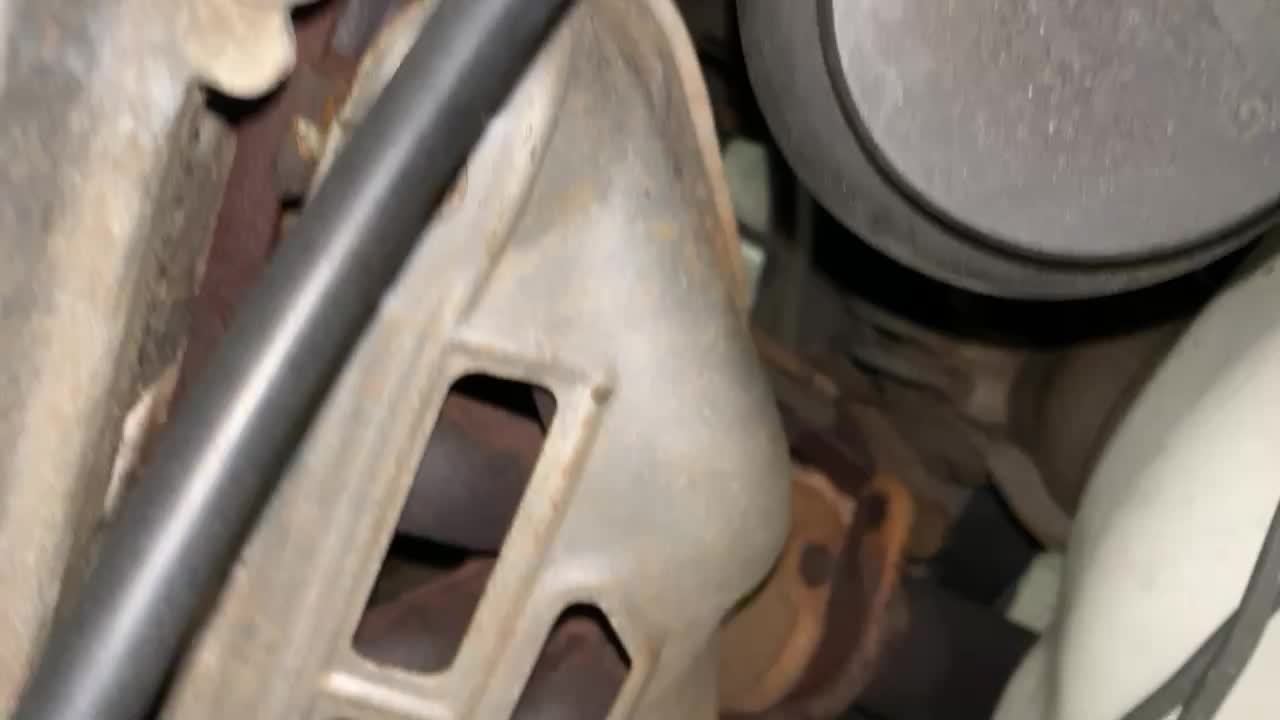

Finally found the culprit to the ringing noise!!! It's a loose bolt on the exhaust from the engine, the sound comes from the washer on that bolt hitting the bolt. not sure to be happy or worried as to why that bolt would be that loose...
Oct 14, 2020 at 2:26 PM
JORDANNGIAU
  • 34 POSTS
Here is a video of it:
Oct 14, 2020 at 2:28 PM
That is great! It is not too common for them to be loose but it does happen. The reason is the exhaust heats and cools so much which causes the metal to expand and contract. This can cause the bolts to loosen and create an exhaust leak or make noise as you have found.
I would tighten them back up and then just keep an eye on it. If it loosens again, I would replace it and the use some high temperature thread locker. Just make sure it is suited for exhaust bolts because you don't want to use the permanent locker because if you need to remove the bolt it may break off in the head and that is not fun.
