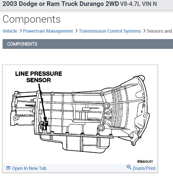

I drive for Postmates and I went on a delivery around 3:00 this morning. My truck drove fine. It has been having a build up of an issue. The acceleration over the past few days has been getting slowly worse. But it drove fine this morning. Then when I went to drive it at 8:30 this morning it went into first and got to 30 MPH but wouldn't go hire and wouldn't shift. So I pulled over and turned it off and back on. And suddenly it will start but wont shift into gear. I did finally manage to get it to drive so i could get it back home. But it threatened to stall anytime i tried pushing it past 30 MPH. I checked all the fluids and all the fluids are normal every day. But I do also have an unexplained leak in my engine bay which i thought was power steering but my power steering fluid is full. It is dirty and I can't figure that out either. I have siphoned out as much as i could and put new fluid in and it got real dirty again fast.

The steering problem can please start a new questions for we will handle the transmission issue on this thread. I have seen the line pressure sensor go out on these but to be sure we should runt he codes to see whats comes up.
The sensor location is below. Please let us know what you find. We are interested to see what it is.
