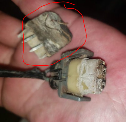

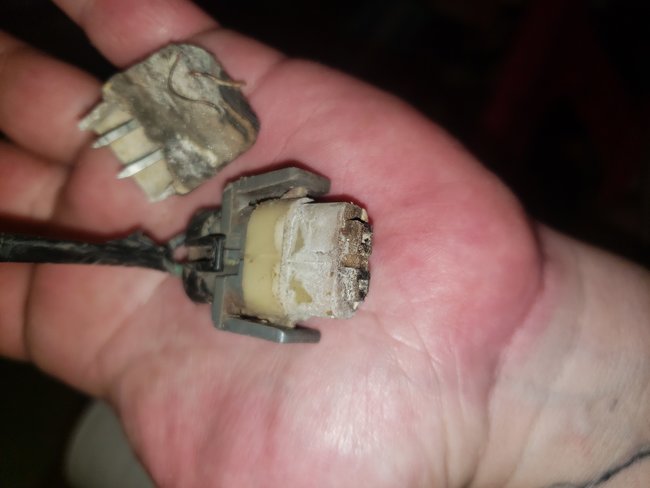

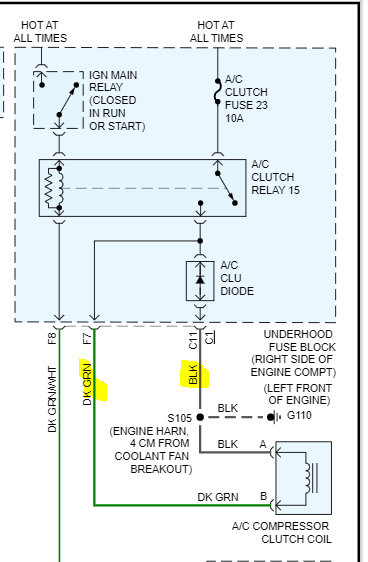

My air conditioner clutch apparently went out. This plug is hanging down from the passenger side front end of my car underneath and I don't know where it goes.

That appears to be a circuit breaker. What color are the wires going to it? I think I see green, but I need to confirm.

One is black and one is green, and I can honestly say I have no idea of where it actually originally was connected because it was just hanging from around the area the air conditioner serpentine belt. The battery and starter are all located and more towards the front of the car underneath is where it was hanging versus the back.

I went through the wiring schematics for the compressor. Actually, the wires going to the compressor clutch are dark green and black. Take a look at the pic below.

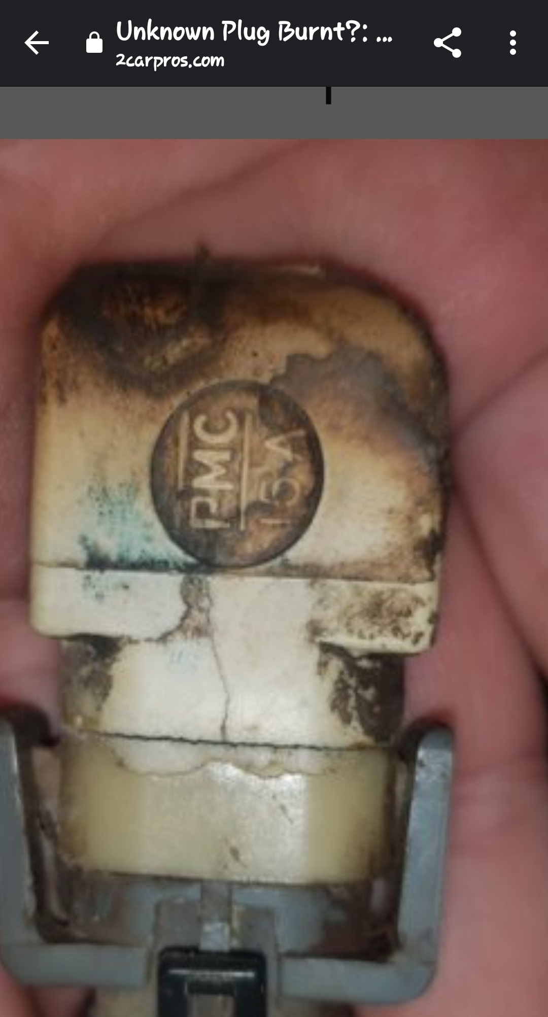

Are you able to follow the wiring to see if it does in fact go to the compressor? Also, is there a part number on the part that plugs into the connector? See pic 2.

That pick of the plug is it! What is that?
Thursday, August 4th, 2022 AT 7:31 AM
  • 109,885 POSTS
I'm not sure. I was wondering if there was a part number on it.

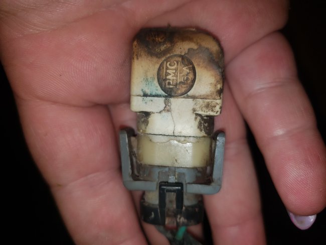

It says PMC 15 A.

Are there any other numbers? At this point, I'm not 100% certain. I believe it is an A/C diode fuse, but I can't verify that.
The wire colors should go to the compressor. Have you been able to trace them?

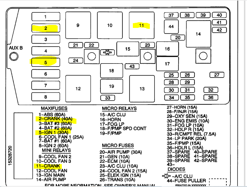

Not starting isn't the only problem, it doesn't crank at all. It acts as if the battery is draining. But the battery is brand new.

If the battery is good/charged and neutral makes no change, then we need to start checking fuses. There are several that need to be good for the starter to engage.

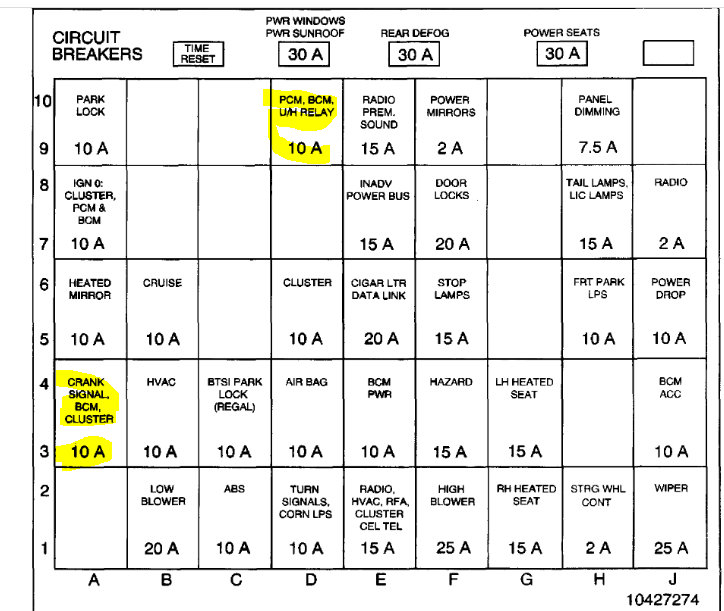

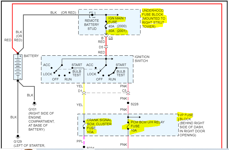

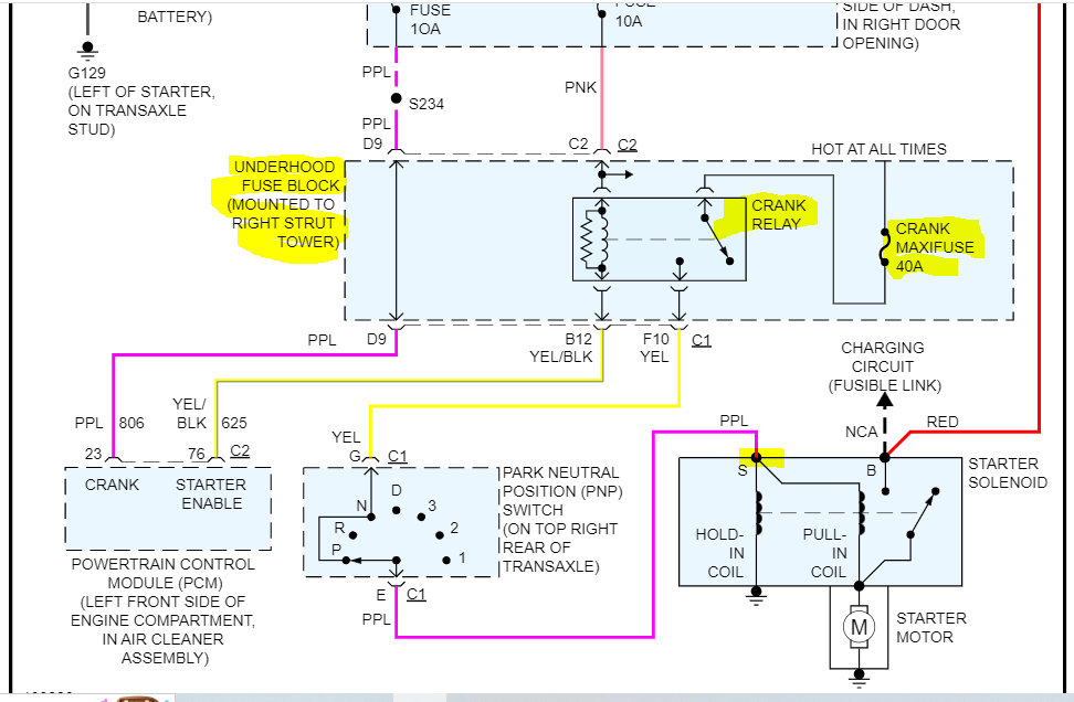

Below, I attached the wiring schematic for the starter circuit. I highlighted all necessary fuses for things to work. Additionally, there is a starter relay that needs to be checked if the fuses are good. So, the easiest thing to do is this.
If you have a helper, locate the purple wire on the starter motor. That wire will only have power when the key is in the start position. At all other times, it will not have power. So, have a helper turn the key to the start position while you check for power at the purple wire. If there is power, then we know the relay and fuses are all good and the starter is bad. If there is no power, then check the fuses. In addition to checking fuses, make sure there is power to and from them.

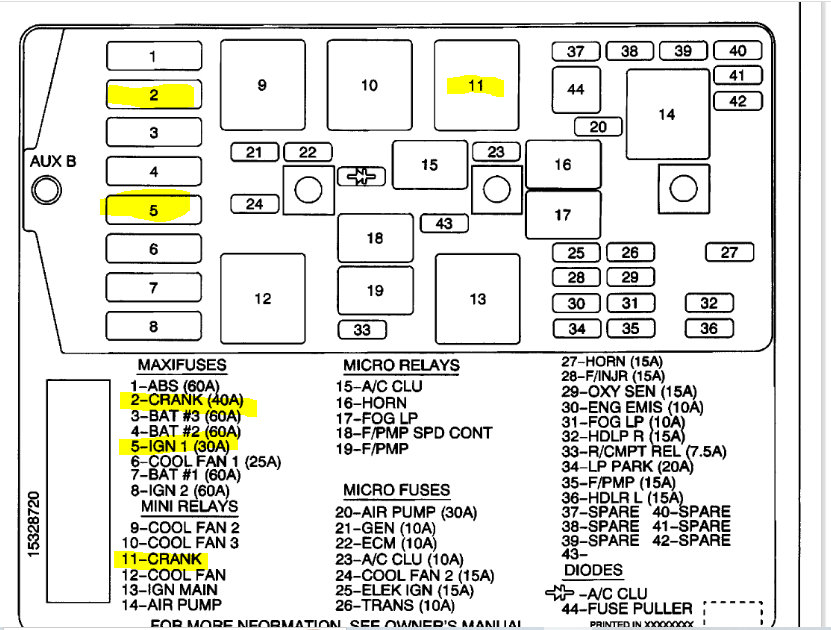

If all fuses are good and have power, we need to test the relay. If there is a different relay in the box that has the same part number, switch them. If there isn't one, here is a link explaining how to test one:
If the relay is good, then we will need to check for ground issues for the relay. We will cross that bridge if needed.
The last two pics show the locations of the relay and fuses. Pic 3 is the under-hood fuse box and pic 4 is in the vehicle.
see pics below.
