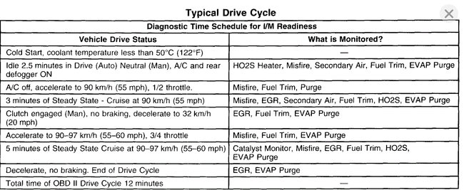

After you do your cold start, do you have to go and accelerate to 55 mph right then and now? I have to drive out of my neighbor hood first, go through a couple of lights and stop signs before getting on the bypass. Does this break the drive cycle?

Interestingly, it is all based on what component you are waiting to reset. A drive cycle isn't necessarily one trip. It could require many miles for a system to reset.
What exactly are you trying to reset? And no, the speed isn't immediately. What the directions indicate needed to be completed at some point.
If you look at the attached picture, it shows what a "Typical" drive cycle is. On the right side it indicates what components are reset and on the left what has to happen. Please understand, this is what is considered a typical cycle. It doesn't always happen as quickly as indicated.
Back to your original question. No, the cycle is completed when the drive status you are trying to reset is reached. It does not have to happen immediately.

To add to what Joe posted. Some of the monitors take very specific conditions to run. For instance the EVAP tests will normally only run with the tank between .25 and.75 full and with the coolant temperature close to the outside air temperatures.
This is the EVAP Drive cycle on your Camaro -

In theory these should run and set from a cold start, however some can be a big headache to get them run, plus it is possible that a code or mechanical issue that doesn't turn on the CEL could cause one or more to fail to run. Note those EVAP cold start temperatures. See that the test doesn't run if the temperature is over 86 degrees or so? So if you're in a desert area with normal temperatures at 90 plus degrees daily, it could take a while for that one to run. That is why most states have an allowance for an unset monitor on older vehicles.
It is also why GM added the service bay test on the scan tool, It allows the test to run with higher temperature thresholds for those hard test areas.
