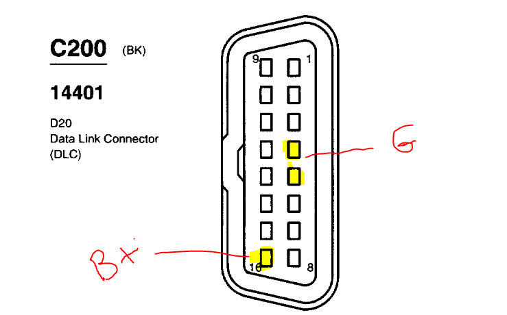

After I ground the valves, I could start the car. I attempt to carry out scanning but failed to communicate. PCM is not communicating with scanner. The major issue. Thanks
Oct 6, 2023 at 2:46 AM
  • 110,251 POSTS
Does the scan tool power up when connected to the DLC? Was this an issue prior to the valve job?
As far as the communication issue, first, check pin 16 in the DLC for battery voltage. It should be present at all times.
If that is good, check pins 4 and 5 in the DLC for a ground path (continuity to ground).
See pic below of the DLC. I highlighted the connectors to check.
Let me know what you find.

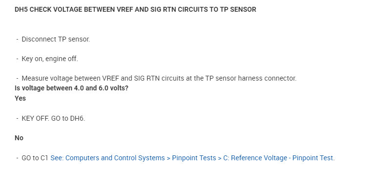

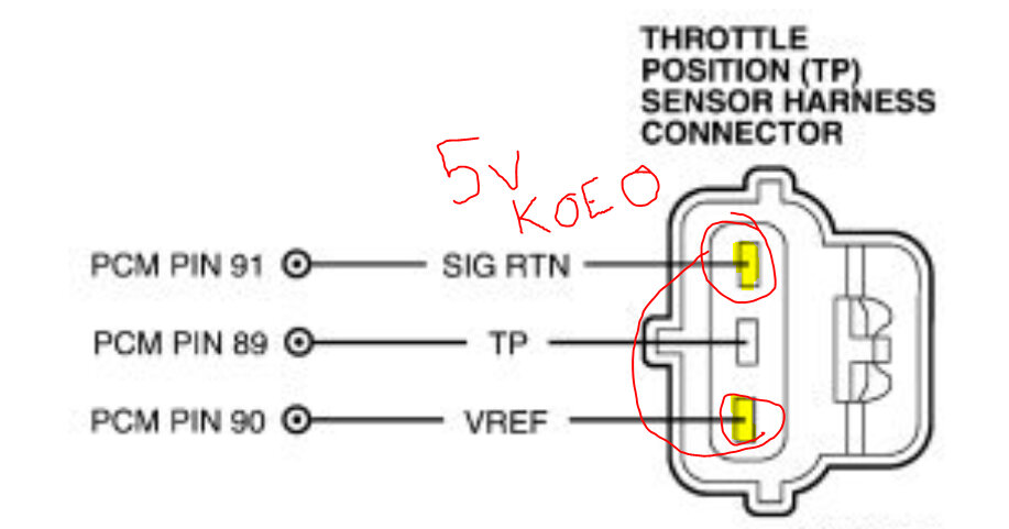

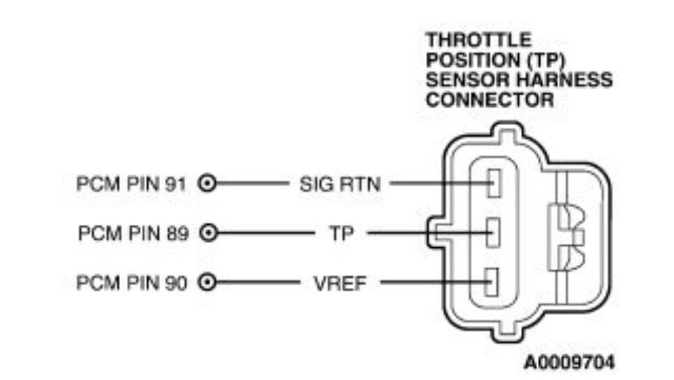

Good day, thanks very much for the kind assistance. I tried to measure the 5v ref of the TPS and the value fluctuates between 0.22 to 0.24. I checked for battery voltage pin 16 and got 0.02. When I plugged in the scanner, it powered up but reads linking error, failed to communicate. When I turned the ignition, the attached video was displayed on the cluster panel. What should I do next?

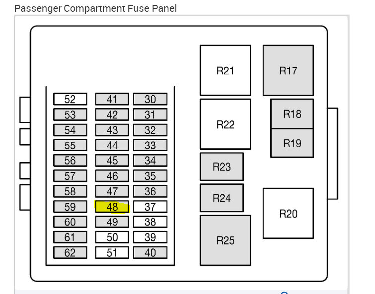

Pin 16 should have 12v (B+ voltage). Did you check the fuse? It is fuse 48 in the central junction box inside the vehicle. See pics below. That power is sent to the DLC directly from the fuse, so there isn't a module controlling it. If you only have 0.02v, that is a problem.
Let me know about the fuse.

Good day sir, I guess I wasn't doing it right before now. So, I got 12.4 volts at pin 16 of the DLC. As for checking for the grounds in pin 4 and 5, I disconnected the battery and turned the knob to 2k 20k 200k 2M ohms. I was getting varying fluctuating values in all of them. I don't know which of them will produce accurate value or how to test for ground (continuity). The 5v ref remains at 0.22 to 0.27 thanks for your assistance. I am glad you help. What should I do next?

If you are checking power at the fuses, you can use a test light. If you do use a multimeter, it shouldn't be set on mA. That is milliamps. That is for a much lower voltage. Set it on a standard amperage setting. Check the setting at the battery. When you find the setting that shows 12v, that is the one to use.
Also, here is a link that explains how to test a fuse. It will help you through the process.
As far as the TPS voltage, it shouldn't be that low. Take a look at pic 1 below and let me know if you are comfortable performing it. It explains how to test for voltage at the connector itself. I also attached the connector pinout, so you know which ones to check.

I appreciate all you do. In testing for the 5v ref, I placed the red lead in the SIG RTN and VREF, got same value. The value is even dropping. I use the chassis as ground, same response. I might be getting the testing right. I think that is where the issue lies. The PCM not communicating with the DLC. What are the possible test I can do to detect this short. What should I be looking at. I believe this the image of the TPS. Thank you very much for your concern and help.

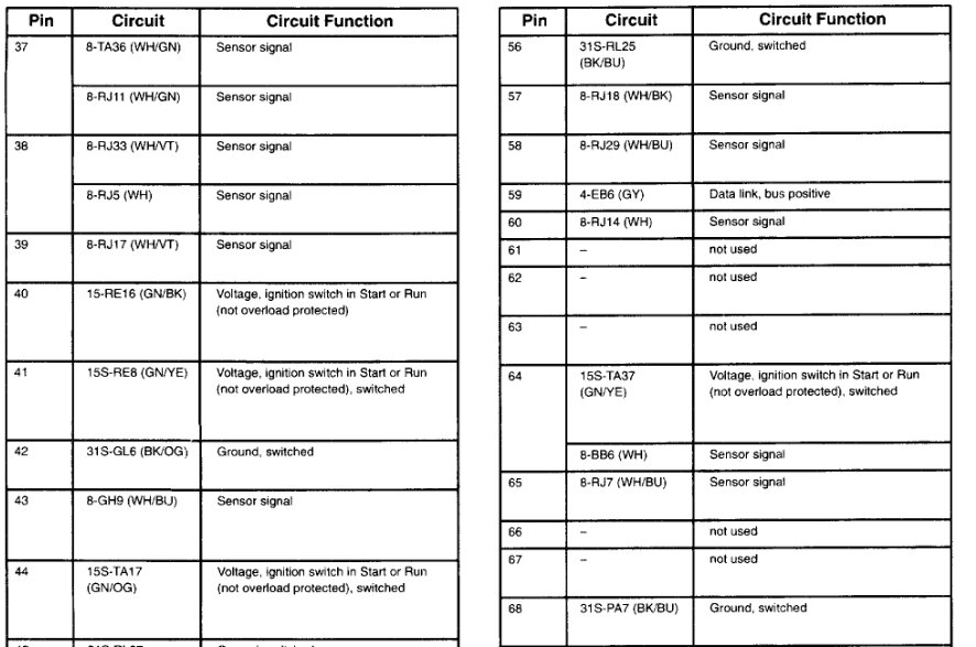

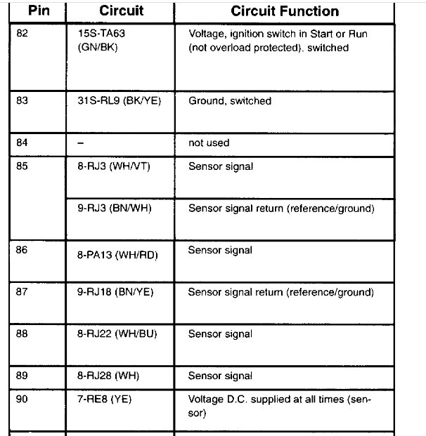

  • 110,251 POSTS

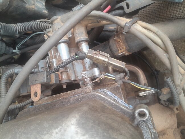

First, I attached a pic below showing where to check for a 5v reference signal. See pic 1. Use your multimeter and connect one probe to one pin and the other probe to the other pin. With the key in the run position (engine off), see how much voltage is present. It should be between 4v and 6v. If it still is very low, then either we have a wire issue, a connector problem, or the PCM is faulty.

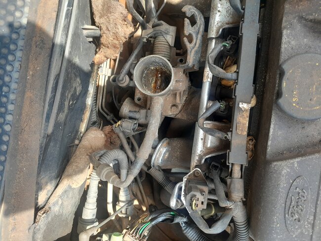

Pic 2 is from what you sent me. Have you tried cleaning it? I ask because the throttle body. bore and the throttle plate have a special coating applied during manufacture which should not be removed. It looks exceptionally dirty, and it also appears there are two bolts missing (circled with blue) (TPS circled with red).

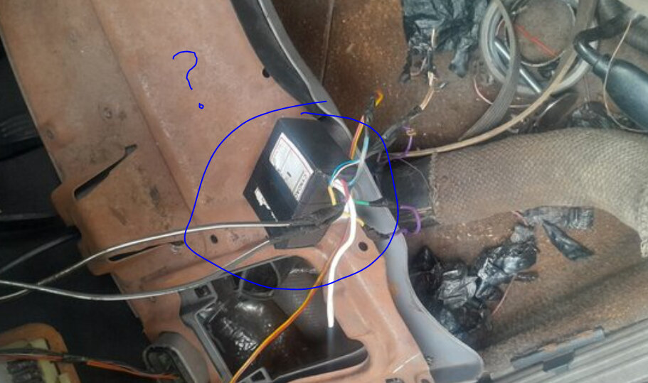

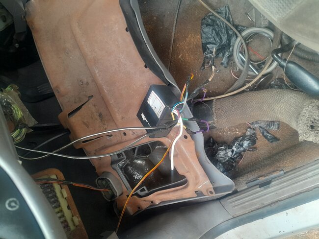

At your suggestion, I have gotten a new PCM with programmed keys. However, i want to find out the cause of the short first before installing it in order to avoid damaging the new one. I don't think at any time I have cleaned the throttle body. Should I do that because I have intentions of detailing the whole engine if the car can start running. I want to get the service of a technician that might assist. My major concern now is the wires. I also observed that I can't remove the key after I turned on the ignition until I disconnect the battery. There is box I don't know its functioning but looks like the security. I don't know if it is contributing to the issue. Thanks very for the keen interest and God bless you richly.
Oct 30, 2023 at 4:09 PM

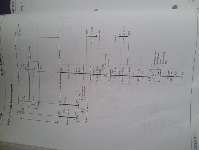

  • 110,251 POSTS
In your last picture, where is that located? It looks like someone wired that in place using electrical tape.
As far as the short, before you remove the PCM, locate the power supply connector at the module and check if power is present at the module. If it isn't, I suspect the short is internal in the module itself.
See pic below.

The car has active antitheft. There is a small button I used to click and then turn on the ignition before I start the car. I don't know if this antitheft comes with all model of the car or the dealer I bought the car from install it himself. I think the click button is wired to this box but don't know where this box is wired to. Can I ask what is pin on the PCM to check the power supply. Thanks very much for your concern and time. God bless you in many ways
Oct 31, 2023 at 4:48 PM

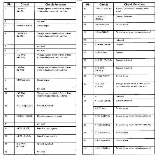

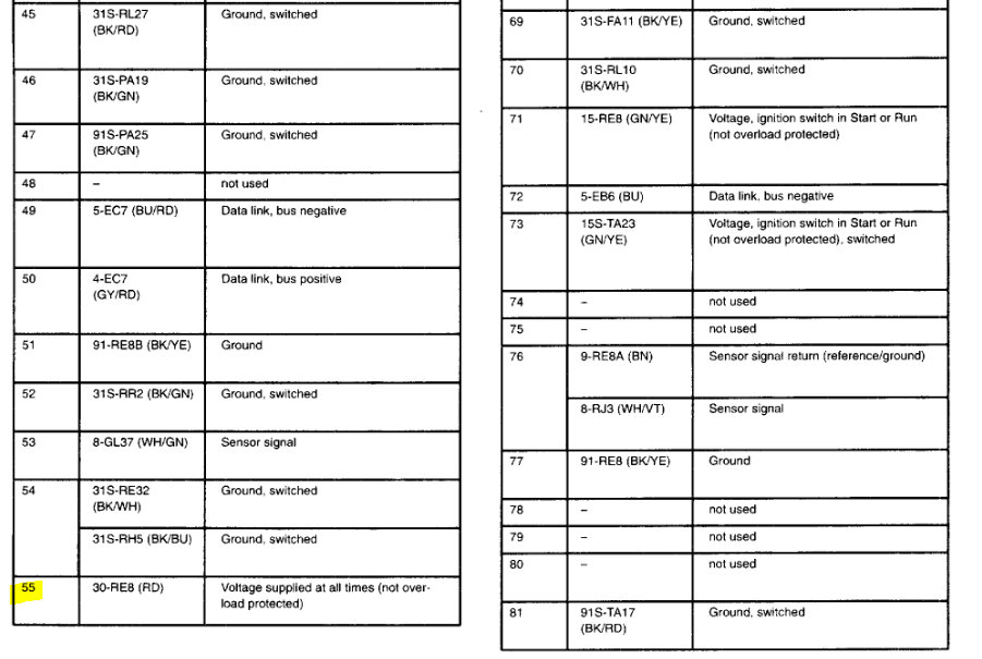

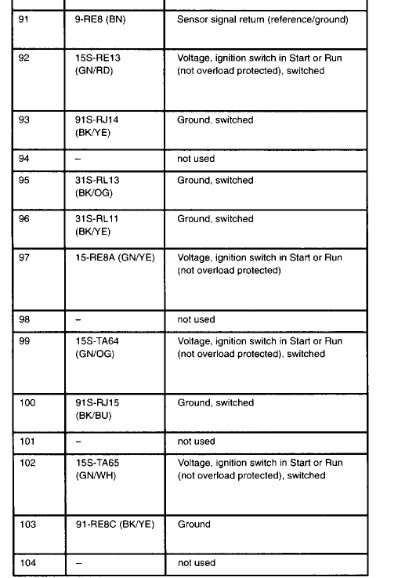

  • 110,251 POSTS

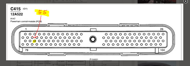

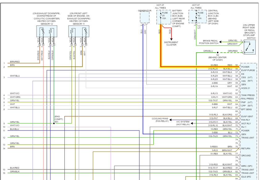

The switch wouldn't be a factory option. Someone added that to the vehicle. As far as a power supply to the ECM/PCM, it is provided via fuse 20 in the battery junction box. It is a 10-amp fuse.
I attached the wiring between the ECM/PCM and that fuse. The connector pin is 55 in connector C. The wire is red in color.
See pics below. Note: Fuse 20 should have battery voltage at all times.

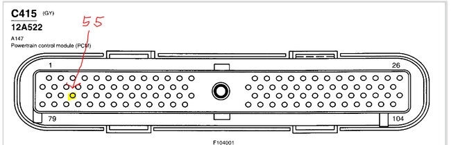

Good day sir, I can now test the fuses using voltmeter, fuse 20 is okay. Fuse 30 and 40 didn't give any reading. I couldn't locate pin 55 on the PCM. Still thinking about the possible cause of the short. If the 5v ref is so low, maybe injector or ETC won't get any. Thanks very much for your efforts, I still look forward to your contributions. Thanks once again and God bless you

  • 110,251 POSTS
Fuses 30 and 40? One is the light switch, and the other is the back-up lamps. (CJB). See pic below.
As far as pin 55., does the connector look differently than the one I attached above?

Greetings boss, the fuse 30 and 40 I am referring to is in the BJB. Maybe that is the rating. What I mean by locating the pin 55 is if it could be cycle on the image just like the pin 16 of DLC for easy identification. I can't place the transceiver ring round the key cylinder. Does it in any way affect the readings and output at the PCM. As part of the development of the whole problem. When the low oil pressure and battery charging was indicating in the cluster illumination. The headlamps stopped working. I experienced hard starting then. As of now, I feel it was because of the short issue, they stopped working and radiator fans weren't working then too. I would like to resolve those issues as well. I contracted a technician who will be on ground on Tuesday. I also want to be guided to avoid repeated flaws. Thanks once again and I remain grateful.
Nov 5, 2023 at 4:23 AM
MAMIRORO SMITH
  • 83 POSTS
Circle it on the image of the PCM connector.
Nov 5, 2023 at 4:51 AM
  • 110,251 POSTS
I copied my pic from above. Let me know if that helps.

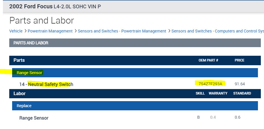

The technician has been able to do of the job. He said the transmission sensor is bad. Rodents has cut off the wire to the fuel pump socket (connector). Can I get the part number for these? Going by him, the car will start now. You have been of immense help and support. God bless you for showing so much concern.
Nov 8, 2023 at 4:09 AM
  • 110,251 POSTS
As far as a part number, I did find one for the transmission range sensor. See pic below. That is the OEM part number. As far as a part number for the fuel pump wiring harness, that isn't something that is provided in any of my manuals.
Let me know if this helps.
See pic below.

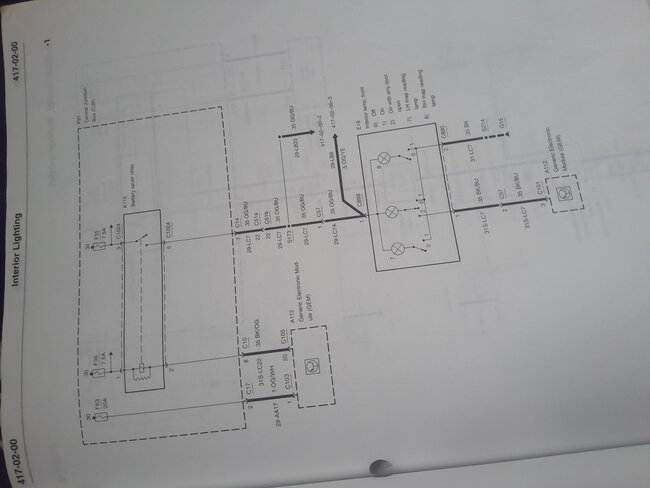

Good morning, sir. I left the battery insitu in the car overnight. I checked it at the night, it was 12.32. And this morning I went to check it again. It is 12.25. I am still leaving it in the car till in the evening to see the reading. He carried out the procedure you mentioned in the course of his work. One of programmed key was cut manually, so it doesn't fit well. Trying to get the other one cut. As far as fuel system, he suggested i change the fuel filter and i am trying to get that. I still see the car starting with so much resistance which it was supposed not to be. Thank you very much for coming through.
Nov 14, 2023 at 5:24 PM

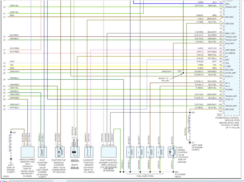

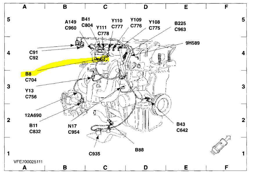

MAMIRORO SMITH
  • 83 POSTS
Could there be correlation with the images and what I am insinuating, and the seatbelt illumination could an indication of something?

I don't feel what is identified in the schematic is the issue. Also, the battery drop isn't too bad. Remember, there is a constant draw on the battery at all times regardless of if the key is in the ignition or not.

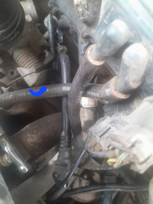

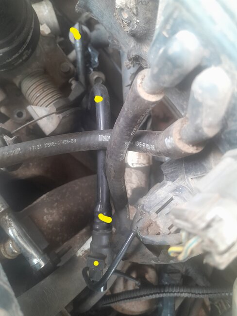

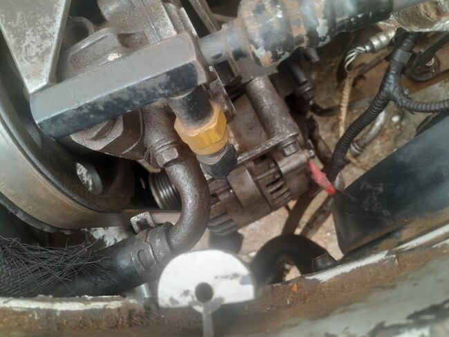

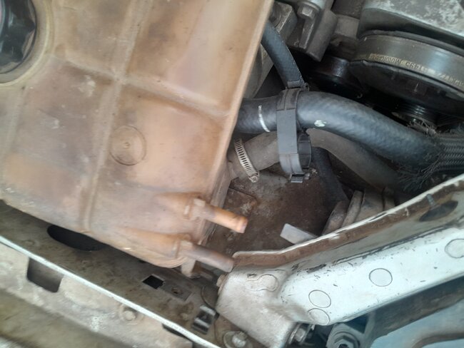

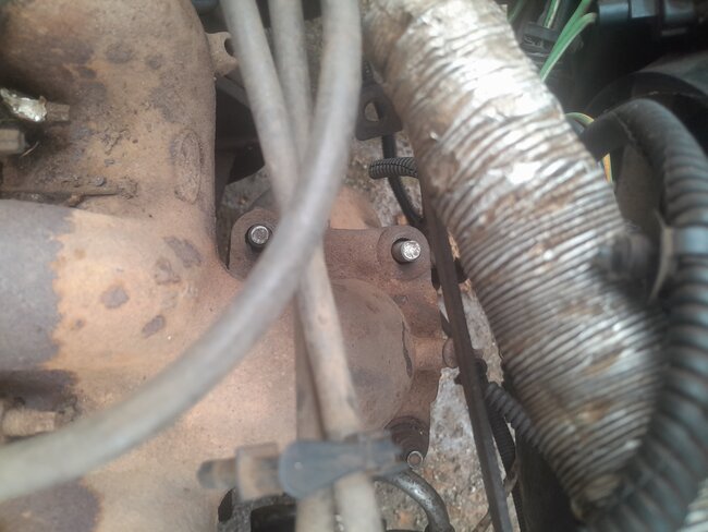

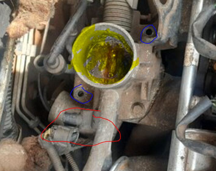

Good day boss, a wrap up of the components that need to be fixed before the car can be on the road. I just discovered to my greatest dismay that I couldn't find the power steering switch connector. I saw it on rockauto.com but don't know the perfect match. I also need to replace the upper coolant reservoir hose, ignition capacitor, the exhaust nut, the throttle body bolt you identified earlier, the injectors, the horn, fuel filter. I might not have OEM of some of these parts again. Kindly help me with the part numbers or a direct link to source for them online. It could be their aftermarket or rebuild. The one you feel could be affordable and reliable quality. I want to avoid error because of the time and distance for me to order and receive them. Thank you very much and God bless you real good. We have made so much progress. Thanks to your support, patience and time.
Nov 28, 2023 at 8:10 PM
MAMIRORO SMITH
  • 83 POSTS
In addition, please where does the hose I identified with blue go into and the one with yellow coming from the exhaust seems to be broken off at the opposite end. Where is it supposed to continue to or join to? Thanks once again.
