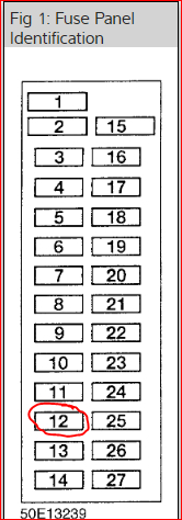

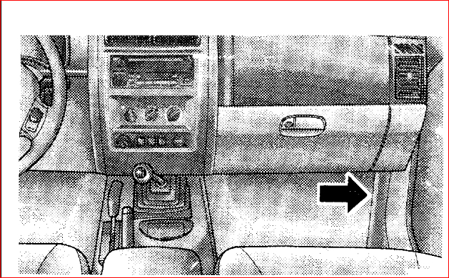

My son has replaced my headlights and the orange bulbs on my Grand Cherokee Laredo, after replacing them we checked to make sure every bulb was working correctly and it was. So everything was secured back. And adjusted. All was good, when I was leaving I noticed when making a left turn I had no blinking signal inside the dash, so I pulled over to check and found that I had no blinkers or flashers. As a single woman what can I check to possibly fix this issue and I will need to know where as I will be doing this myself?

First thing you should do is check the fuses. Here is a tutorial for you to view showing what is involved.
I've also attached two pictures below showing the fuse/junction blocks location. It's located in the passenger kick panel. Fuse # 12 is the fuse you need to check and I circled it in red. Hope this helps and feel free to ask any questions if needed.Thanks for using 2CarPros.
