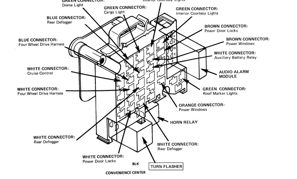

Turn signals will not flash, they come on but do not blink. the four ways work. I have replaced the flasher under the dash. I read that there is a relay in the electrical convenience block. is this true and what does it look like?

The turn signal flasher is on the fuse block. I attached a picture for you to view.
