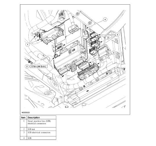

My turn signals are not flashing at all on the inside and the outside. Trying to find that relay is hard. Can I get any help?

The flasher is part of the smart junction box or fuse box. It is a module.
The flasher function for this vehicle is provided by the Smart Junction Box (SJB).
Do you have a scan tool that can access the body control module as this is the SJB?
In most cases, it is the SJB that is the fault but must be verified.
Are there any codes set?
Removal and Installation
1. CAUTION:
Prior to the removal of the module, it is necessary to upload the module configuration information to the appropriate diagnostic equipment. This information needs to be downloaded into the new module once installed.
Electronic modules are sensitive to static electrical charges. If exposed to these charges, damage may result.
Disconnect the battery.
2. Remove the RH A-pillar lower trim panel.
3. Disconnect the 2 SJB electrical connectors.
4. Remove the SJB nut.
To install, tighten to 5 Nm (44 lb-in).
5. Slide the SJB down and position the SJB forward to access the rear electrical connectors.
6. Disconnect the 6 SJB electrical connectors
7. Remove the SJB.
8. CAUTION: Make sure that the wiring harnesses are correctly routed. Pinching the wiring harnesses between the SJB and it's mounting surface may cause damage to the wiring harness.
NOTE: Do not remove the watershield from the new SJB.
To install, reverse the removal procedure.
Once the SJB is installed, it is necessary to download the module configuration information from the diagnostic tool into the new module.
