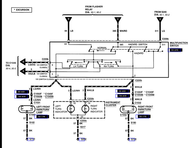

What did the 2008 mirror come off of? I could look up the wiring and see what does what. How did you wire it into the system? It sounds like it is connected to the brake lamp circuits and not the turn signal circuit.
The turn element needs to connect to the light green with white stripe wire for the left and the white with light blue stripe wire for the right. The running lamp gets connected to one of the brown wires for the parking lamps.

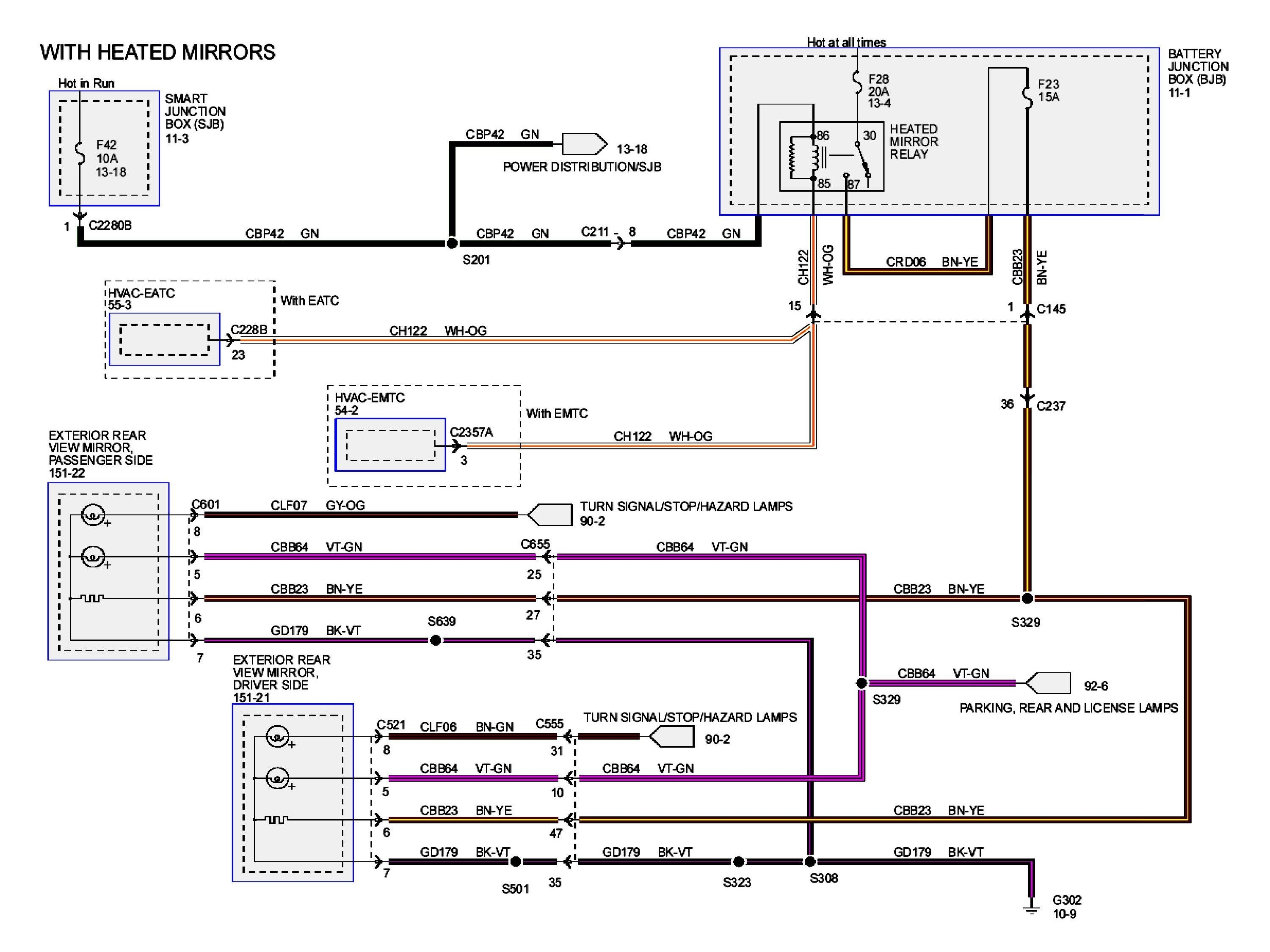

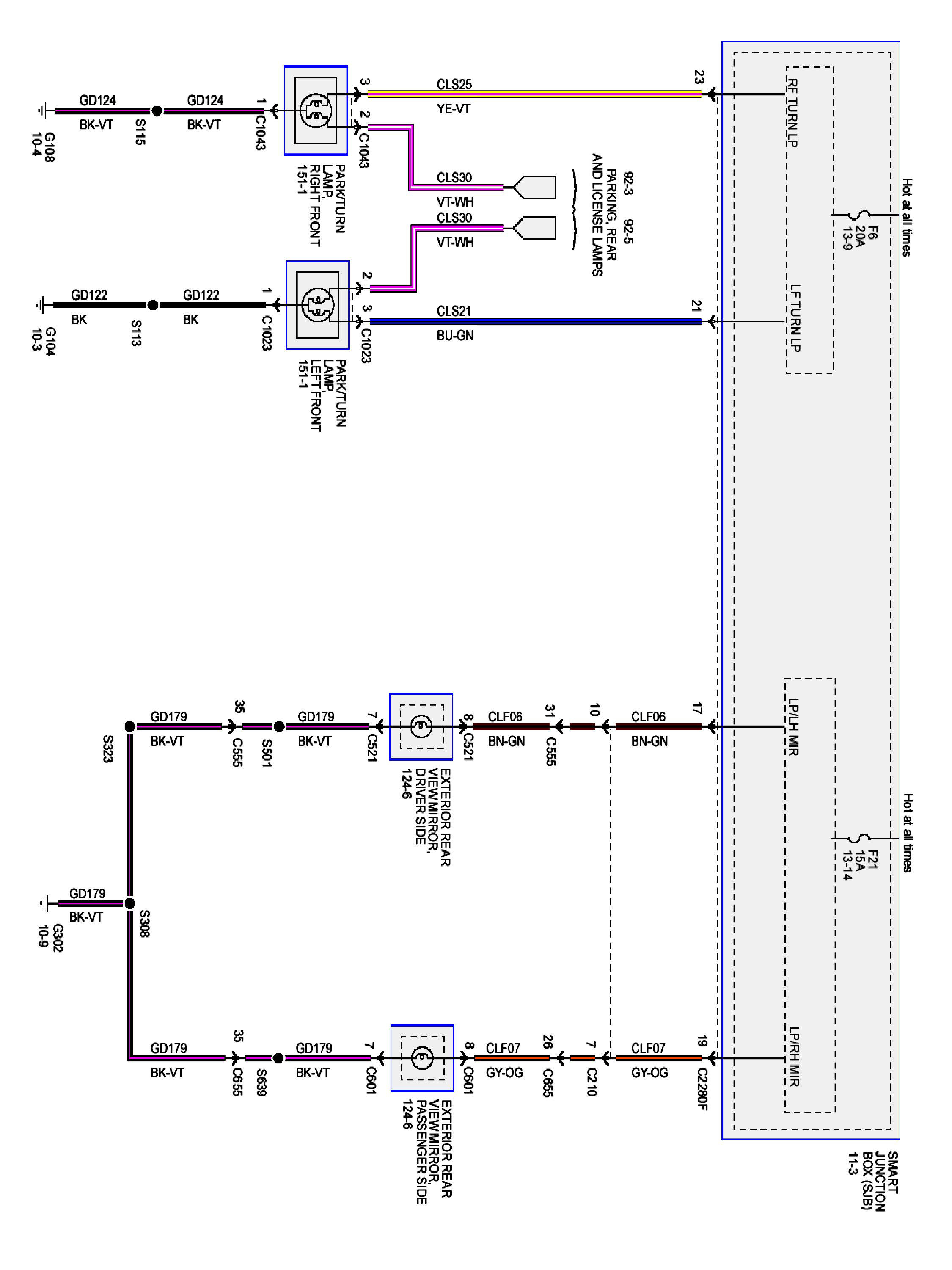

OK, this should be the wiring for the heated and lighted mirror wires for the 2008 F250. Looking at the schematic yours may be operating correctly for the way the 08 works. Looks like they are fed marker lamps, and turn/stop. So it should have running lights. Then the Turn/Brake/Hazard lamps as well.
Looks like they are fed the same way as the taillights. If I'm correct they should come on with the brakes, then when you turn on the turn signal for the drivers side, it should flash as a turn signal and the passengers side should stay on like the brake light.
If you wanted to change it so they only have the running light and the turn signal you could simply run a feed wire from the front turn signal feeds. Attach those in the place of the current feed from the rear lights and you would lose the lights on with the brakes. If you wanted to change it the wire colors in the first post would do it.
