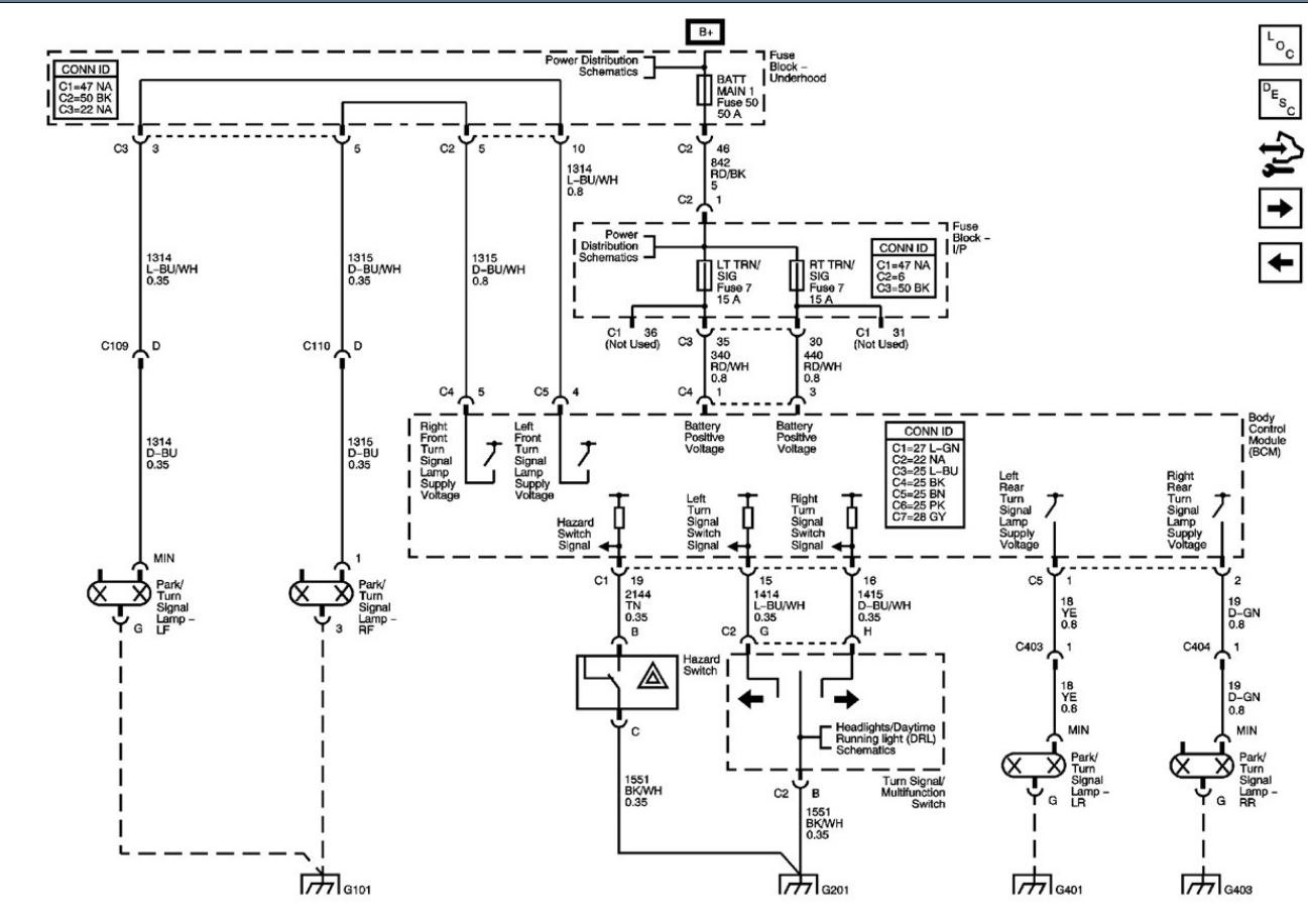

first one blinker stopped working, now both have, hazards work other functions of the multifunction turn signal switch seem to work as well. (flash to pass, etc.)
as far as i can tell there is just the BCM involved for control, but every parts site has a turn signal relay listed for this car as well so i was wondering.
should the feed from the BCM to the turn signal switch be battery voltage? both of those seem to have zero or some partial voltage. the ground at the turn signal switch does seem to go to ground properly.

Looking at the OE wiring it shows the switch sends a ground signal to the BCM to activate the turn signal for each side. The BCM then controls the voltage output to the turn signals and should send battery voltage to the lights with the front and rear operating off of different outputs. Are both front and rear signals out but hazards work on all corners? How about the dash indicator, does it show left and right operation?

1414 currently has voltage present at the multi function switch (the working side)
1415 does not have voltage at the multifunction switch
My fuses are different than this, though (although both have power) fuse 10 and 7 are listed for left and one for right and they are different sizes which is a bit odd.

Both of those wires should have voltage when the switch is open, then they are pulled to ground when you use the switch and that triggers the BCM to tell it which side you are turning on. From your description sounds like the BCM is failing.

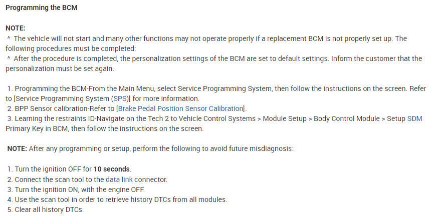

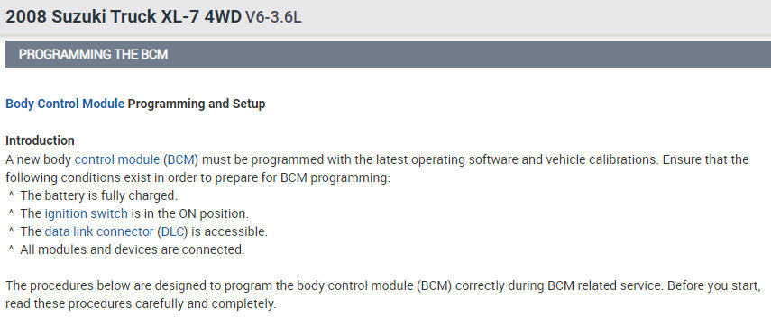

The BCM on those is not a drop in part. They need to be programmed through the online data link and have the restraints initialized and the antitheft programmed. Most times they won't even run without being programmed. These are programmed through GM Tech2 tools with the correct interface box. Those are getting hard to find these days. You might be able to find one that is programmed to your vehicle online, there are places that can do that. Or if you have the tools you can do it.

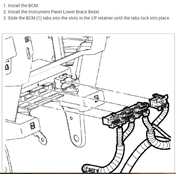

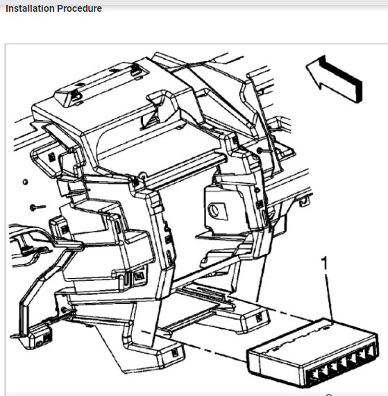

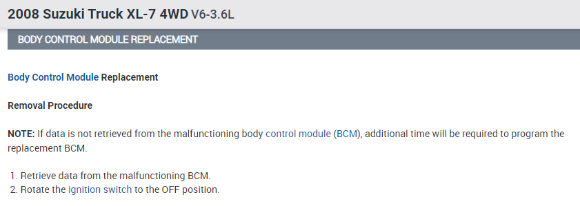

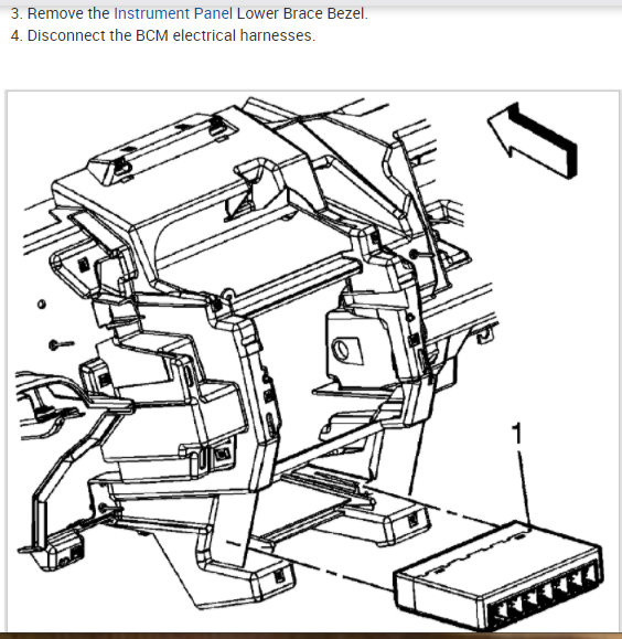

Hello again.

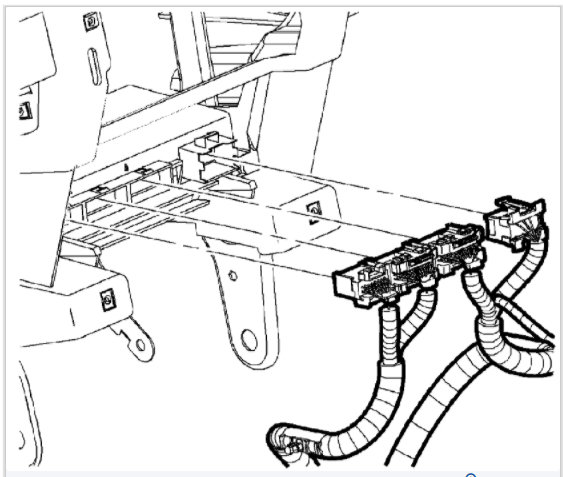

Yes, I'm in agreement as well with a failing BCM after reading these comments. I've attached picture steps below on how to remove and replace the BCM. Depending where you purchase the BCM it might need to be reprogrammed as well. I've also included those steps below as well. Hope this helps and thanks again for using 2CarPros.
Danny-
