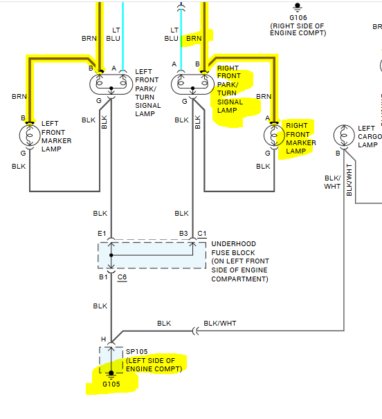

Front right turn signal won’t flash. Light is on, back signal works fine.
Jan 18, 2025 at 2:51 AM
  • 110,240 POSTS
When you turn the signal on, does the rear flash faster than normal? Does the front one turn on at all?
There will be a brown wire at the light. Check to see if there is power to it. If there is, check for continuity to ground via the black wire.
Let me know what you find.
See pic below.
Jan 18, 2025 at 11:05 AM
