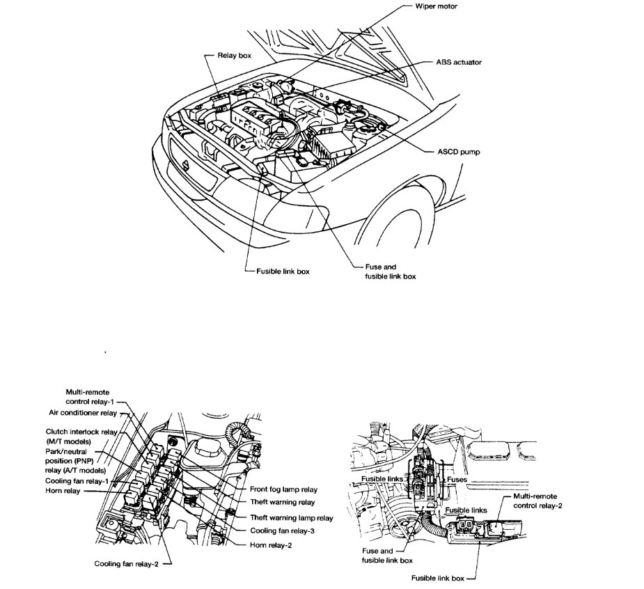

Turn the key, no accessories, no lights, cranks but will not turn over?
1998 NISSAN SENTRA
160,000 MILES • 1.8L • 4 CYL • 2WD • AUTOMATIC
TTREAT2196
First off, the Serpentine and water pump to power steering pump belts shredded so I had someone replace and for some reason they unhooked the alternator to have maneuverability, but they forgot to Disconnect the battery and it popped the main fuse when they hooked it back up after replacing refuse now when I put the key in. I have no accessories, lights at all and car cranks but won't start am I missing something?

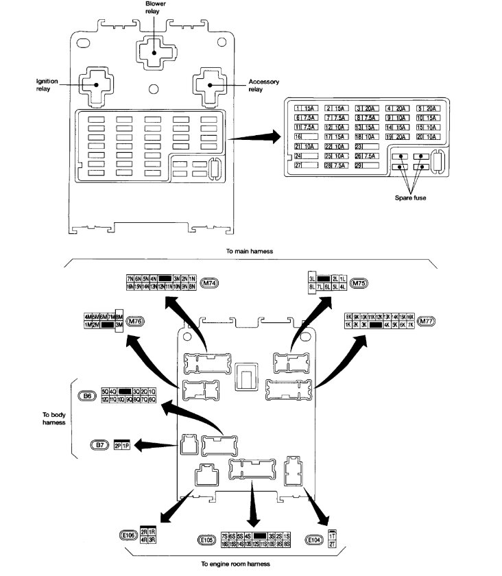

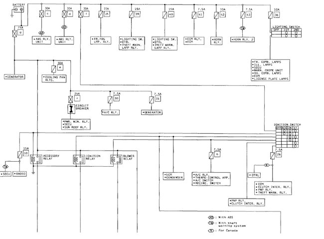

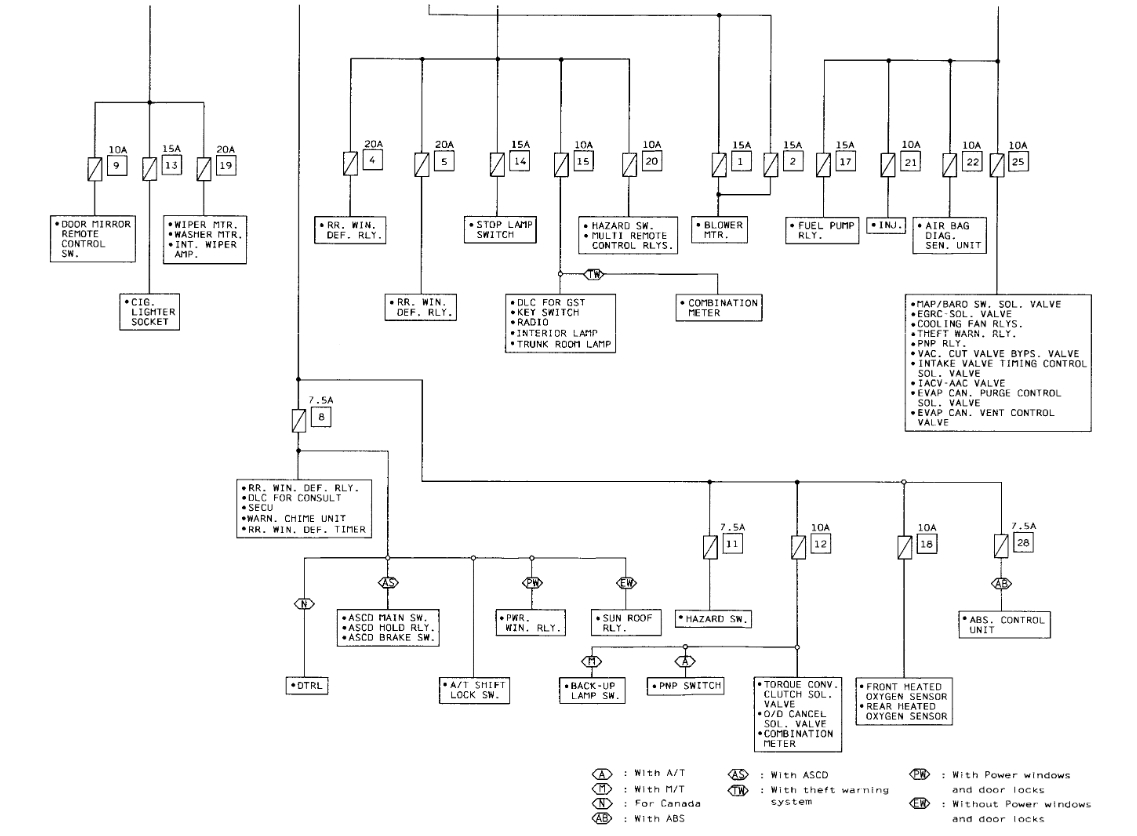

When they popped the main fuse, it could have taken out the PCM or other fuses. Let's use this guide to help check the remaining fuse and to see if they have power with the ignition on:
Here are the fuse locations to help. Check out the images (below). Please let us know how it goes.
