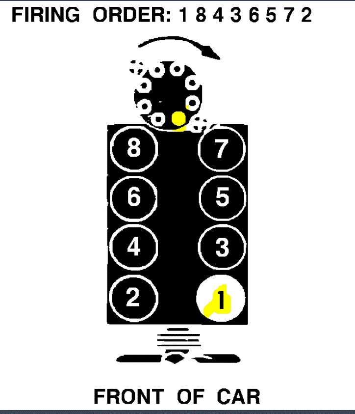

Did a tune up and installed new wires, new fuel filter, new cap, and rotor, new spark plug wires. The plugs are not new but there only year old the truck has a TBI carburetor. first, I misplaced two wires, but I think I fixed it. now runs but smells horrible. no leaks any were.

Let me know which wires you are referring to. If it's the spark plug wires, I attached a pic below showing the order they should be in. Check that if you feel it's needed.
Let me know what you find or if you have questions.
See pic below.

You're just amazing your help just helped me so much, everything worked out. I did the code with a paper clip o2 sensor it says but I replayed it then I replaced the ignition coil and then I replaced the distributor module runs great. thanks so much for your help ,it sure came in handy my friend.
