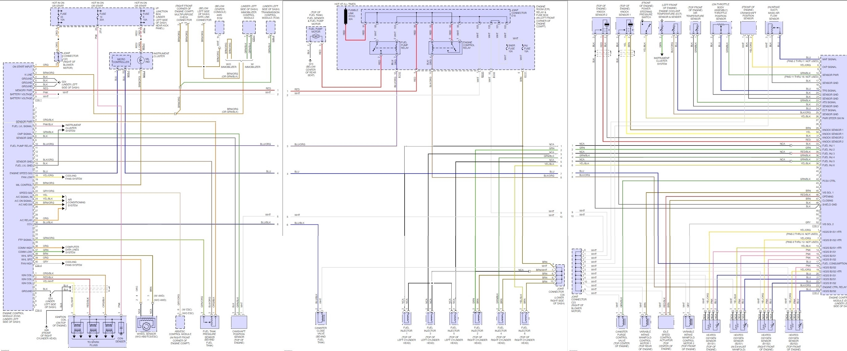

Vehicle listed above is the GLS model. December twentieth park car after work next morning get up go in car turn key nothing at all. boost it do some driving 1 hour more before turning off get back in 10 minutes dead again. boost again go home turn off dead again. charge battery turn key nothing dead again. changed to a new battery then crank crank never start or even close to start. never started since then. at that point i thought maybe no gas to fuel rail/spark plug frozen line top tank in gas plus some defreezer nothing. still crank no start.
After that this is what I did:
#1 i check fuse wires ground visually everything looks good test light on main and all the fuse i thought was important.
#2 check for gas at plugs 1 3 5 all wet so i got gas cool.

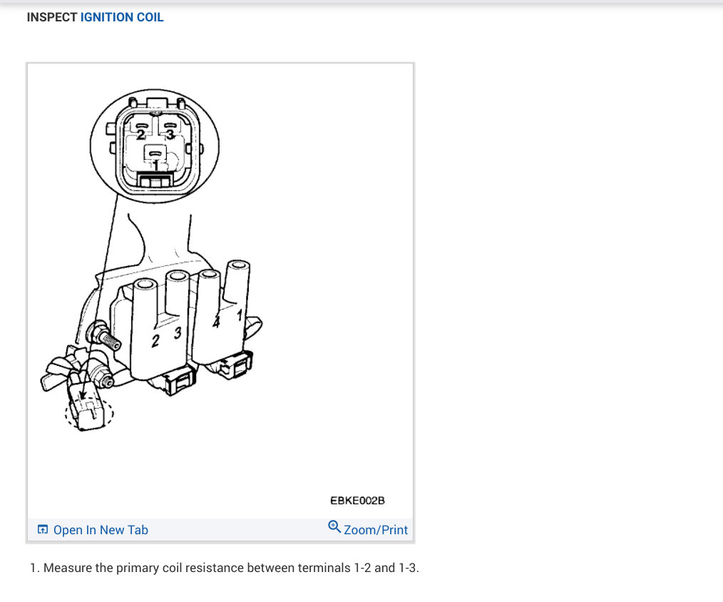

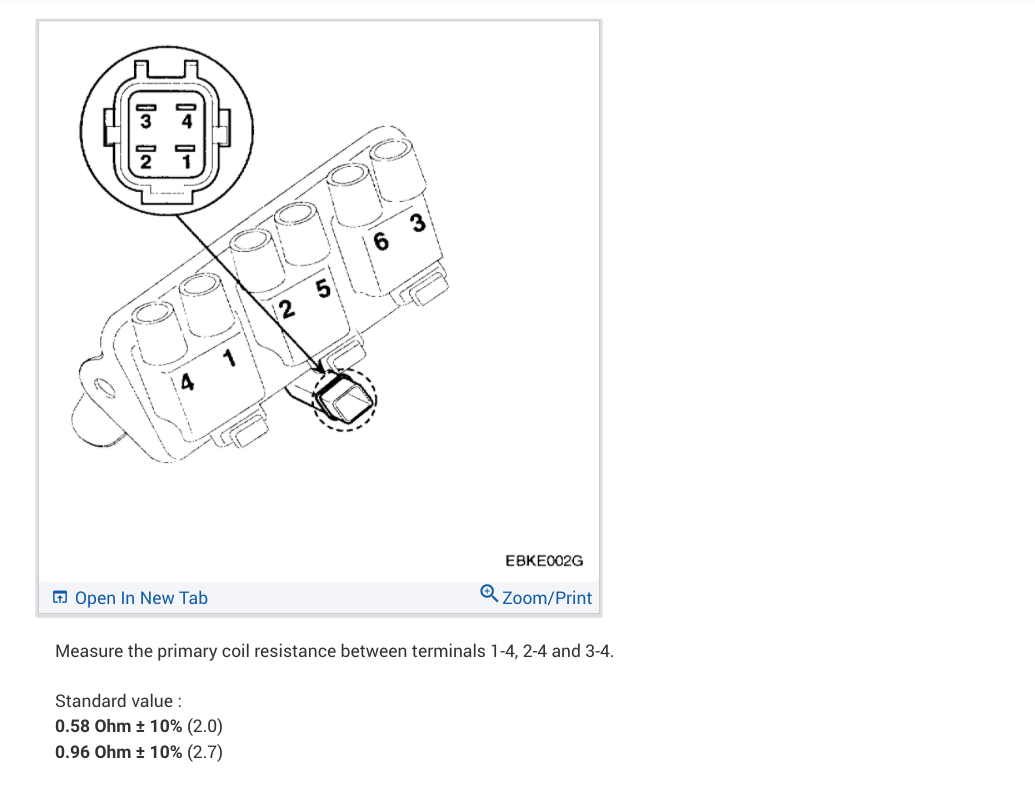

#3 check fire at spark plug nothing i got fire till the ignition coil pack connector nothing after.

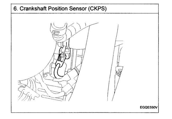

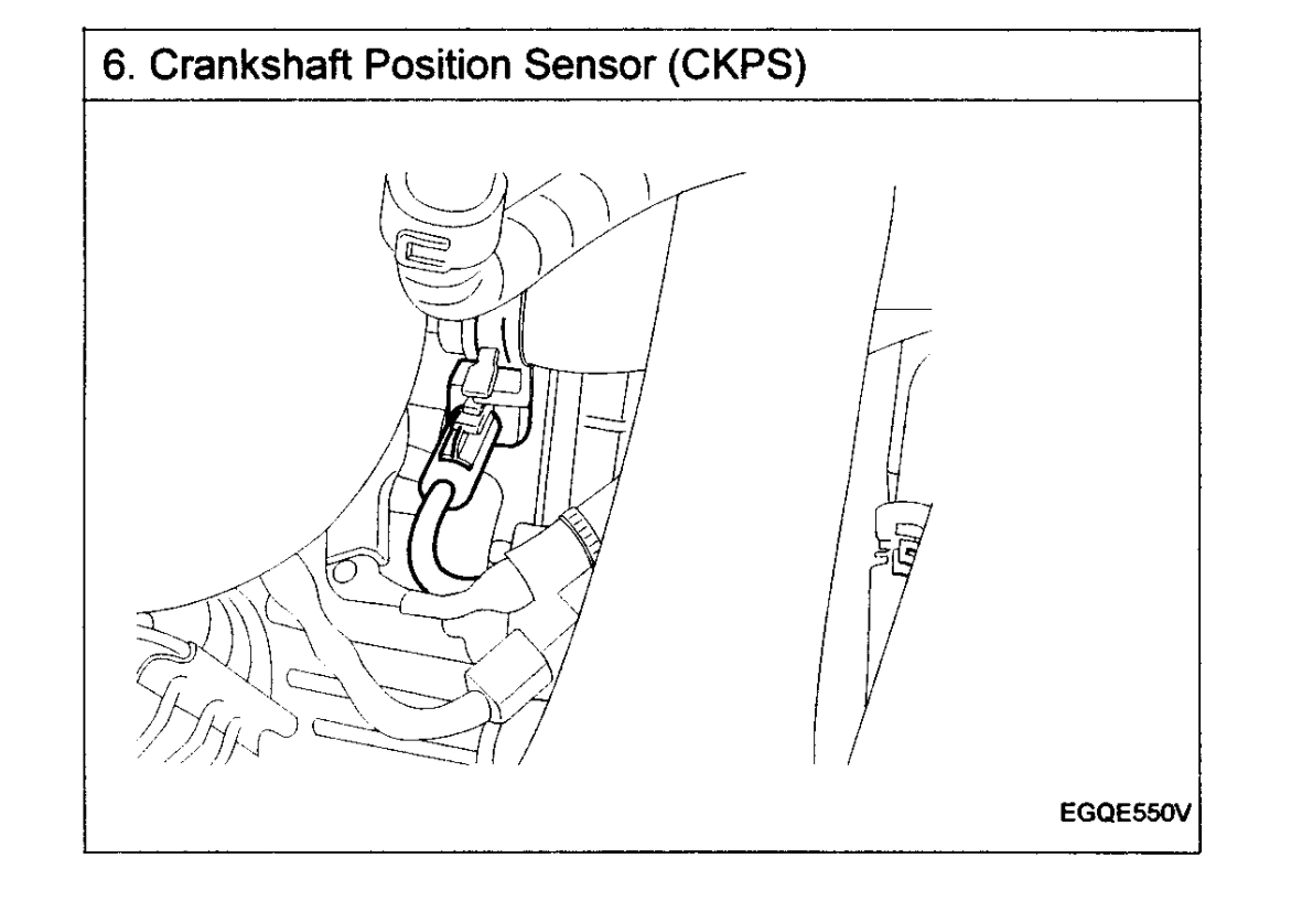

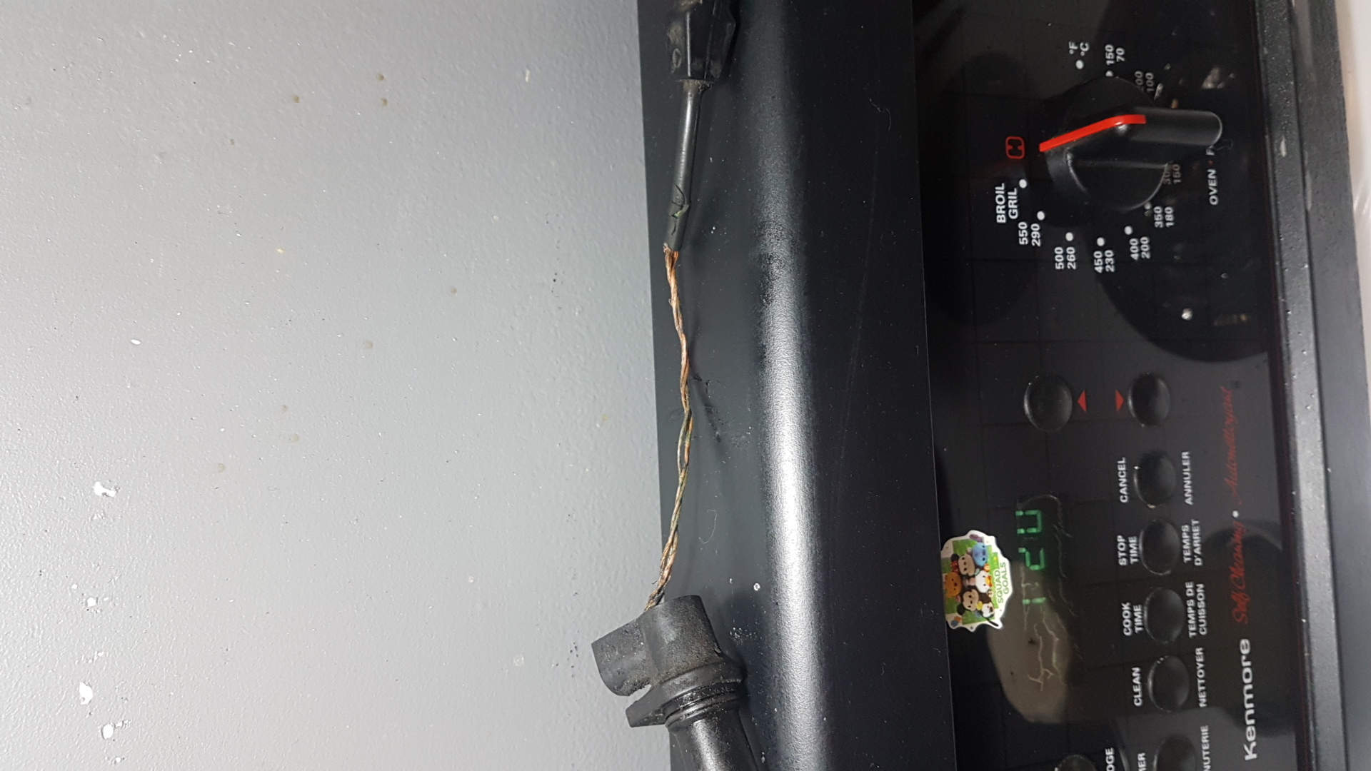

#4 look at crank shaft sensor position all i see is this pic 1 change to a new one from the top at night cell phone light minus 20 Canadian Celsius what an awkward place it was. still not the problem crank still no luck.
#5 changed coil pack not the problem at that point still no power past the new coil pack plug.
#6 change camshaft position sensor nope still need to throw part at it.

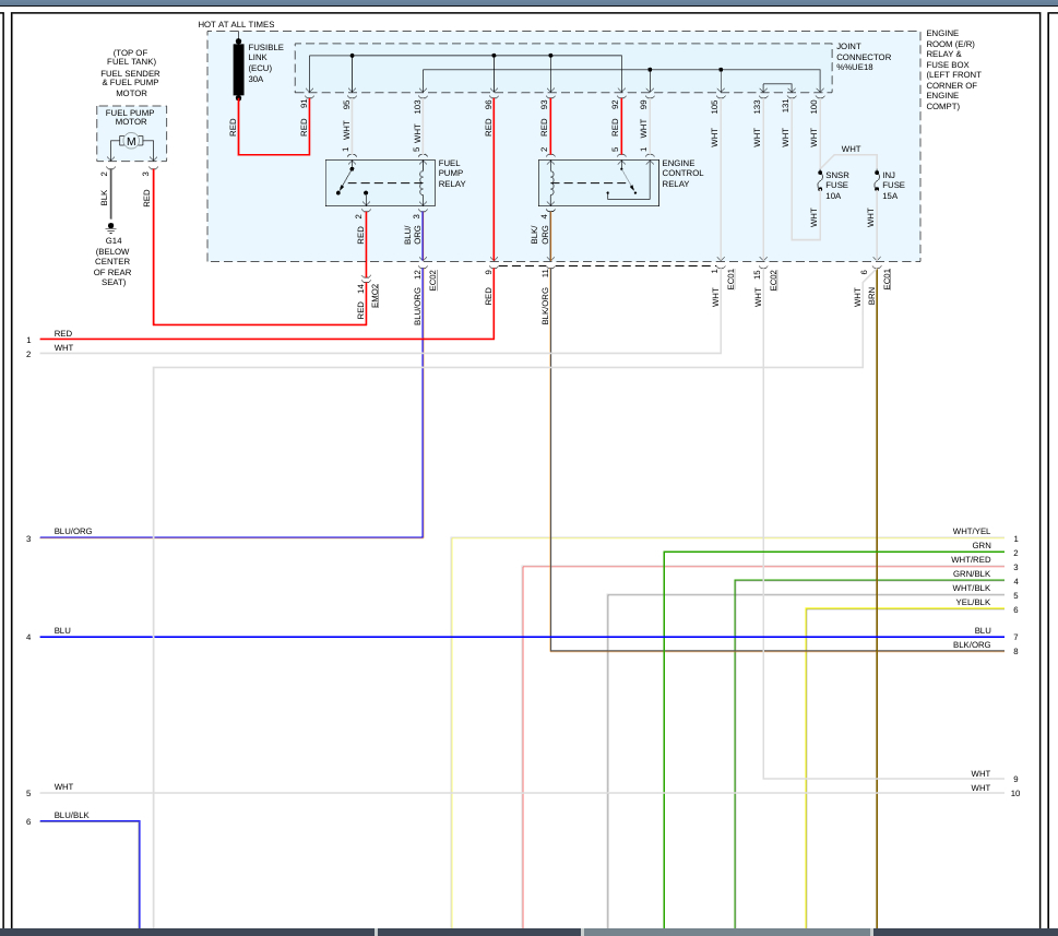

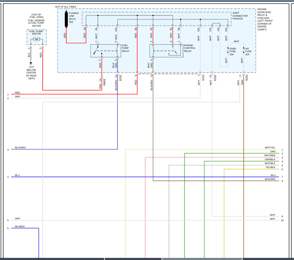

#7 open bottom of main fuses and relay box will provide more picture tonight phone was dead. yesterday some green corrosion starting to look for connection pack giving me false positive from top. i am not all done with this part, but yeah i got that diagram going to buy a Innova 3100 CanOBD2® Diagnostic Scan Tool/Code Reader with ABS. link: https://www.canadiantire.ca/en/pdp/innova-3100-canobd2-diagnostic-scan-tool-code-readerwith-abs-0251030p.0251030.html

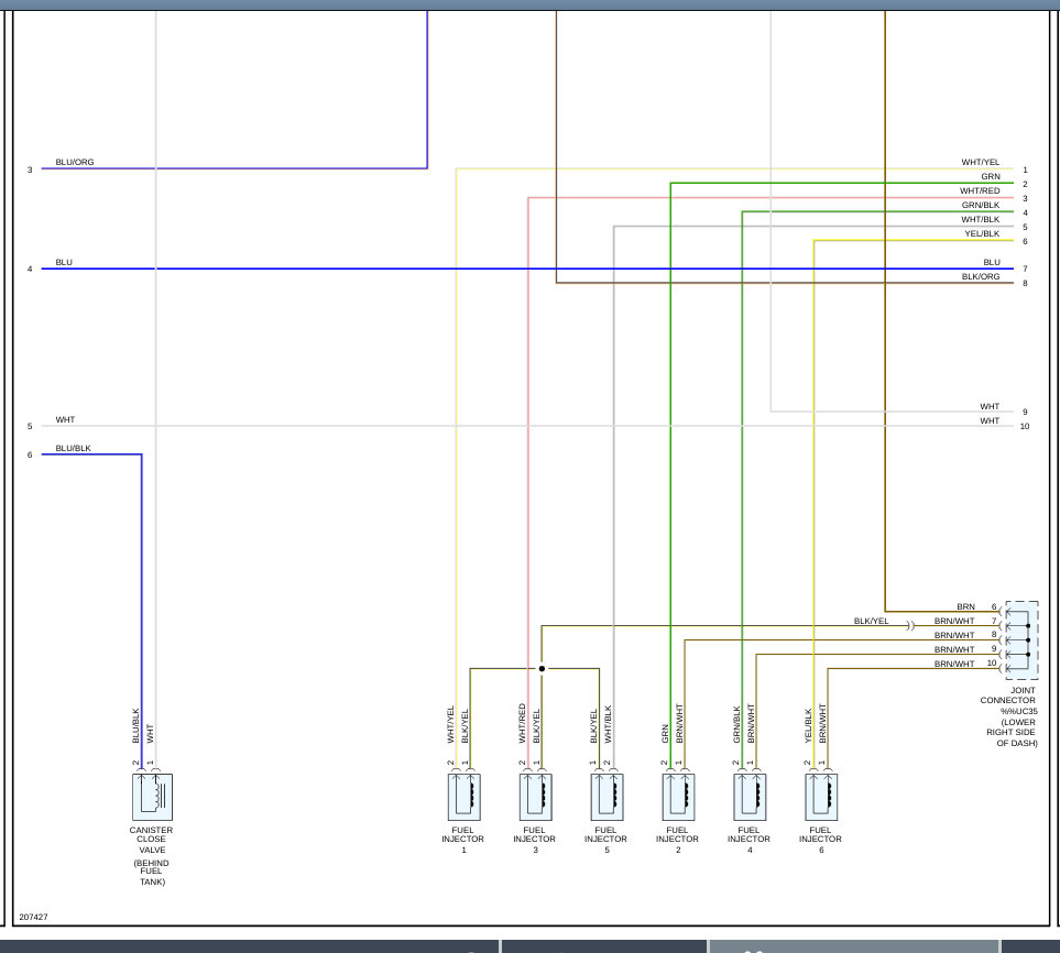

Got this all ready pic 3 it connects good but since battery died lost check engines codes and now it connects to ECM but no codes guessing since not stating.
so now here i am my next step is buying a oscilloscope and check for sensor signal to ECM and voltage. i also found the Factory Workshop Manual for Hyundai Tucson v6 2.7l 2005 12,000 pages it does cover most Hyundai that used that motor through the years so here i am at a lost. I need help!

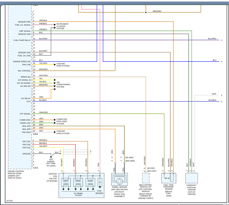

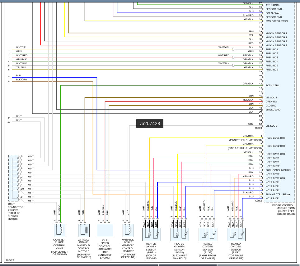

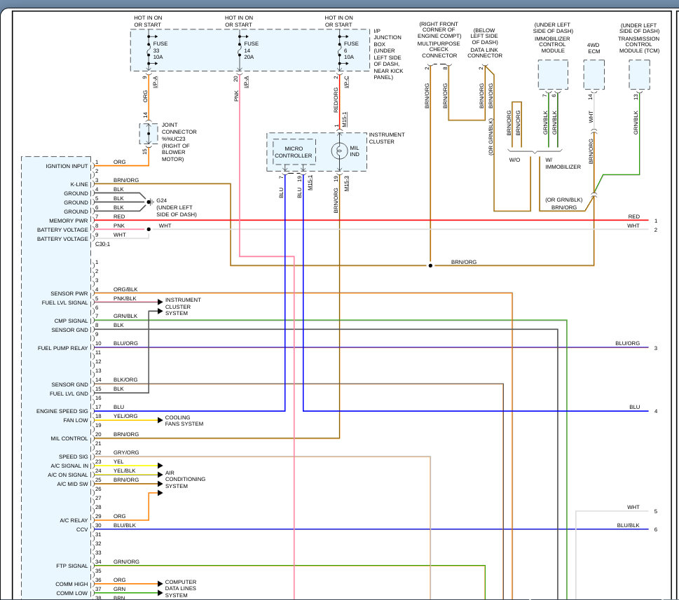

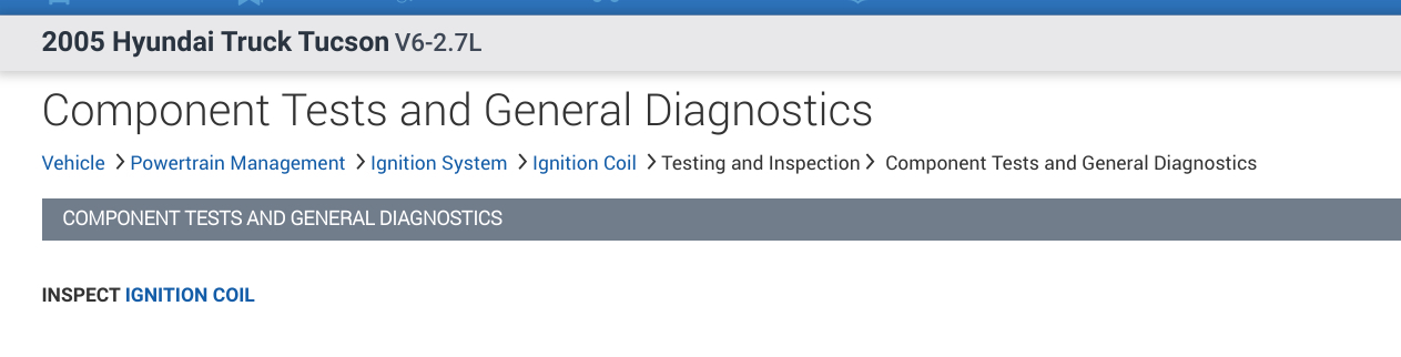

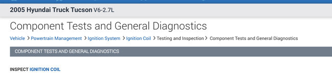

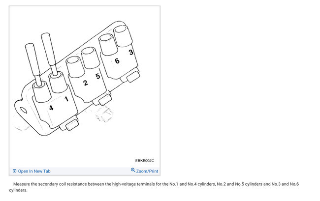

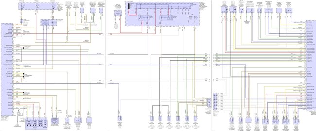

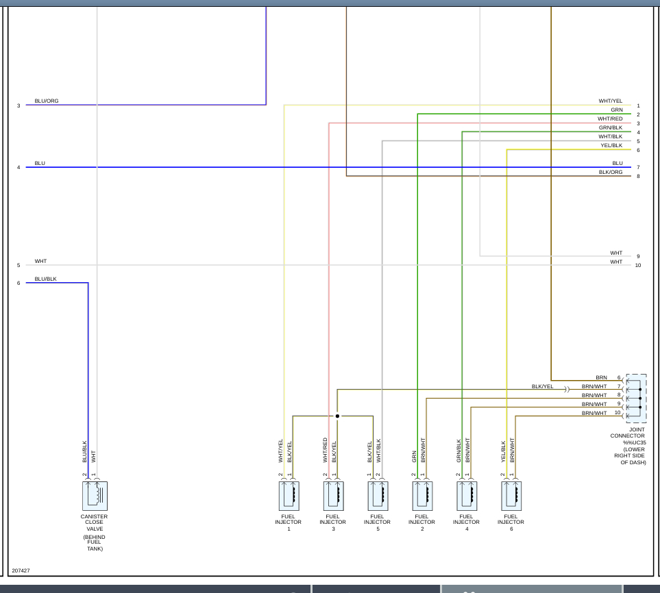

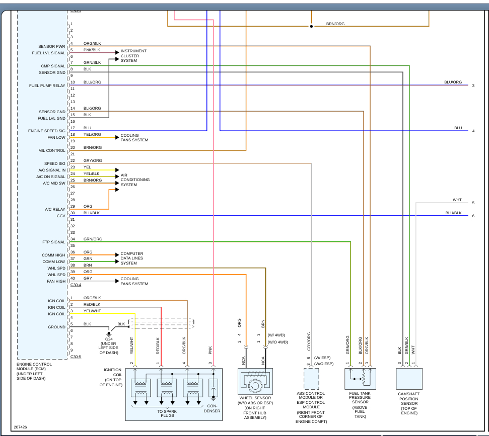

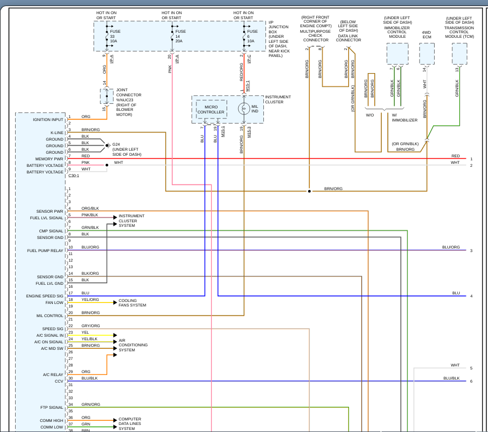

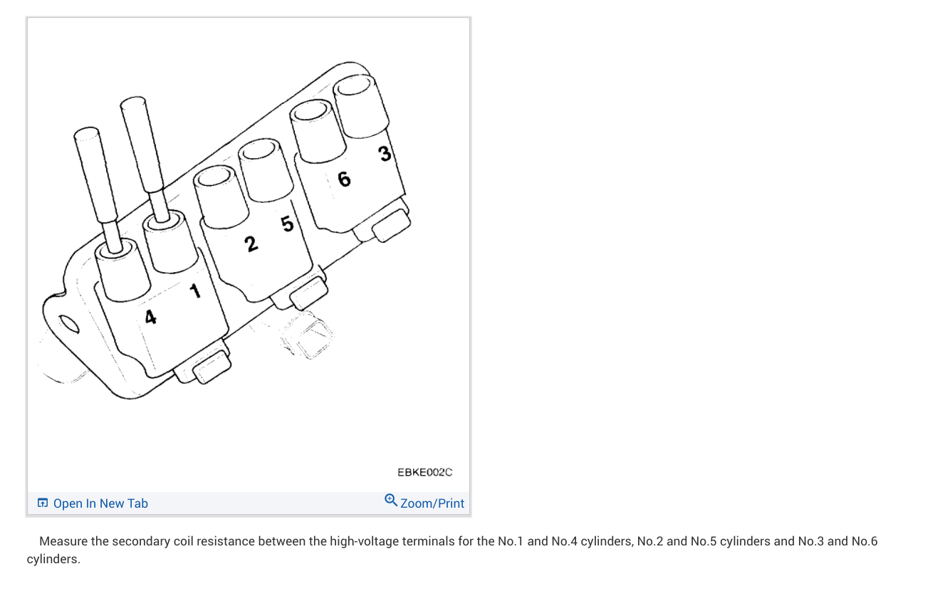

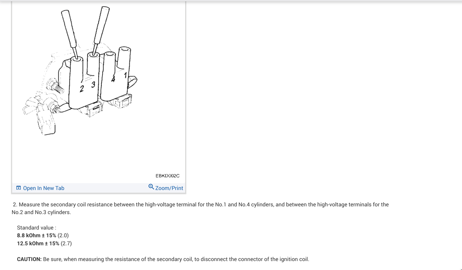

In the diagrams down below I have included the instructions on how to test the ignition coils of your vehicle. I have also included the power-train management wiring diagrams for your vehicle with the ignition coil circuits on them. The way that the ignition coils work is the get fused power from fuse 14[20A] of the Instrument Panel[I/P] fuse box. The paired cylinder ignition coils then receive there signal from the ECU by the way of providing and then taking away the ground from the ignition coils. So you should have battery voltage at pin 3 of the ignition coil electrical connector. Here is a guide below explaining how to check for spark:
I would also recommend changing the Crankshaft Position Sensor as well, after looking at the picture that you sent. Please go through these guides and get back to us with how everything turns out.

Update: after changing ECU I now have fire and fuel in injectors, but still crank with no start.
Thursday, January 16th, 2020 AT 6:49 PM
SCGRANTURISMO
  • 4,897 POSTS
Hello again,

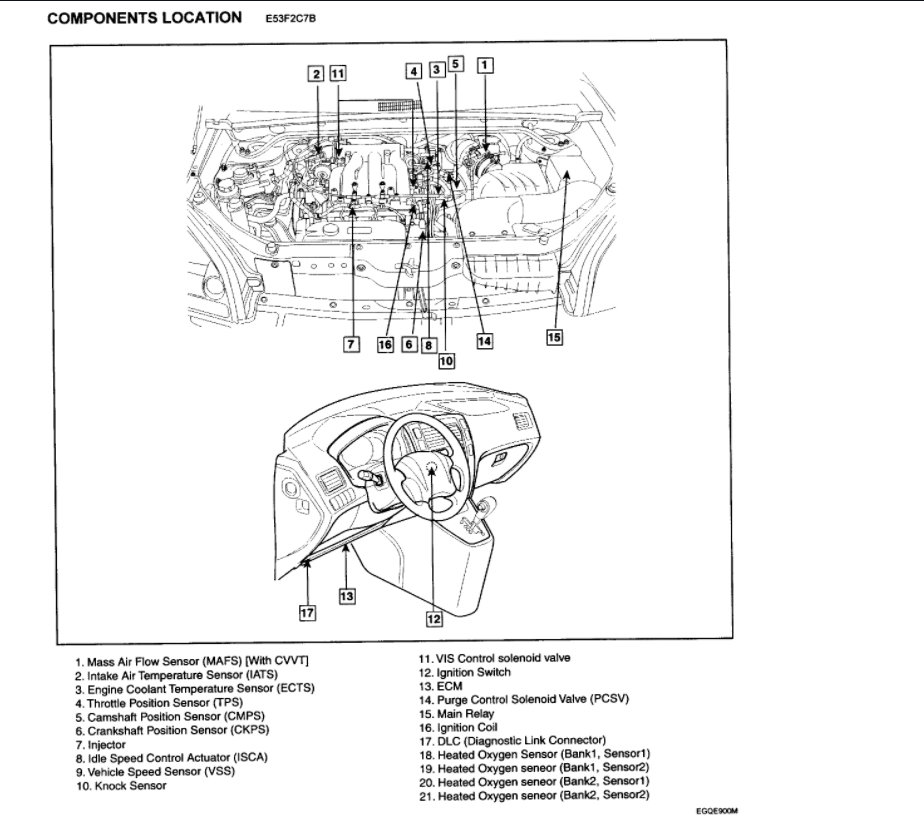

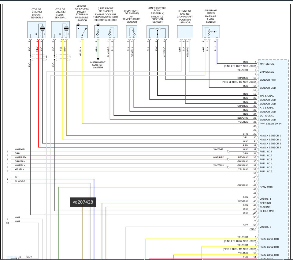

I would recommend installing a new Crankshaft Position Sensor[CKP] and inspecting the CKP electrical connector and the wires to make sure everything is okay. Without the signal from the CKP the ECU will not start or run your vehicle. In the diagrams that I sent previously you can find the CKP circuit on the top of the second to the last diagram. I have also included in the diagrams down below diagrams showing the location of the CKP on your vehicle. Please go through these diagrams, replace the CKP, inspect the CKP electrical connector for problems and get back to us with what you ind out and how everything turns out.
