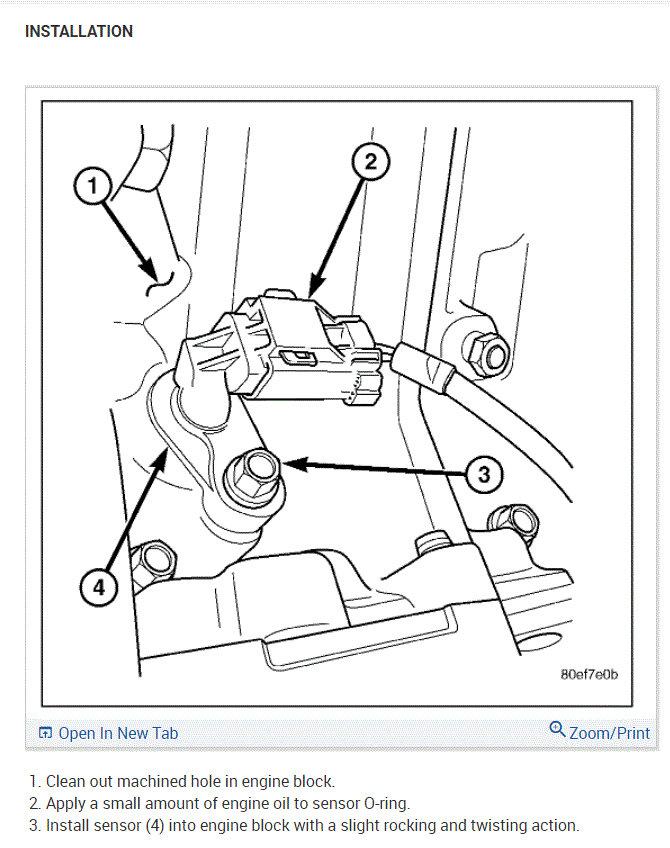

When it stalls, does it start right back up? I'm asking because a failing crankshaft position sensor can cause this to happen. Oftentimes, they are affected by heat. When they get hot enough, they fail. Most times, they need to cool for a bit before the car will restart. Interestingly, it may or may not set a check engine light.
Do me a favor. Read through this link and let me know if it seems to mirror what you experience.
If it had a delayed start after it stalls, check to see if there is spark to the plugs. If there isn't, chances are it is the crankshaft position sensor.

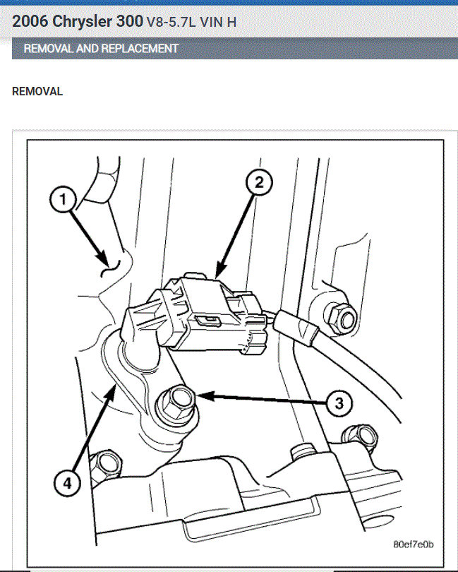

If you determine it is bad, here is a link that shows in general how one is replaced:
The attachments below are the directions and pics specific to your vehicle for replacing the sensor. Note: The Crankshaft Position (CKP) sensor is located at the right-rear side of the engine cylinder block.
Let me know if this helps. Also, let me know if the check engine light is staying on when the engine is running.
