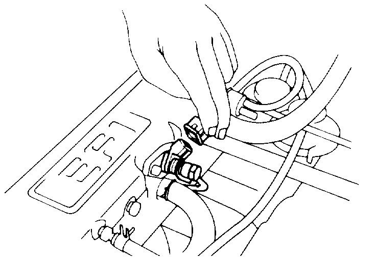

(c)Disconnect the wiring connector from the cold start injector.
(d)Put a suitable container or shop towel under rear end of the delivery pipe.

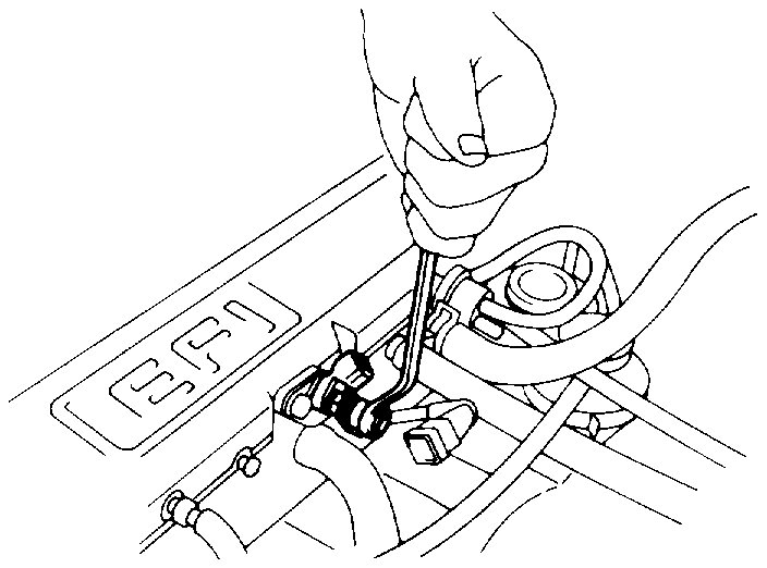

(e)Slowly loosen the union bolt of the cold start injector hose and remove the bolt and two gaskets from the delivery pipe.
(f)Drain the fuel from the delivery pipe

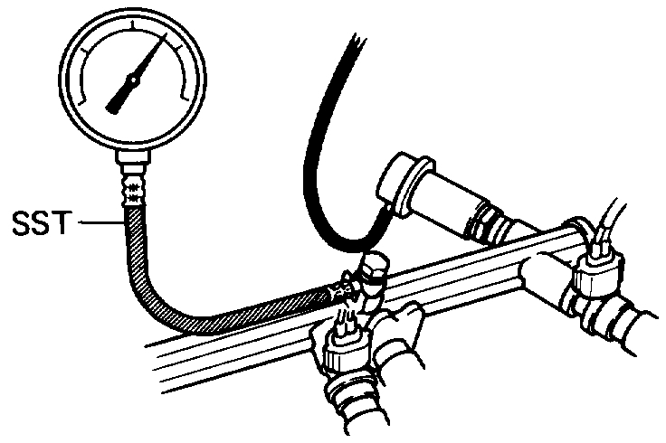

(g)Install a gasket, SST, another gasket and union bolt to the delivery pipe as shown in the figure.
ST 09268-45012
(h)Wipe off any splattered gasoline.
(i)Reconnect the battery cable.

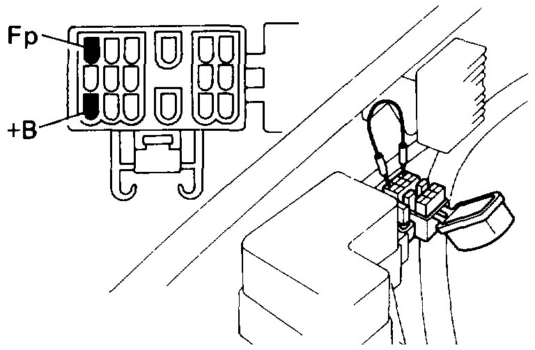

(j)Short terminals Fp and +B of the check connector with a wire.
(k)Turn on the ignition switch.
(l)Measure the fuel pressure.
Fuel pressure:
22R-E 2.7 - 3.1 kg/cm2 (38 - 44 psi, 265-3O4 kPa)
22R-TE 2.3 - 2.7 kg/cm2 (33 - 38 psi, 226 - 265 kPa)

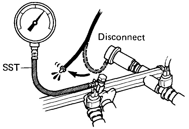

(o)Disconnect the vacuum sensing hose from the pressure regulator and plug it off.
(p)Measure the fuel pressure at idling.
Fuel Pressure:
22R-E 2.7 - 3.1 kg/cm2 (38 - 44 psi, 265 - 304 kPa)

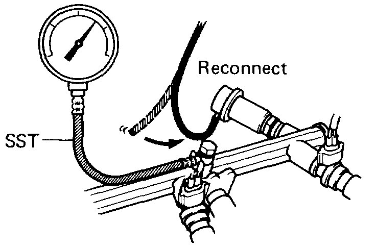

(q)Reconnect the vacuum sensing hose to the pressure regulator.
(r)Measure the fuel pressure at idling.
Fuel pressure:
22R-E 2.3 - 2.6 kg/cm2 (33 - 37 psi, 226 - 265 kPa)
22R-TE 1.9 - 2.2 kg/cm2 (27 - 31 psi, 186 - 216 kPa)
If no pressure, check the vacuum sensing hose and pressure regulator.
