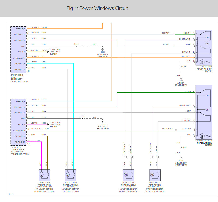

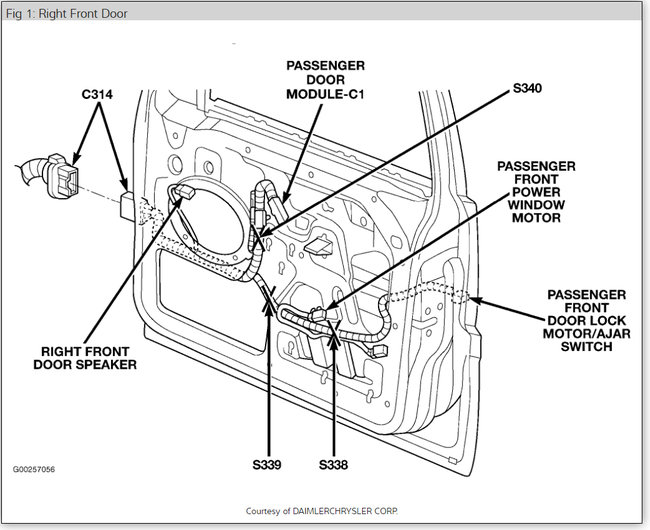

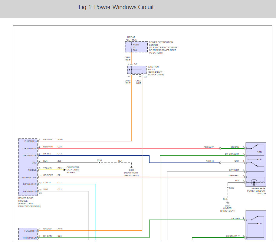

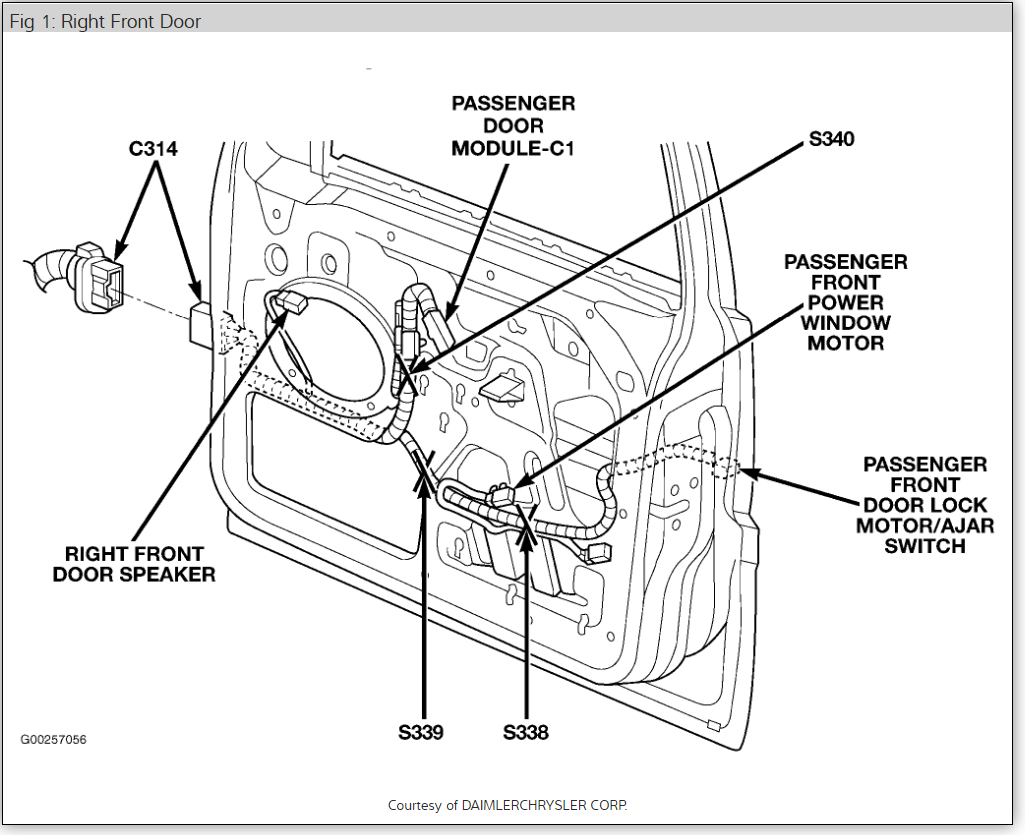

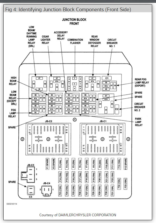

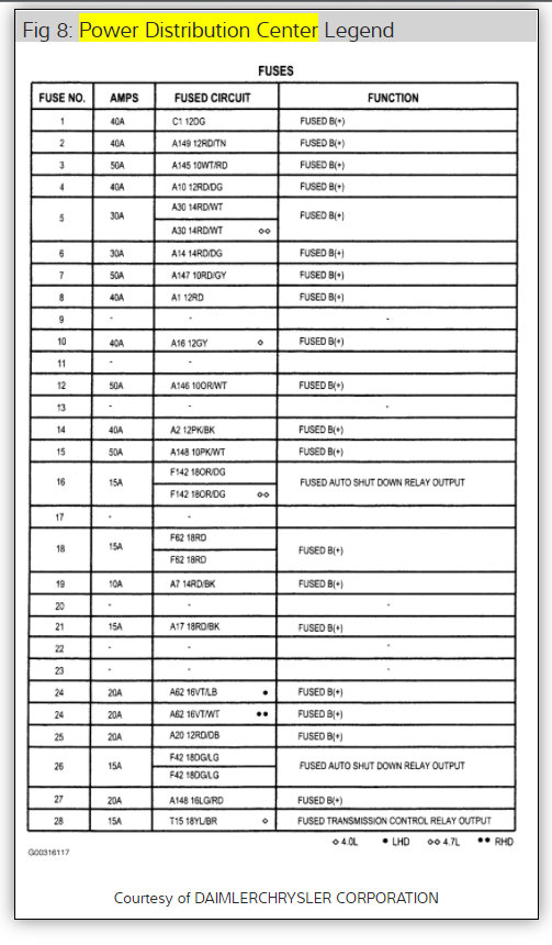

Key fob, passenger front and back window stopped working
2004 JEEP GRAND CHEROKEE
181,345 MILES • 4.7L • V8 • 4WD • AUTOMATIC
CHAD FLEMING
I changed batteries. The dome lights are staying on also. What do you think?
Sep 16, 2018 at 10:05 AM
  • 55,224 POSTS

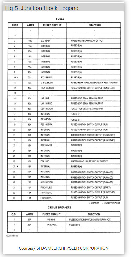

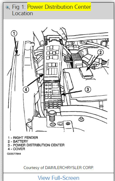

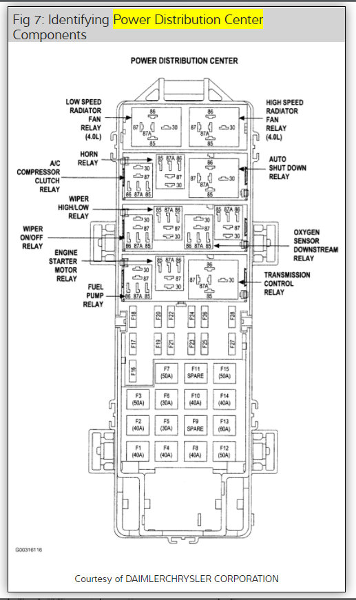

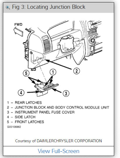

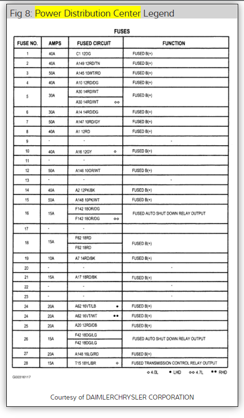

There is a fuse #12 that needs to be checked and if okay the drivers door module sounds like it is out. Here is the window wiring diagrams so you can see how the system works and the fuse and door module location with a guide to help you test the fuse:
