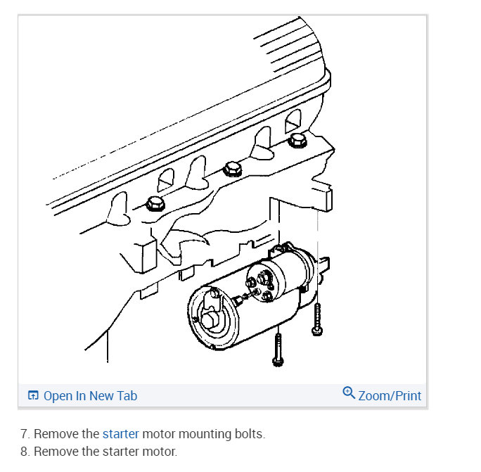

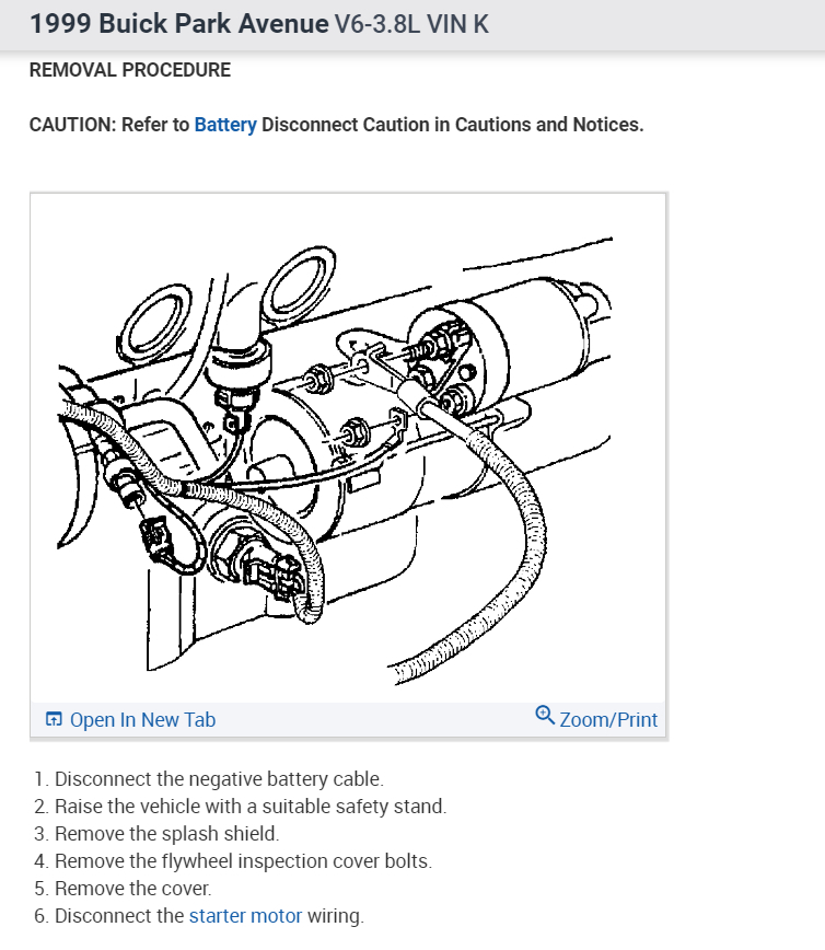

It started and drove perfectly, until late last night/early this morning (7-4-22). I drove it to work just fine, and I also drove it once while at work with no issues. Then after getting off and trying to go home maybe 20-30 minutes after I last started and drove it. I go to start it and nothing. All my electrical and dash lights and everything work fine. But when I try to crank it, nothing happens. Doesn't even crank or anything. Please help me figure this out.
Jul 4, 2022 at 8:57 AM
  • 55,433 POSTS

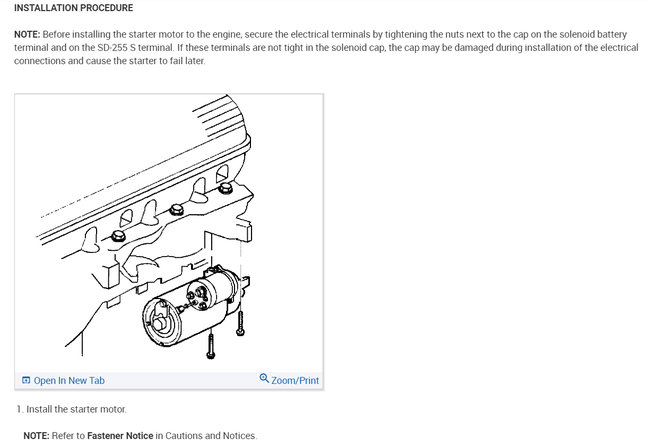

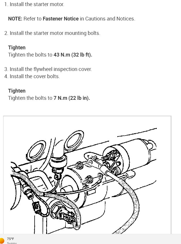

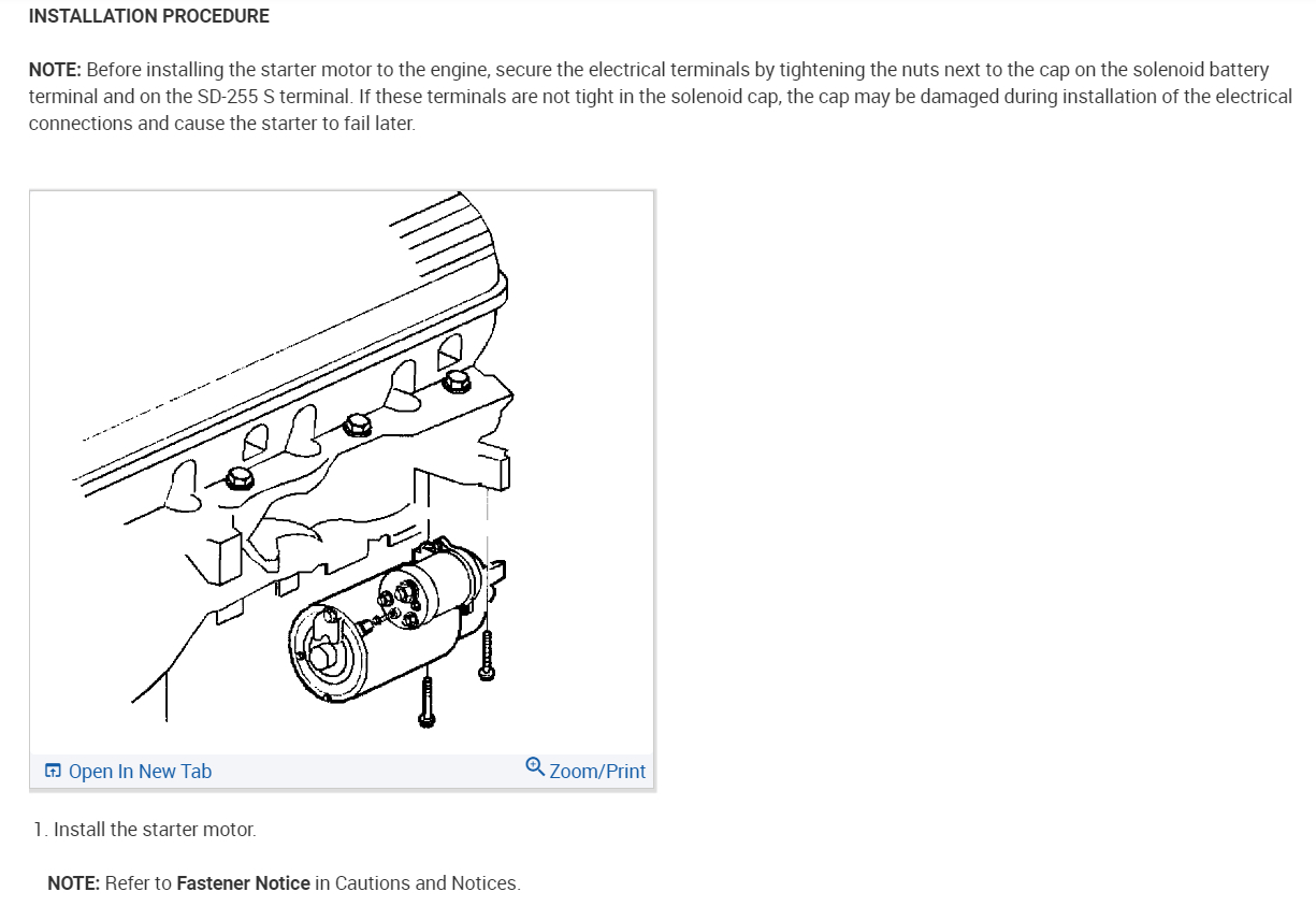

It sounds like the starter motor went bad. To be sure we need to use a test light and hold it on the trigger wire on the starter solenoid, then have a helper turn the ignition key to crank and see if the test light illuminates. If so, the starter is bad and needs replacement. This guide can help, and I have included how to change the starter out in the diagrams below:
