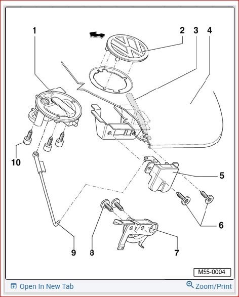

Side panel and key are not working to release trunk. I cannot find the release inside the car to try that. Please help. thank you.

This sounds like to me that the latch itself is either broken or frozen. So when you turn the key or use the release the rods (#9 and #4 in the attached diagram) that are connected to the lever (#5) on the latch, do not actually release the latch.
If it is frozen, then the key will feel very hard to turn. Pressing down on the liftgate over top of the latch to relieve some pressure may allow the latch to release. Once it is off, you need to either replace it or lubricate it with a spray lubricant so that it loosens. You can operate it with the key while spraying it and it should loosen up.
If the latch is broken the key will feel very easy to turn, in this case there is no easy way to open it. You may have to remove the interior panels to gain access to the latch to release it manually. This is not easy with the lift-gate closed. I am not suggesting this but some people end up cutting a hole in their panel in order to gain access and then replace the panel. I have never had to do that, but have seen it done.
Let me know how the lock cylinder feels when turning it and hopefully it is just frozen and the trick above works. If it does not, we can come up with something else.

This model VW Beetle 2002 doesn't have a trunk key. rear open only remote and side door open. sorry I should have said that.

Okay. No problem. The diagram just lied to me. :)
The principal is still the same. Press down on the bottom of the lift gate where the latch is and press the remote button. If it is frozen then this will relieve the pressure and hopefully it will pop open.
When you press the button on the key, do you hear anything click or attempting to move inside the lift gate?
If not, here is a video of how to remove the panel and manually trip the latch. Then he tests the remote. It sounds like yours is doing the same thing. If so, he also shows how to replace the latch but pay attention to the end of it where he says that the control module did not operate it because it thought the latch was already open. This is why when he plugged in the test light it did not light it.
