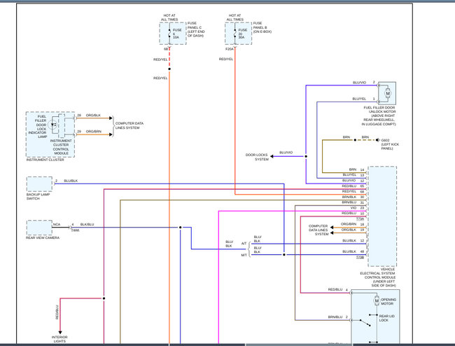

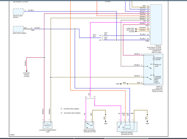

I have replaced the bulb and that didn't help. Also on the dash it doesn't show the trunk lid is open.
Dec 23, 2019 at 12:22 PM
SCGRANTURISMO
✓ASE Certified Mechanic
4,897 POSTS

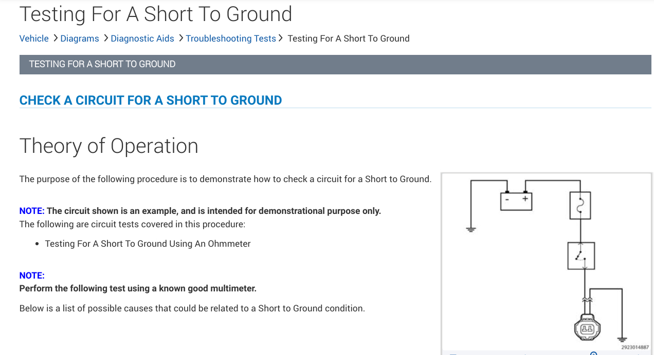

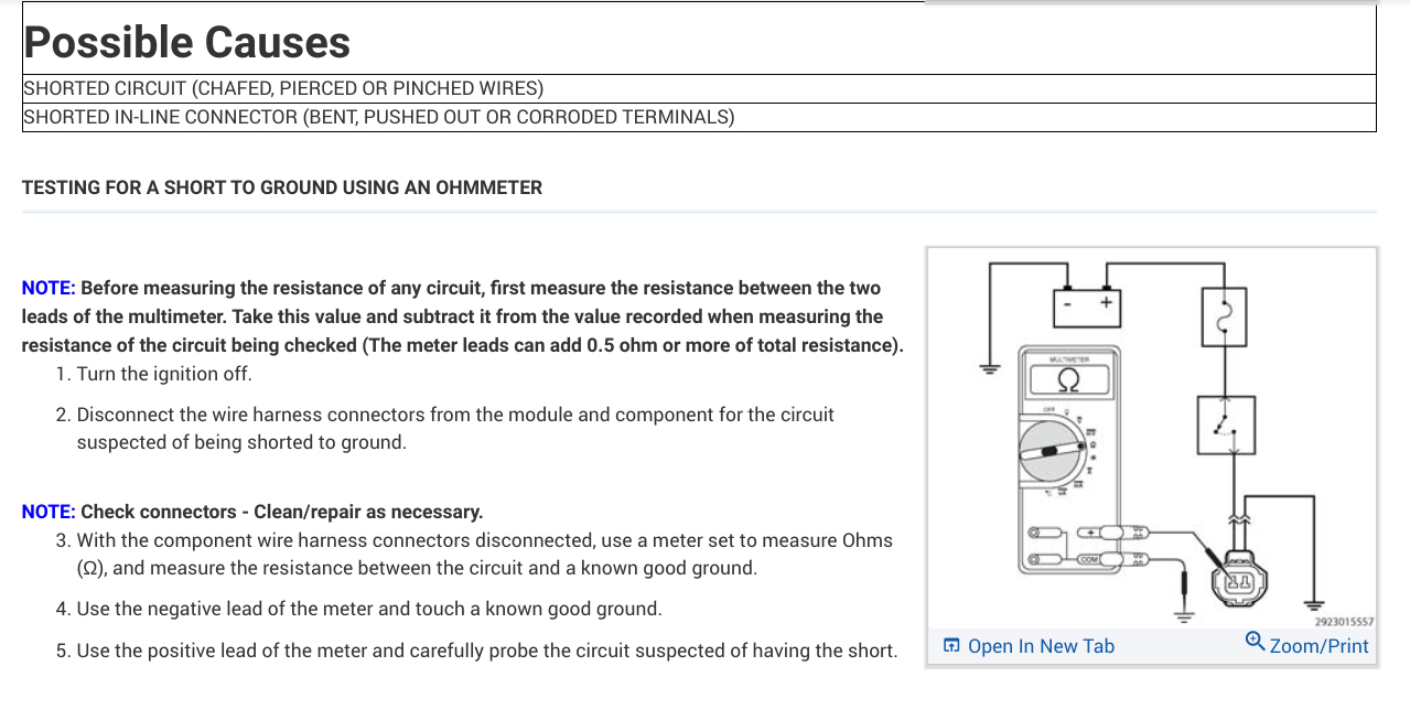

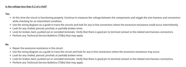

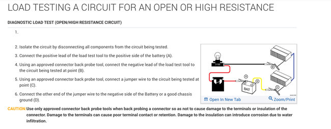

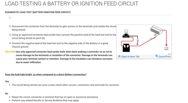

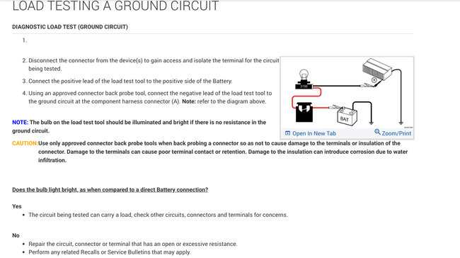

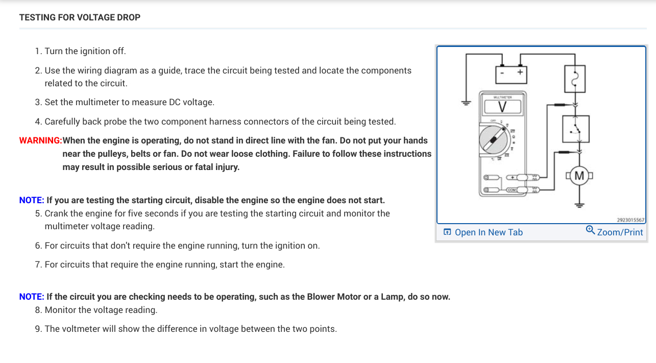

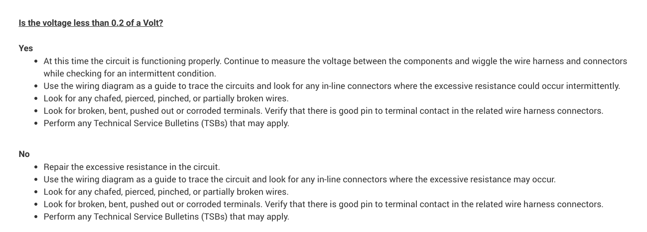

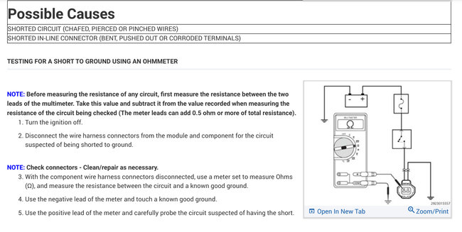

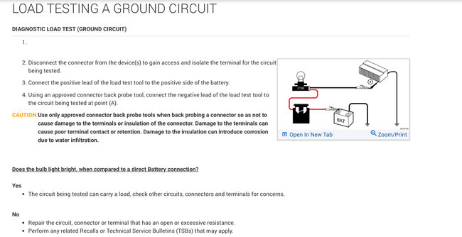

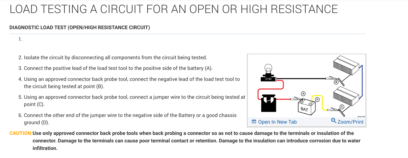

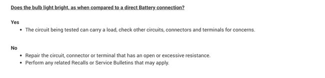

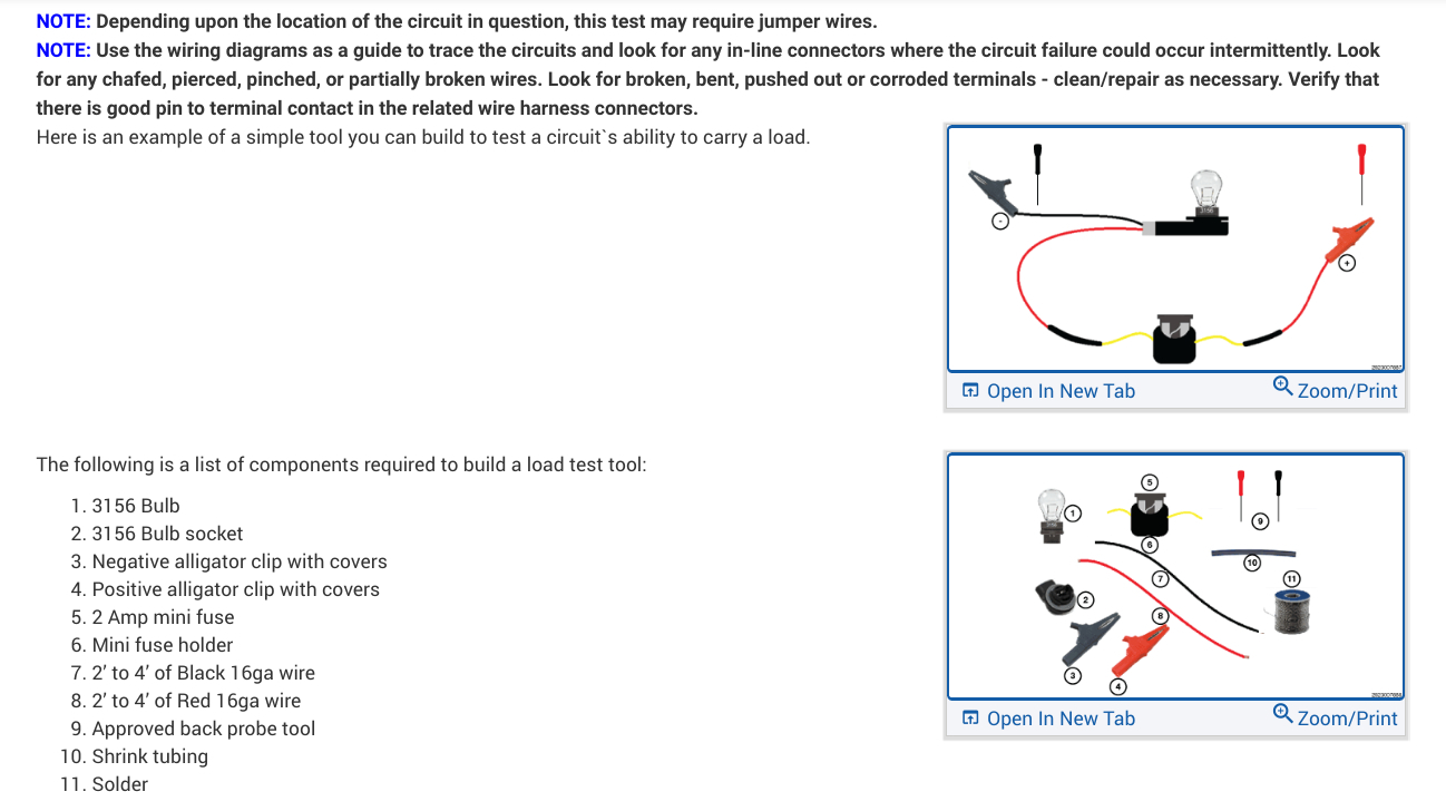

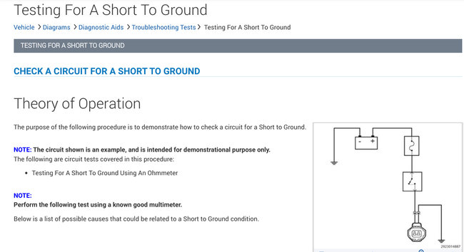

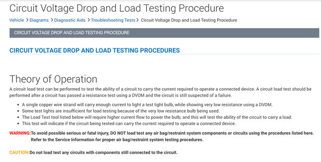

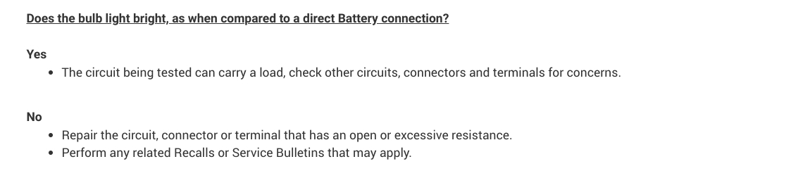

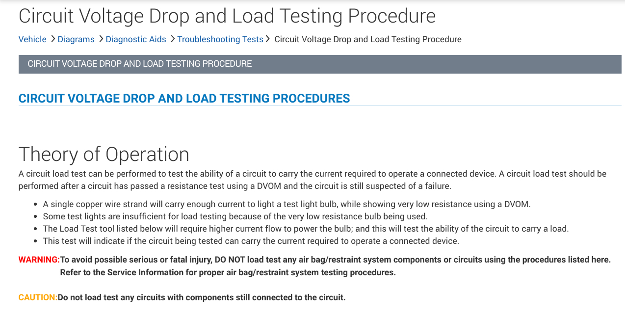

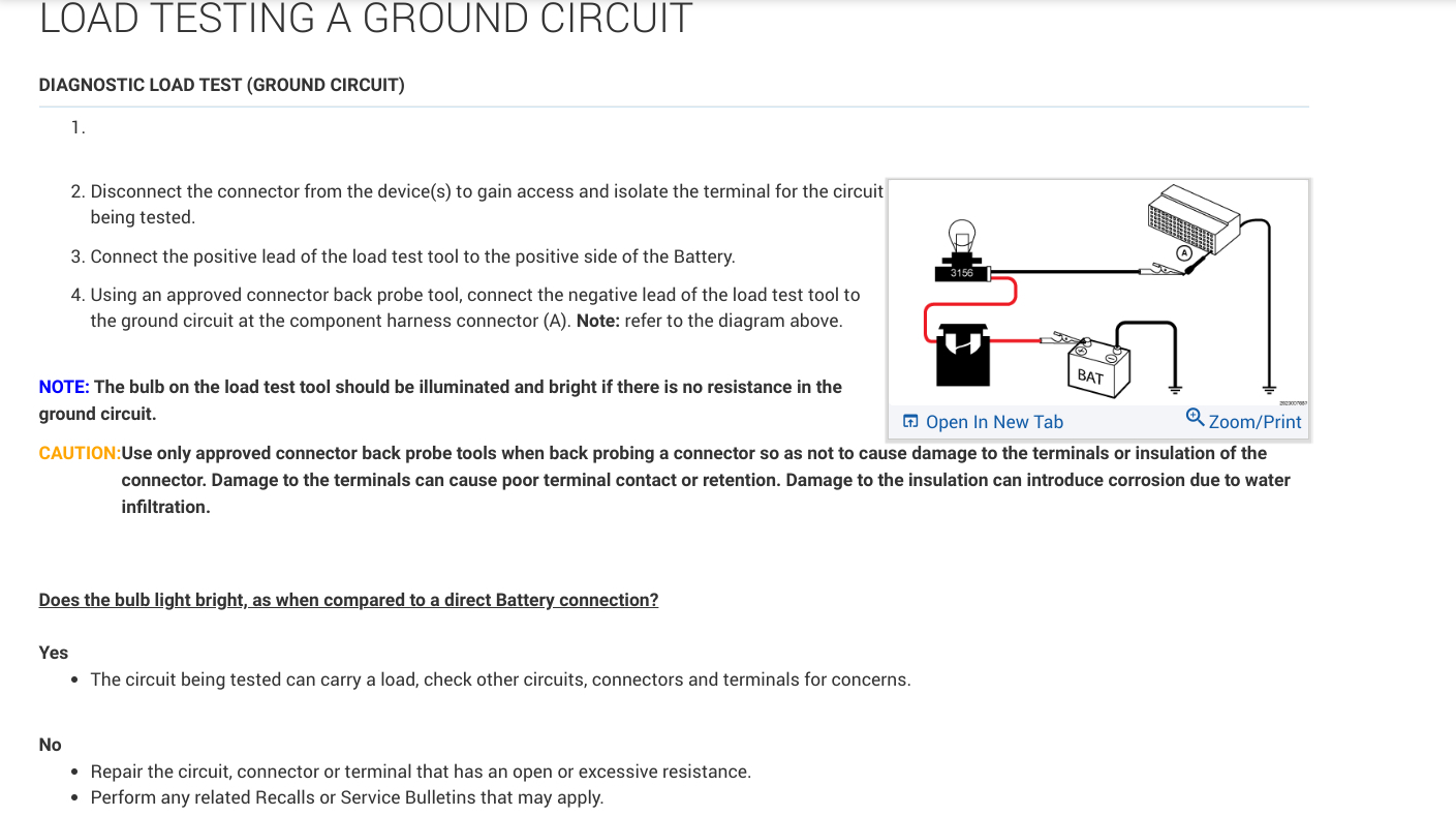

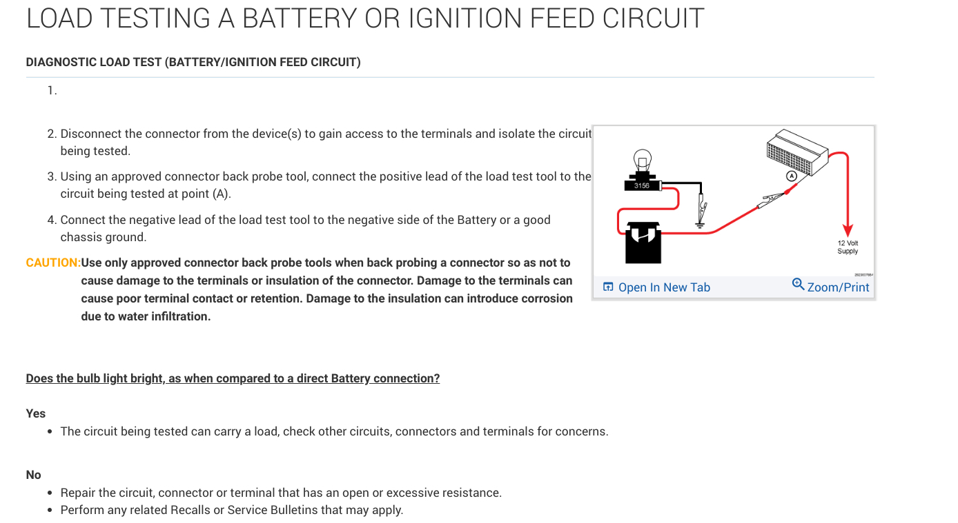

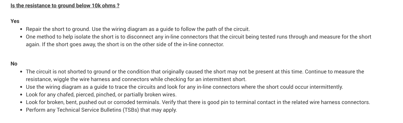

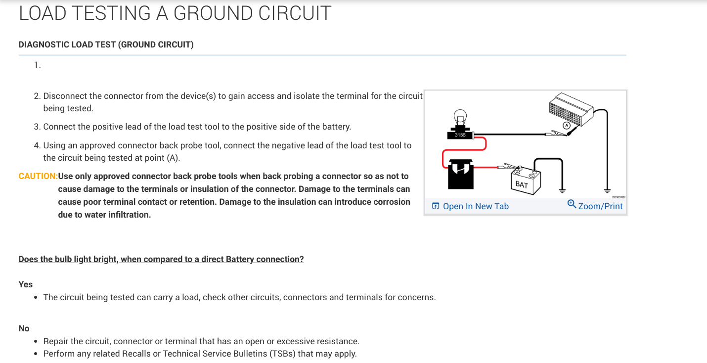

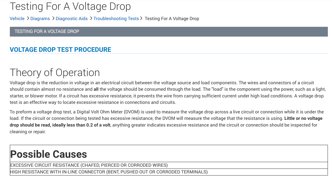

There could be a couple of different things going on here. Either your vehicle's electrical system control module has failed or you have an open or unwanted resistance somewhere in the wires in the trunk light circuit. In the diagrams down below I have included the wiring diagram for the trunk light circuit and guides on how to find an open and unwanted resistance in an automotive electrical circuit using voltage drop for you. You will need to use a Digital Multi-meter [DMM] to use these guides and here is a link below explaining how to use one:
