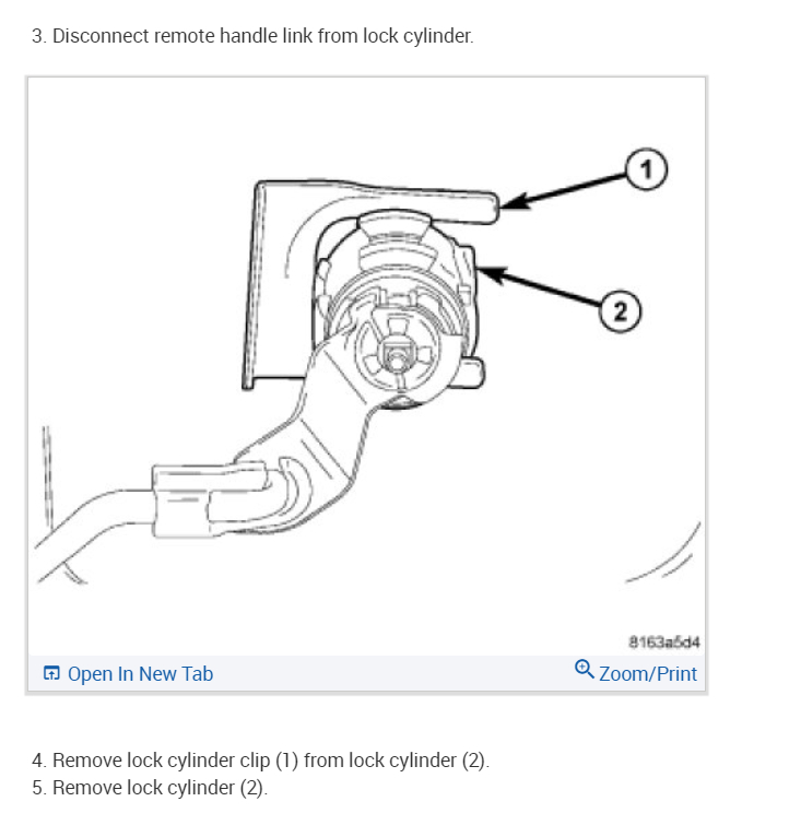

The key has a button I push and the trunk unlocks. But when I stick key in trunk lock manually. It doesn’t turn or unlock.
Apr 18, 2020 at 11:04 AM
  • 55,224 POSTS

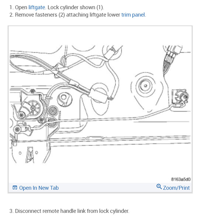

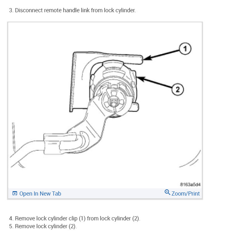

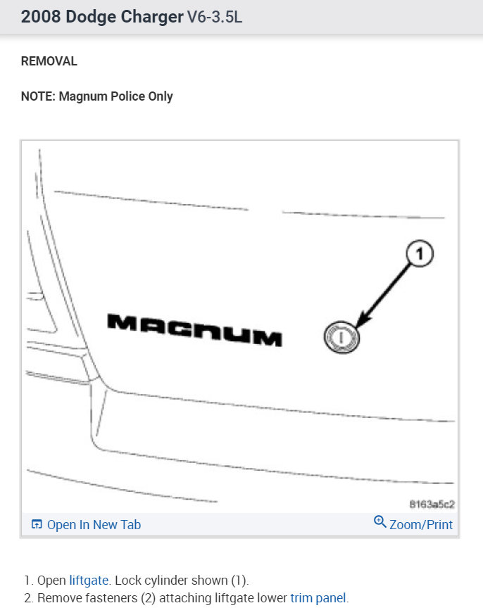

It sounds like the trunk lock needs to be re-keyed are replaced. here is how you can remove the lock cylinder in the diagrams below. Check out the diagrams (below). Please let us know what happens.

Can I just buy the lock cylinder or do I have to buy the whole thing? I can’t find a lock cylinder online to fit it.
Apr 18, 2020 at 1:23 PM

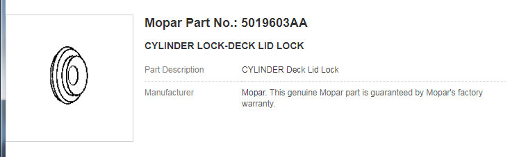

Here is the Mopar part number for the lock cylinder: 5019603AA
Let us know if you need more info. Thanks

When I look the part number up it comes up for Chrysler Sebring?
Apr 19, 2020 at 11:31 AM

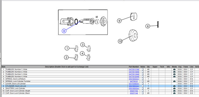

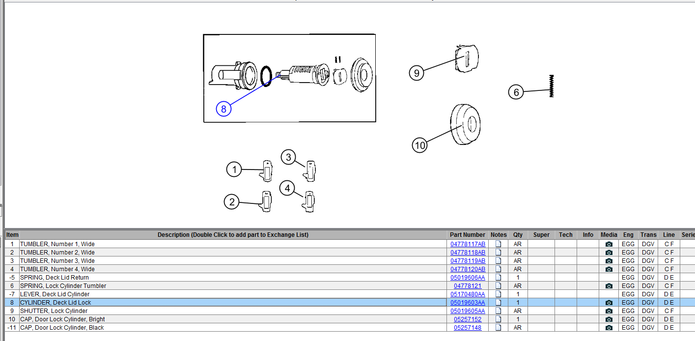

It is a standard lock cylinder. Here is a screen shot right out of the Mopar parts catalog for a 2008 Charger. It is number 8 on the picture.
Most all Chrysler products use the same lock cylinder.
