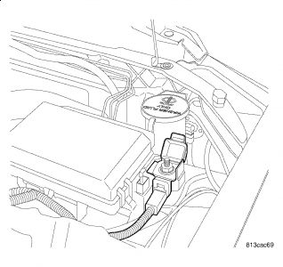

i dont have a steel key , no power on battery .
how to open the trunk ?

Under the hood, there is a jump start port, connect a battery charger or know good battery to it and when thecar powers up, use trunk release.
