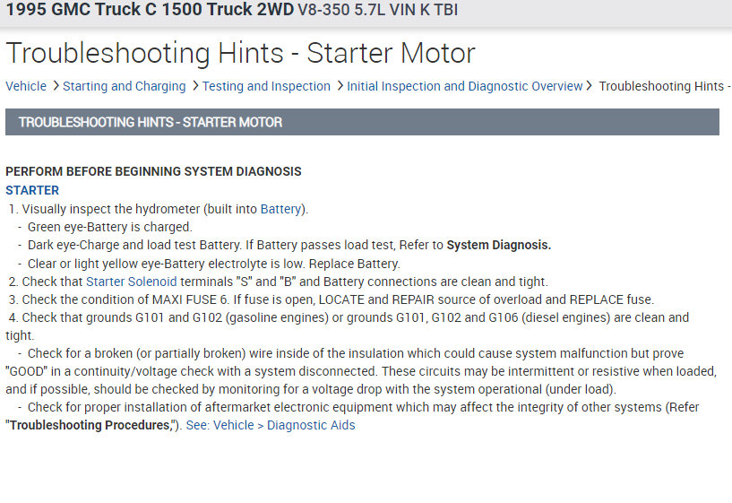

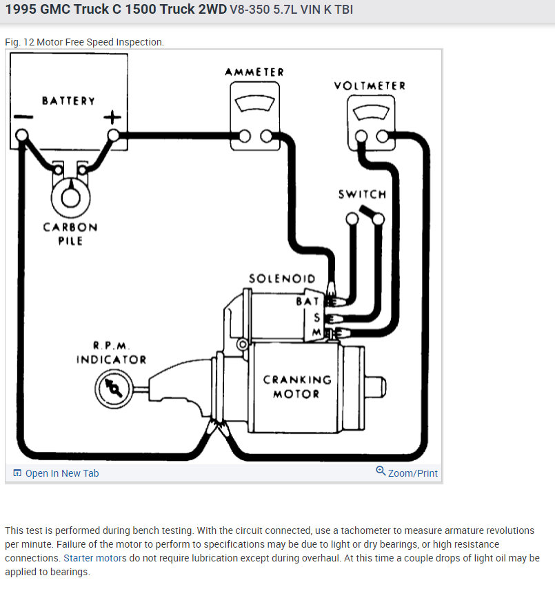

Vehicle has been running solid for years. Drive it yesterday and parked it just like I always do. Went to start it back up a little while later and it won’t turn over and makes a high pitched tone. Checked all the fuses and cleaned the terminals on my less than a year old battery. Still won’t start.

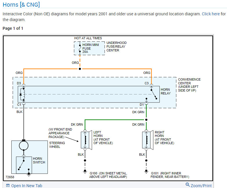

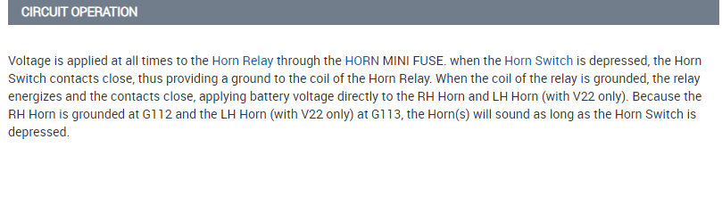

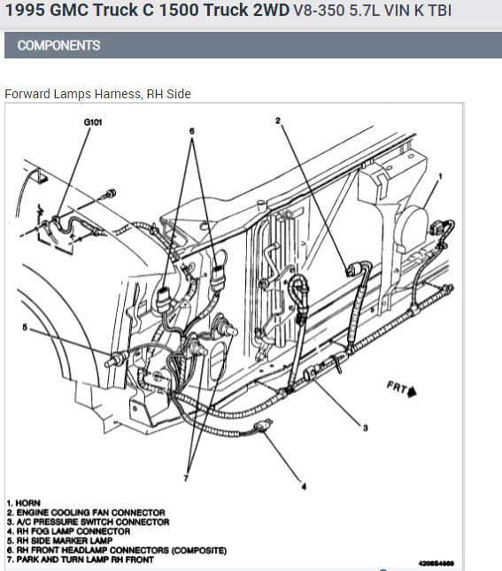

KCLAYTON

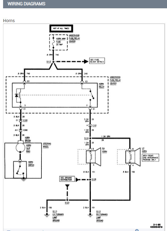

We’ve narrowed it down to a dead short. Still haven’t found it. Removed the horn relay and the horn fuse and the horn would still make noise. It’s back feeding through the ground somehow.
Jul 16, 2021 at 3:08 AM
SQM
  • 6,383 POSTS

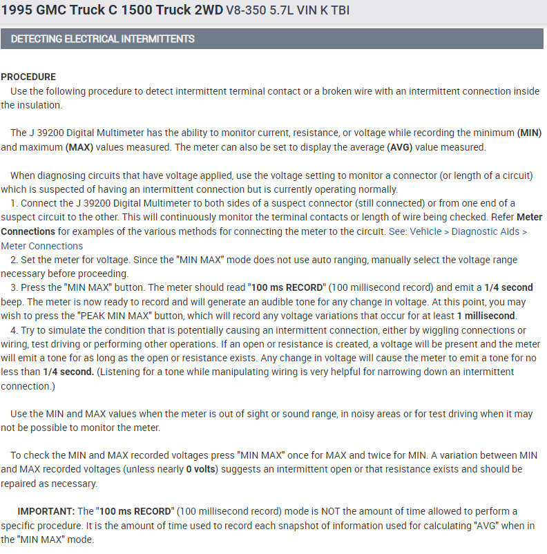

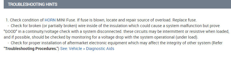

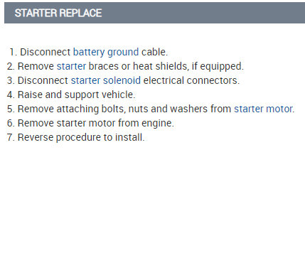

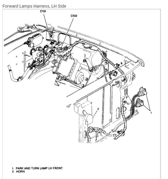

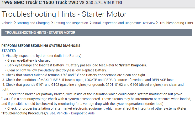

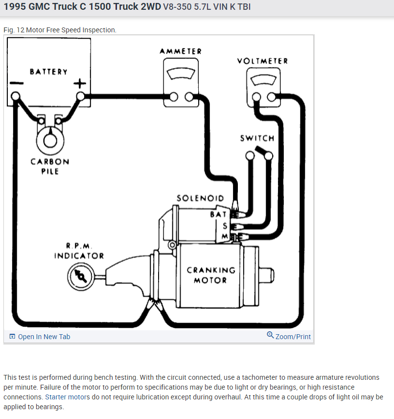

I have attached the wiring diagrams for the horn as well as few other diagnostics tips.
Any questions please let me know.
Thanks.
Jul 16, 2021 at 3:20 AM
KCLAYTON
The horn isn’t the problem. it’s a by product of the problem.
