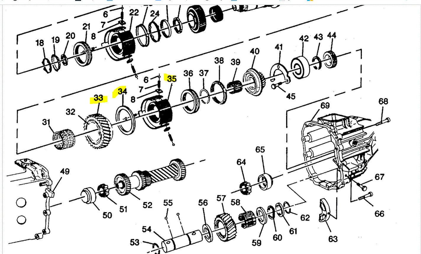

Have you checked the transmission fluid to make sure it is clean and full? The fifth gear and reverse work off the same hub assembly. Does it always grind going into reverse? Even if a synchronizer was bad, you shouldn't experience power loss.
If you look at the pic below, I highlighted the gear assembly #33, the retainer #34, and the synchronizer for reverse/fifth.
If you haven't already, inspect the fluid and make sure it's clean and full.

As far as the issue, there really isn't anything in the transmission that would cause a power loss in 5th gear only. What I suspect is happening is this. I have a feeling the clutch plate is worn and you only are noticing it in 5th gear simply because that is the gear that places the most load on it. Also, it could be the cause of the on and off grinding you get into reverse. IF you double-clutch it before shifting to reverse, see if it still grinds.
