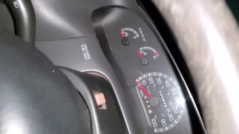

Truck will start up fine but seems to idle only on the driver side of the engine and will backfire and shut off if I touch the throttle. But if left rough idling it will sometimes surge up to maybe seven cylinders... This only started happening after a hard rev followed by a loud pop ever since the truck has done the above. It was bought as a Toy half of the exhaust is gone on passenger side due to rust.

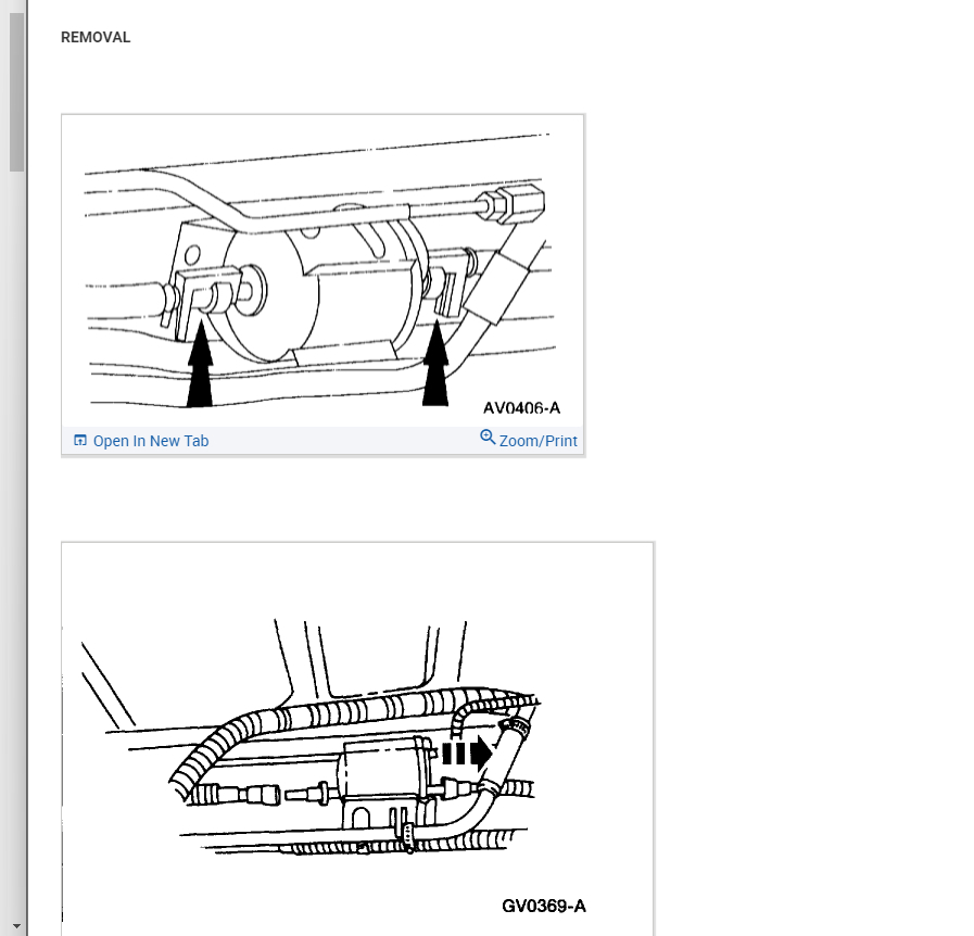

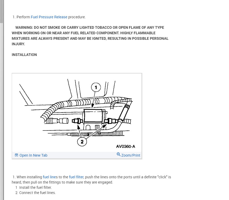

Let's start with the basics unless you have already changed a number of different parts.
However, if you have misfires then we need to start with checking the plugs, wires, and injectors.
However, the fact that you just got this truck, and the exhaust is in poor condition, I would suggest with just changing all your ignition components, fuel filter, air filter and then recheck the operation of the engine.
https://www.2carpros.com/articles/how-to-tune-up-a-car-engine
https://www.2carpros.com/articles/how-to-change-a-fuel-filter
If none of this checks out, we are going to need to move onto a possible vacuum leak. So here is a guide that will help with this:
Let's start with all this info and based on results we will have a better idea what the issue is but we will then need to check fuel pressure, but I don't think that is the issue which is why we need to start with all this.
Let us know what you find. Thanks

Great video. That helps a lot.
We need to jump straight to compression checking because I bet you have some bent valves that are no longer sealing, and you are going to be low on compression in more than one cylinder.
This engine has a timing chain so I doubt it jumped a tooth or slipped like a belt can. I think that the bang was pistons hitting valves and did some damage.
However, if the compression is ok then we can dig further but I bet that is going to tell us what is happening.
If I am correct, then unfortunately mudding may have claimed another engine.
Let us know what you find with this, and we can go from there. Thanks
