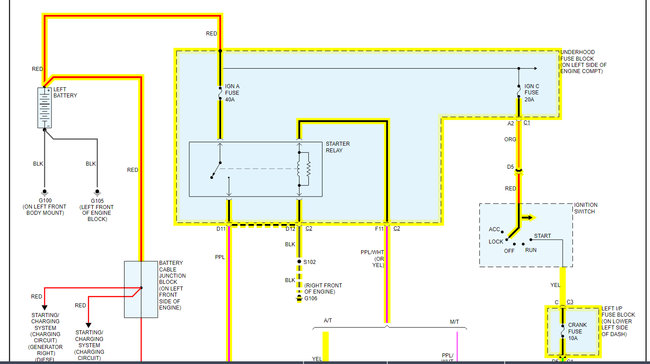

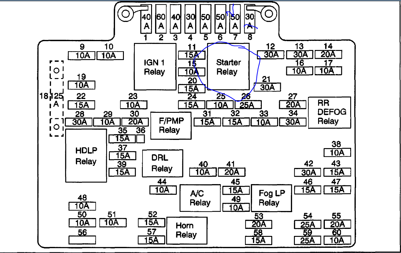

Silverado 2500HD Duramax. It will not turn over. Checked all the ignition fuses which are good. Pulled the Defrost 30A Relay and put it in both the ignition and starter relay's but no result. Changed out the starter in July of 1999. Did notice oil was getting on the starter electrical so put a shield to protect it. Have not at this time assessed the starter under the truck. Seems it is either that or the ignition switch.

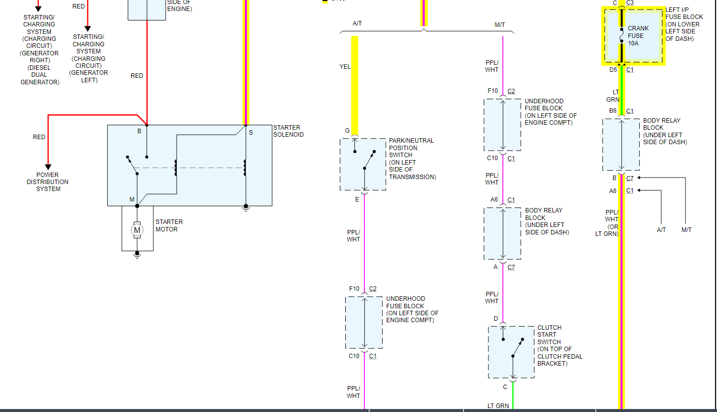

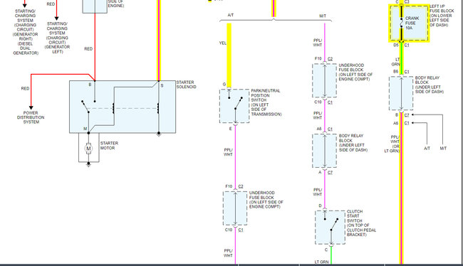

I attached a wiring diagram for you of the starting system.
You will need a test light or voltmeter to some testing at the relay.
You need constant 12 at one terminal with the key on. Then another terminal should be hot when you turn the key to the start position.

Just tested the relay itself. Due to time constraint I have had it towed to a garage. Hopefully they will find the problem and fix it. Thank you so much for your help! God Bless you and your family.
