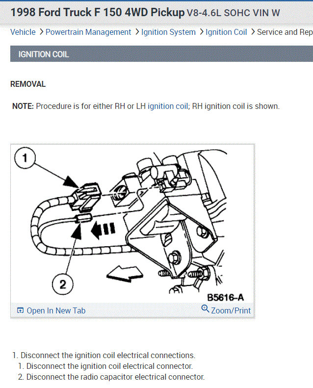

Cold revved my truck the other day and heard a loud bang, checked for holes in the block and even pulled the plugs and noticed the passenger side plugs were wet with fuel so I cleaned them up and put it all back together. Fired it up and it stuttered for about 2 minutes before turning it self off I felt of the manifold and the driver side was hot while the passenger was stone cold on every cylinder. Truck was running like a top until this...

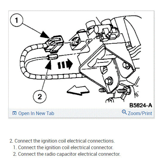

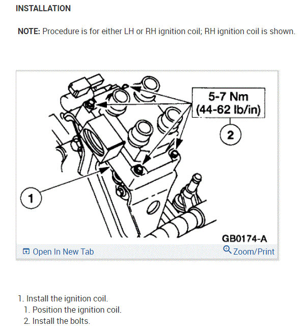

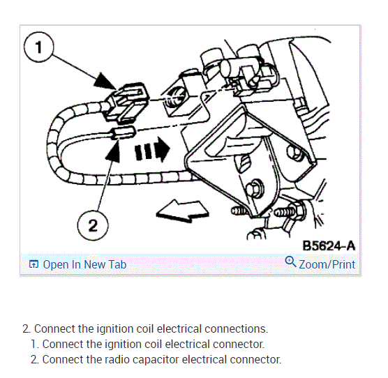

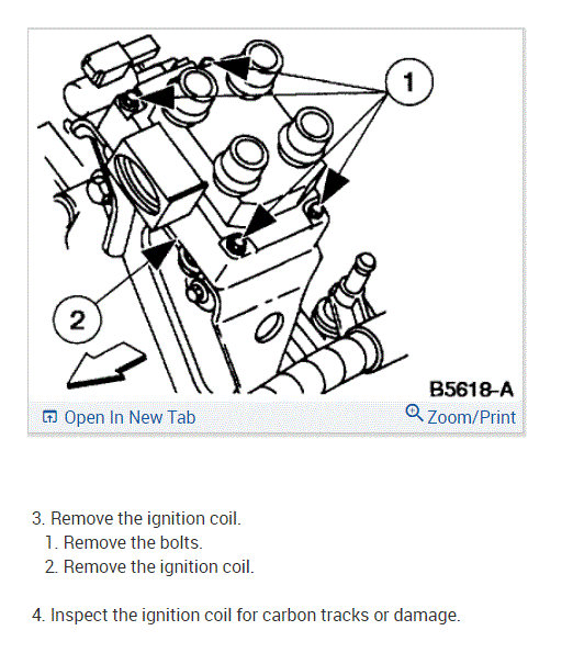

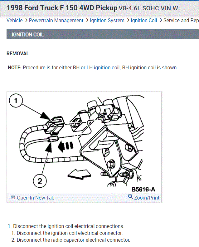

It sounds like the ignition coil for that bank is bad. The first thing I need you to do is check to see if there is spark to the plugs on the passenger side. Here is a link that shows how it's done:

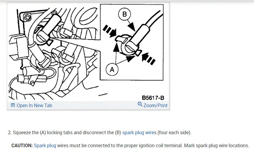

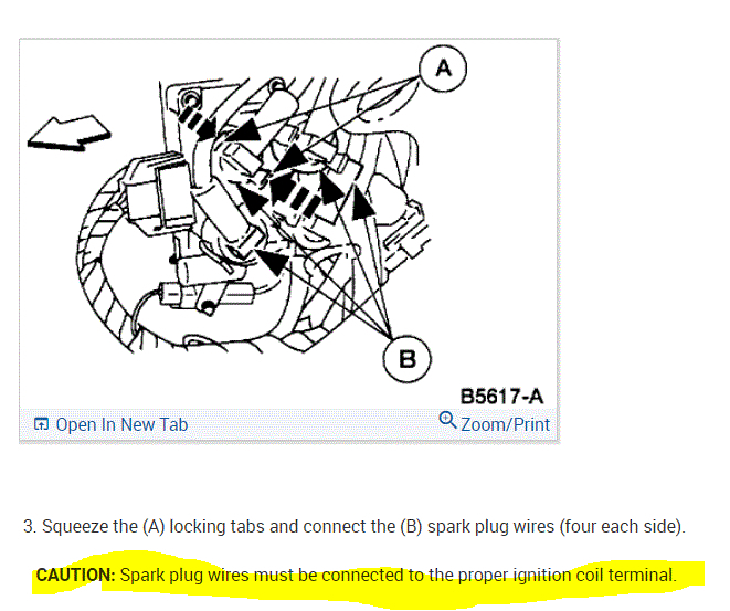

If there is no spark, switch the coils and see if you get spark then. There should be a coil pack on each side. Switch them and see if the spark returns to the bad side and is lost to the other. If it does, replace the coil.
If you look below, it shows how to replace the coil. Make sure not to mix up the spark plug wires. They must be reinstalled exactly in the same positions.

Okay, so I double checked both coil packs and the wiring just to make sure, the truck was only $500.00 so it isn't the best but after I investigated some more I notice the driver side Down stream O2 sensor has been blown clean out leaving the threads behind there is no exhaust just the four catalytic converters with about 4 feet of pipe from where it was cut by previous owner, I also got mad at it and hard revved a few times which brought 7 of the 8 cylinders to life. Also This is not coil on plug. The truck will not run unless I give it gas at about half throttle as well.
