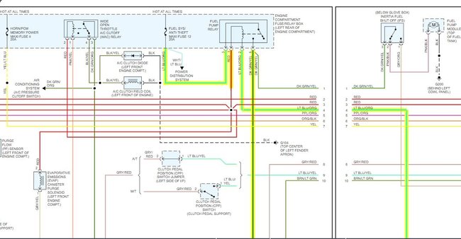

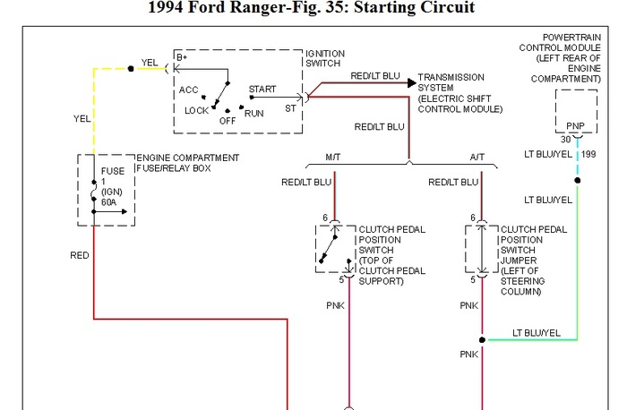

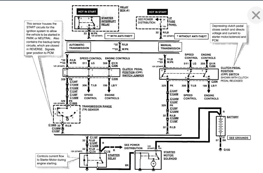

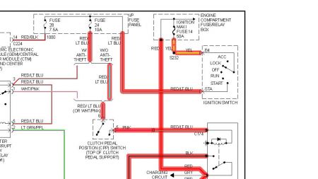

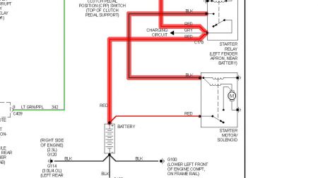

If battery/connections are okay-check fuse no. 24 10amp if okay-jumper clutch switch at clutch pedal support red and blue or white and pink wire to the plain pink wire at connector. Note: The red and blue or white and pink wire at the switch connector should have power when key is at start positon. No power to this wire and fuse no.24 okay-the ignition switch is bad. When clutch switch is jumpered the red and light blue wire at starter relay should have power and also the black wire going to the starter solenoid. Power at black wire on the solenoid-Replace the starter- See starter circuit below

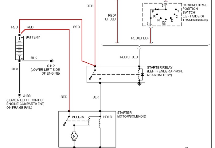

Instead of just throwing parts at it, which will get you nowhere, why don't you do some testing to find out where your problem is. Here is the diagram you will need to do that. https://www.2carpros.com/images/external/42370987.gif

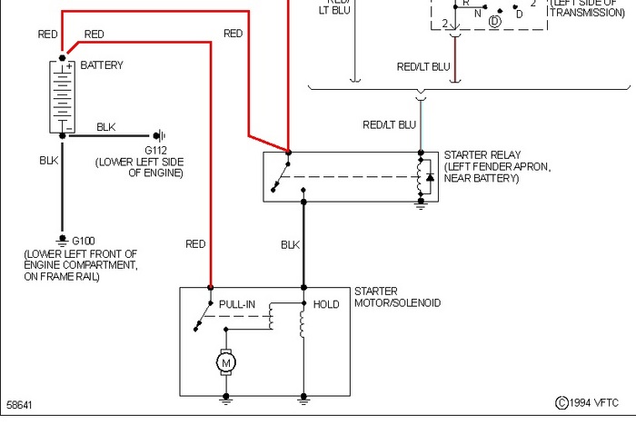

Ford used three different versions of starting circuits. If you have a solenoid on top of the starter motor, with a big fat battery cable and a smaller second wire attached to it, the solenoid on the inner fender is just being used as a simple starter relay, not as the actual solenoid like they used in previous years. You will see there is no fat cable bolted to the second large terminal on it. Because of this, there are three versions of that solenoid / relay on the inner fender and you must use the correct one. Did this problem show up before you replaced any parts or only after you replaced them?
Start by unplugging the small red / blue wire from the relay. Connect a grounded test light to that wire, then see if it lights up when you turn the ignition switch to "crank".

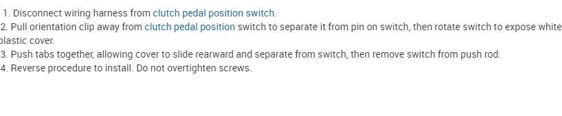

Good morning,
Check the clutch switch on the clutch pedal. It may have been damaged.
I attached a video from you tube since I could not find a picture for you.
https://www.youtube.com/watch?v=fBCiFlqcA3I
I attached a procedure for you as well.
