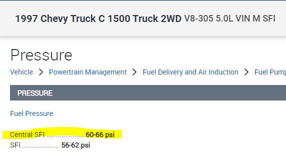

Hi, I don't know if you can still respond here but I have a question. Since putting in the crankshaft sensor and fuel pump the truck hasn't stalled and almost always starts great. I say almost because in the last 2 months or whatever it was since I changed the crankshaft sensor three times it did do one of the things it used to do meaning it didn't start on the first crank. But mostly it starts good.
But ai noticed something recently that ai don't understand. This truck I believe is the CSFI type as opposed to the SFI type. The CAFI is supposed to have a fuel pressure of 60-66 psi at all times from what ai have read even in Chevy's service manual.
When I first replaced the pump, I really didn't check the fuel pressure. But recently, after around a month and a half of changing the pump, I was curious about checking it.
I checked it yesterday with a gauge that I rented that seemed new. With key on, engine off, it immediately goes to about 60psi, but after 1-2 seconds slowly drops down to about 53PSI. This is key on, engine off.
When you start it, idling, it goes to about 50psi and stays there.
Isn't that still low? It's at least 10psi lower than they say it should be.
I don't understand why this truck no matter what you do the fuel pressure is never 60-66psi. It was at 44psi when it was stalling out, so I feel like it only has to drop another 6 pounds and I be in the same situation. Seems kind of ridiculous with a new Delphi pump and supposedly the filter is new also.

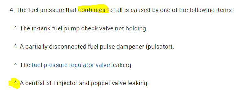

  • 109,896 POSTS
Yep, I'm still here. LOL As far as the fuel pressure, it should be what you said, 60-66 PSI. If it drops off, you could have an injector leaking or a pressure regulator leaking.
Do you ever notice any black or dark gray smoke from the exhaust?
See pic below.
Thursday, August 8th, 2024 AT 9:11 PM

  • 109,896 POSTS
Grayish smoke can indicate a rich fuel mixture. Take a look at the pic below. Since the fuel pump is somewhat new, I would eliminate that (at this time) as the problem. When you checked pressure, did you have the vacuum hose to the fuel pressure regulator disconnected?
See pic below.
Friday, August 9th, 2024 AT 1:51 PM

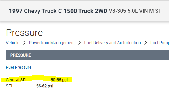

Fred,
Yes, it is normal for the pressure to drop a bit when it is running, but according to the specs, it should still be at 60 PSI.
