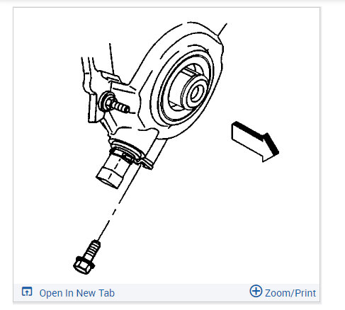

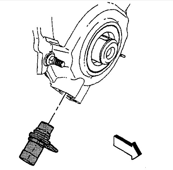

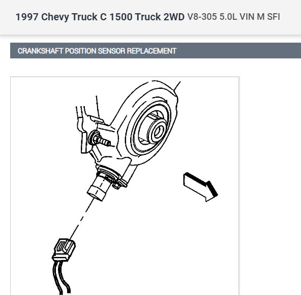

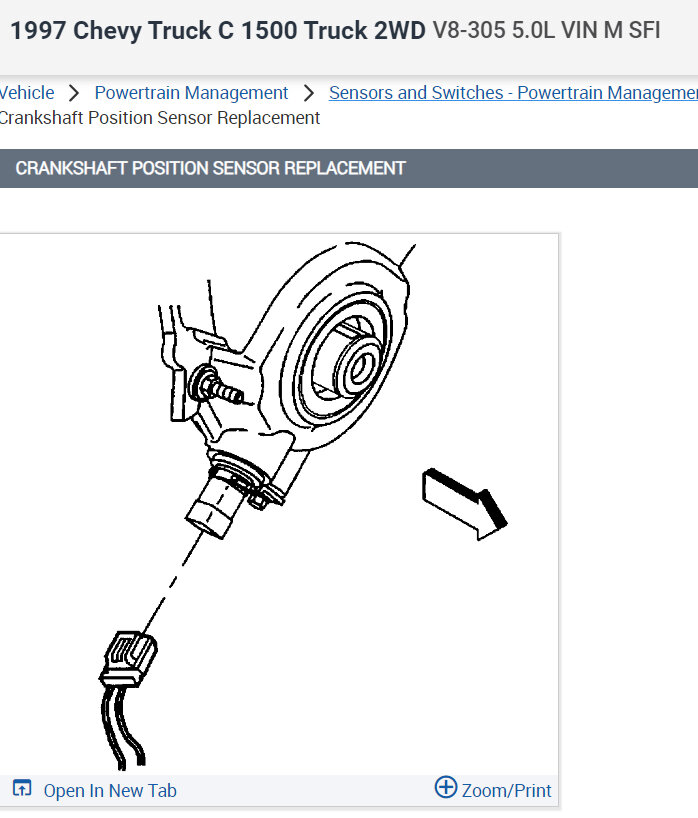

Here is the location of the sensor so you can check it out. Check out the images (below). Let us know how it goes.

Hello. Thanks for responding. The code is a P1351. Every time the truck starts but shuts off right away it sets that code. I started seeing that code after changing the ignition coil. But I get the feeling it doesn't have anything to do with the coil.
I read that article and yes, it definitely seems to sound like what is happening. Especially what it says about it doing it when it is hot and not cold.
The crankshaft sensor was replaced about 8 years ago. I'm not sure how long they last and I'm not sure what brand was used.

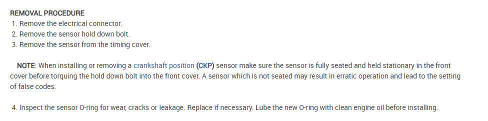

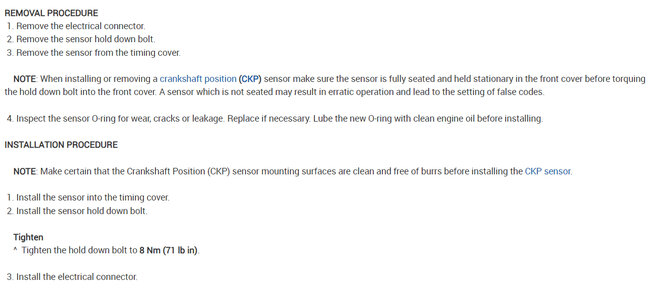

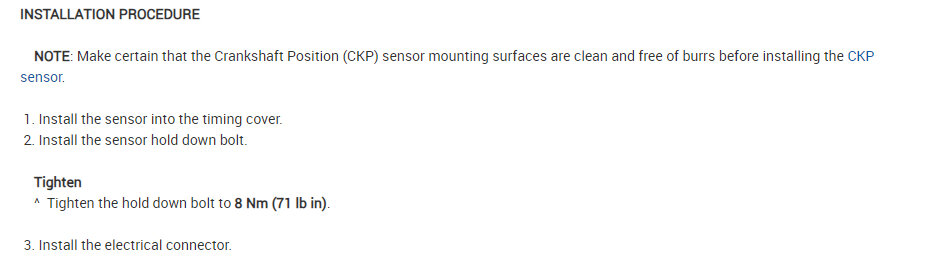

Note that the sensor isn't difficult to replace. I attached the directions below for you if you would like to do it yourself.

HI, I haven't changed it yet, but I should this week. I am wondering if it is necessary to remove the negative battery cable before doing it like they say? Also, some people say after doing that you have to do a crankshaft relearn procedure. Is that true?
May 13, 2024 at 3:32 AM
  • 55,433 POSTS
Yes, you can disconnect the battery to be safe, also you should to have to do a sensor relearn on it, it does not say instructions that you will need to.
May 14, 2024 at 2:29 AM
FREDERICK-59
  • 18 POSTS
I did install the crankshaft sensor today so we'll see how it goes and I"ll let you know. I have a question. As I mentioned above, the fuel pressure is supposed to be around 60-66 PSIi and the mechanic who had it showed me how when running for a while idling it goes down to 40-45 PSI.. Do you think that is low enough to cause it to stall out while driving? I know sometimes I have let it get very low on gas which I know is not good but I'm just wondering if that 20PSI of lower pressure would cause it to stall out.

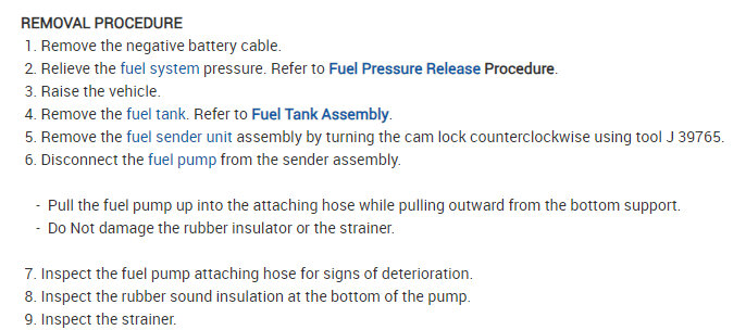

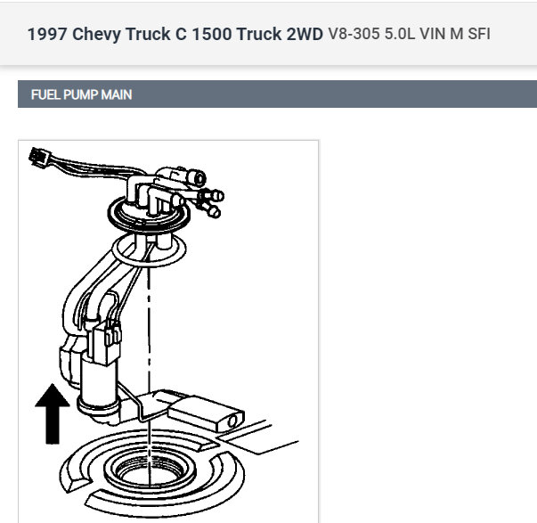

The idea that you lose power under a load is likely the result of low fuel pressure. At this point, I feel it may be in your best interest to replace the pump.
I sent directions for replacing the pump below. However, the tank will need to be removed to access it. For those directions, I would to know if the vehicle is a regular cab, extended cab, or is a cab and chassis (which I doubt).

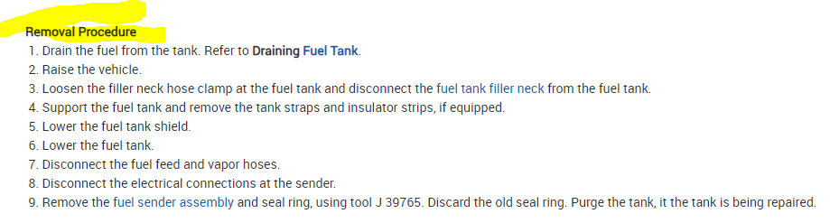

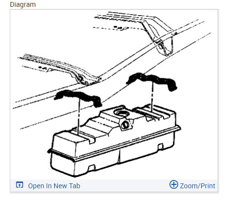

I think it is just the regular cab. I mean there is the area where you and a passenger can sit and there are no more seats in back and the 8 ft bed behind that area where the driver and passenger sit.
What worries me is if in taking down the tank if that would cause any more fuel lines to break. The pump was replaced about 7 years ago.
How high does the truck have to be to get the tank down? Can you do it if you put the front on ramps and jack up the back to about the same height?
Thanks again
Jun 2, 2024 at 5:38 AM
  • 110,244 POSTS

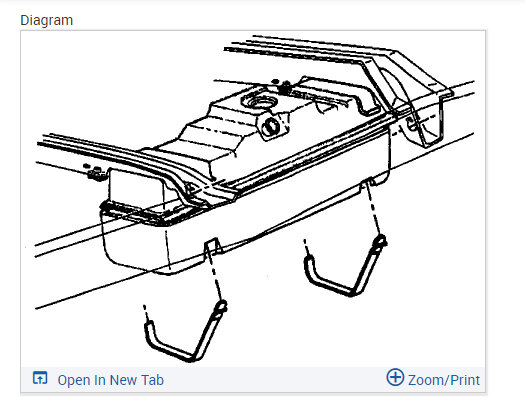

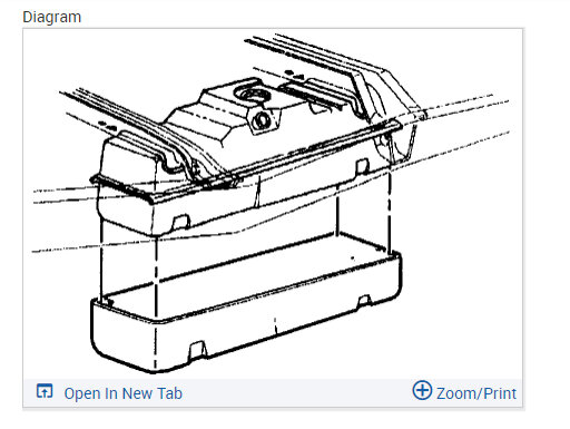

Yes, if you aren't careful, it can damage fuel lines. As far as the vehicle height, you don't have to lift it. You will want it low so you can slowly lower it from the vehicle using a jack. The less fuel in the take, the easier the job. I would recommend disconnecting the battery before working on it.
Also, if there is room behind the driver's seat, it sounds like an extended cab. I attached directions below for removing and installing the tank. The directions start with pictures of each step and then are followed by the directions.

Hello, just giving an update. A guy I know and I installed a new fuel pump with sender unit Sunday.
It seems to run a lot better since installing the crankshaft sensor and now the pump. Haven driven it a lot yet but ai did drive at least 15-200 miles since the pump and no problems.
I think it actually need both the sensor and the pump. The sensor seems to have fixed the hard starting and where it would start but after about a second would stall out. After the sensor it didn't seem to do that anymore.

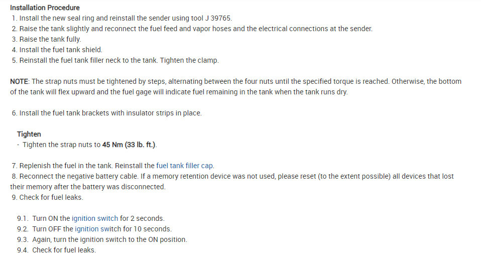

One other question: It says in the manual to tighten the tank straps to 33 foot pounds. It doesn't seem like I can because It seems pretty tight already and according to the torque wrench it isn't even at 25 foot pounds. Unless the wrench is bad. I'm afraid if I tighten it too much it will damage the tank or the straps will break somewhere.
What do you recommend?
I really appreciate all the help!
Jun 25, 2024 at 1:49 AM
  • 110,244 POSTS
As far as torque, if the wrench is good, 33 ft/lbs really isn't overly tight. It won't hurt the tank or damage the straps.

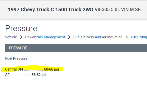

Hi, I don't know if you can still respond here but I have a question. Since putting in the crankshaft sensor and fuel pump the truck hasn't stalled and almost always starts great. I say almost because in the last 2 months or whatever it was since I changed the crankshaft sensor three times it did do one of the things it used to do meaning it didn't start on the first crank. But mostly it starts good.
But ai noticed something recently that ai don't understand. This truck I believe is the CSFI type as opposed to the SFI type. The CAFI is supposed to have a fuel pressure of 60-66 psi at all times from what ai have read even in Chevy's service manual.
When I first replaced the pump, I really didn't check the fuel pressure. But recently, after around a month and a half of changing the pump, I was curious about checking it.
I checked it yesterday with a gauge that I rented that seemed new. With key on, engine off, it immediately goes to about 60psi, but after 1-2 seconds slowly drops down to about 53PSI. This is key on, engine off.
When you start it, idling, it goes to about 50psi and stays there.
Isn't that still low? It's at least 10psi lower than they say it should be.
I don't understand why this truck no matter what you do the fuel pressure is never 60-66psi. It was at 44psi when it was stalling out, so I feel like it only has to drop another 6 pounds and I be in the same situation. Seems kind of ridiculous with a new Delphi pump and supposedly the filter is new also.
Anyway, I appreciate your help.
Fred
Aug 8, 2024 at 12:54 AM
  • 110,244 POSTS
Yep, I'm still here. LOL As far as the fuel pressure, it should be what you said, 60-66 PSI. If it drops off, you could have an injector leaking or a pressure regulator leaking.
Do you ever notice any black or dark gray smoke from the exhaust?

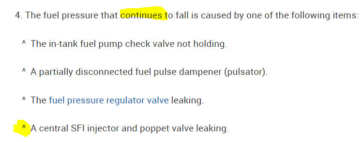

It did go up to about 60psi when rhe keybwas on and engine off but thwn it goes down slowly to about 53psi. Then started it is at 50psi.
Is there any wáy to check fuel injectors on that wirhout removing upper manifold?
Thanks,
Fred
Aug 9, 2024 at 6:16 AM
  • 110,244 POSTS
Grayish smoke can indicate a rich fuel mixture. Take a look at the pic below. Since the fuel pump is somewhat new, I would eliminate that (at this time) as the problem. When you checked pressure, did you have the vacuum hose to the fuel pressure regulator disconnected?

I have seen the fuel trims on a cheap scanner I have and it does show a little rich especially on bank 2. I think it's like - 2-3% on bank 1 and - 8-10% on bank 2. As far as the regulator I'm like 99% sure the he fuel pressure regulator on this truck is under the upper intake manifold with the injectors.
It is normal that when you start it it would go down more than where it is when the engine is off wirh key on? I think I read that it would go down about 5 PSI, but this is going down more.

Yes, it is normal for the pressure to drop a bit when it is running, but according to the specs, it should still be at 60 PSI.
As far as the regulator, yep you are correct. It's under the intake. They make nothing simple.

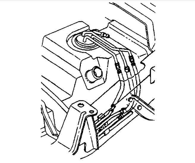

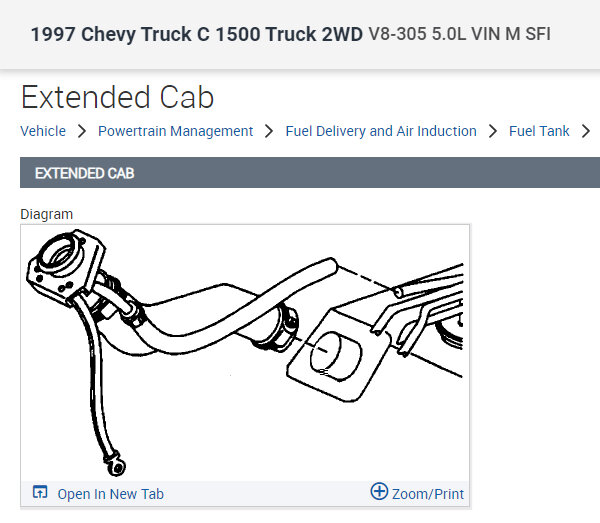

I have another question. A lot of times I smell gas when I am around the truck. Sometimes I have small 2-3 gallon tanks in the bed with gas but I don't think it's that.
I checked underneath and I don't see anything leaking unless it is something on top of the tank that I can't see.
One thing we did notice when I was changing the tank with the friend of mine is that there is a metal hose that is connected to a rubber hose that is connected to the fuel filler neck and we noticed when putting gas in the tank again that that hose apparently leaks on top.
I read on a website that an evaporator system that is not working properly can cause low fuel pressure. Do you think that is possible?
This is the hose I am talking about.
https://www.classicindustries.com/product/all-years/chevrolet/c1500/parts/K94764.html?gad_source=1&gclid=Cj0KCQjwn9y1BhC2ARIsAG5IY-6ResTll3c9yz0W7O1uKLyAnYcUkVP5ySA3rwJLc0sB1pG0OWDBj5gaAvVPEALw_wcB&gclsrc=aw.ds
It's the thin metal hose that is about 10 inches long.
Is it possible to put those sealants on there that are resistant to fuel? I say that because you can't even get that anymore except on that site that I sent you, but you have to buy all of it for $80.00 or whatever?
Fred
Aug 10, 2024 at 1:22 AM
  • 110,244 POSTS
The smaller hose/tube on the filler is a vent for when you fill the tank. Yes, you could use something that is resistant to fuel, but make sure it is strong and doesn't block the tube. If it does, you will go nuts getting fuel into the tank.
