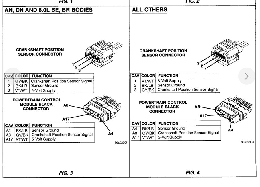

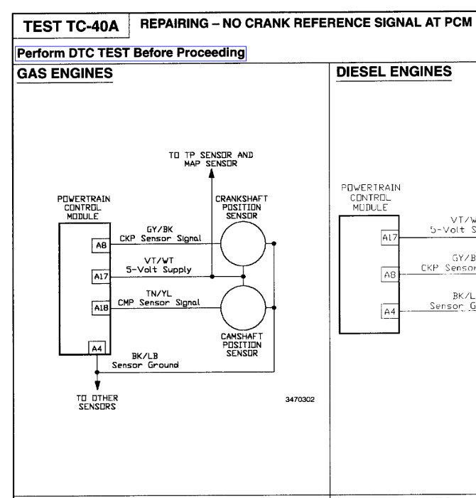

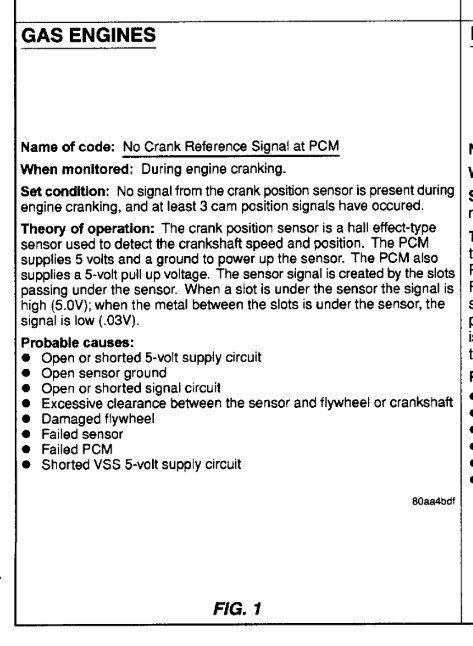

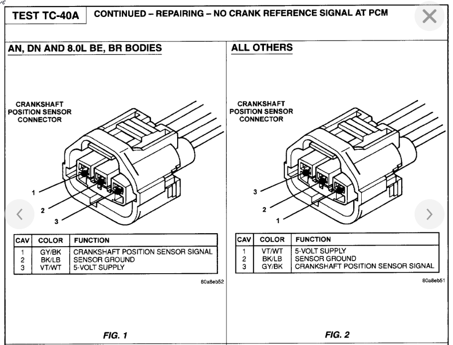

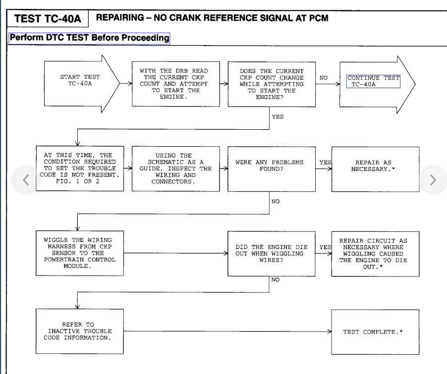

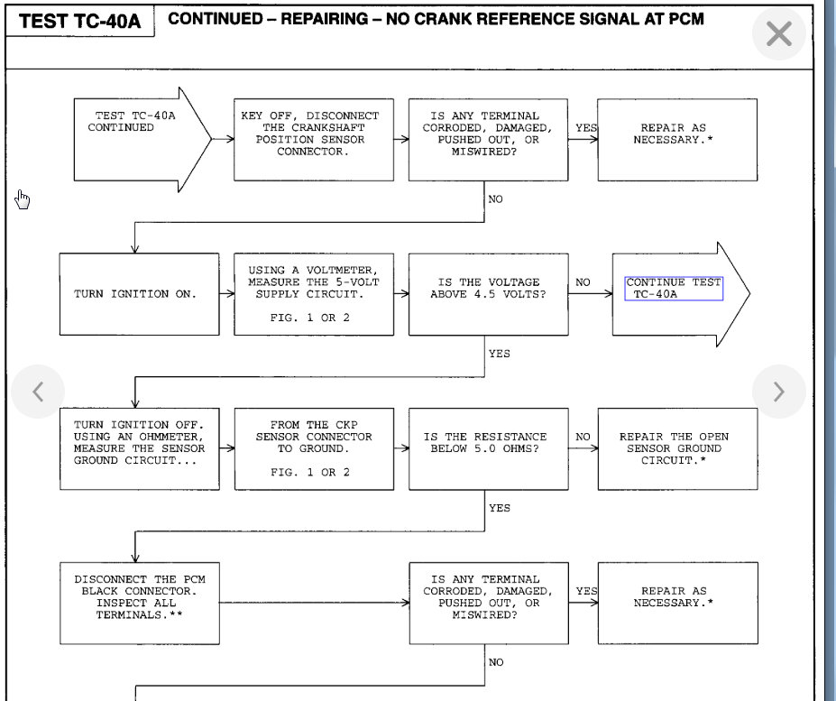

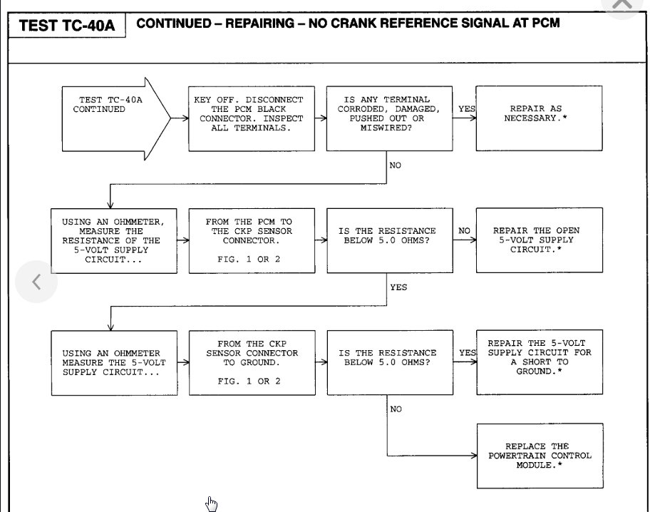

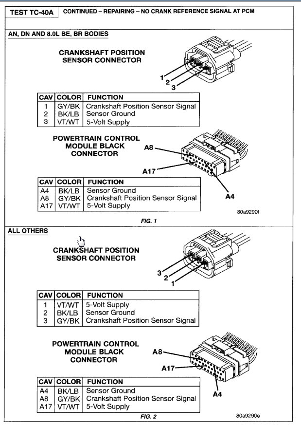

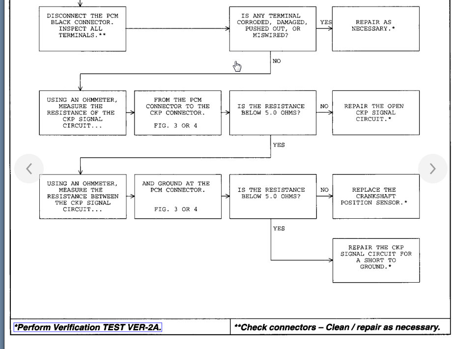

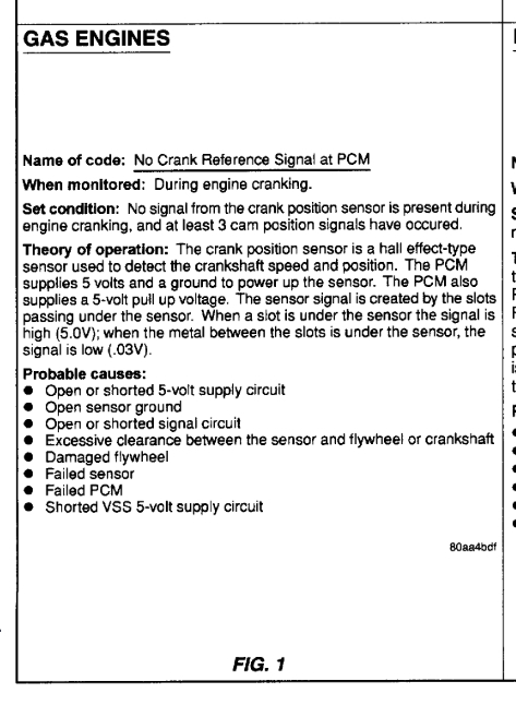

I am getting a code now for the crankshaft position sensor.. codes are p0320 and p1391. Truck still runs fine when cold but when warm it acts up real bad now. Rpm's are jumping all over the place. Kinda surprised i made it home. I had to two foot the truck the whole way home. Pretty scary when you need to do a 3 point turn on a county road with the truck stalling.
Nov 28, 2019 at 8:15 AM
These codes are similar and are most likely causing your issue. I attached the code detail for the P0320 because I am sure that test will help you find the issue. The other code is for intermittent loss of cam or crank. If you fix the P0320, then I am sure you will fix the P1391.
