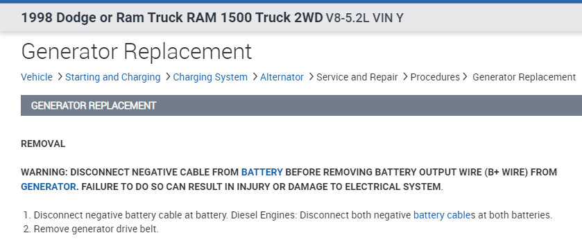

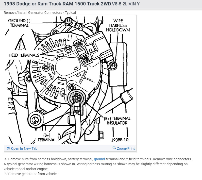

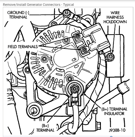

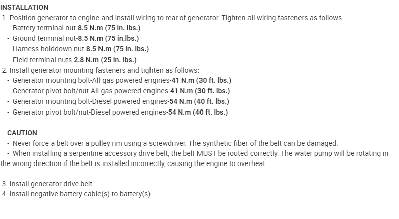

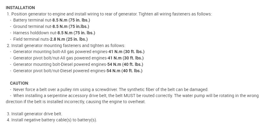

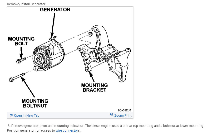

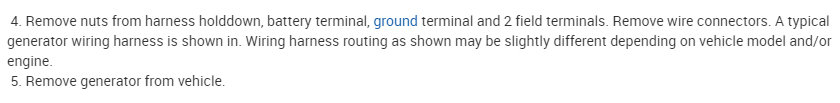

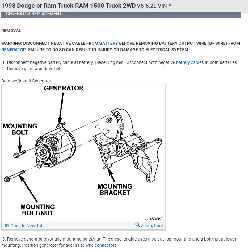

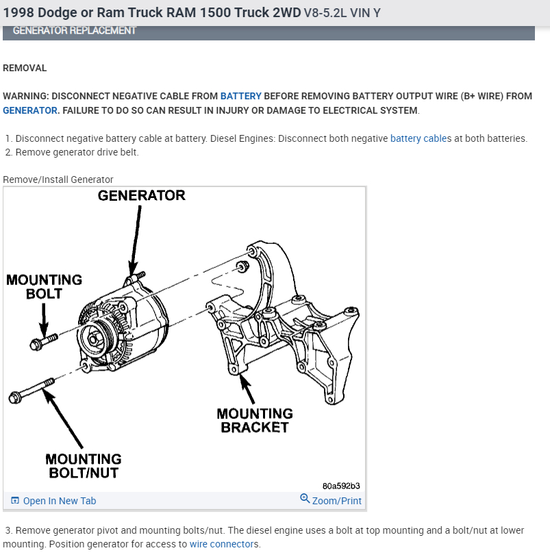

Additionally, I attached the directions below specific to your vehicle.

Attached is the alternator replacement procedure below for your reference.
