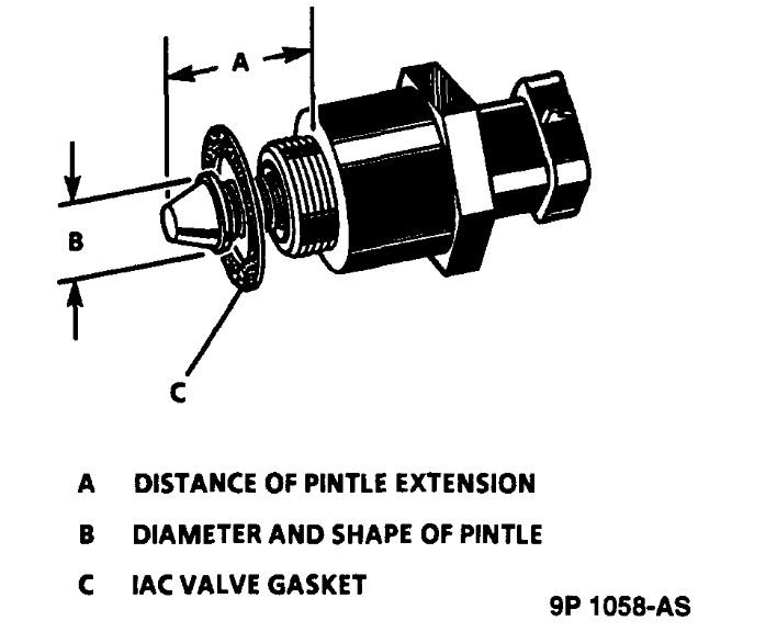

It could be the idle air control valve or the throttle body being dirty. I attached some guides for you on the issue.

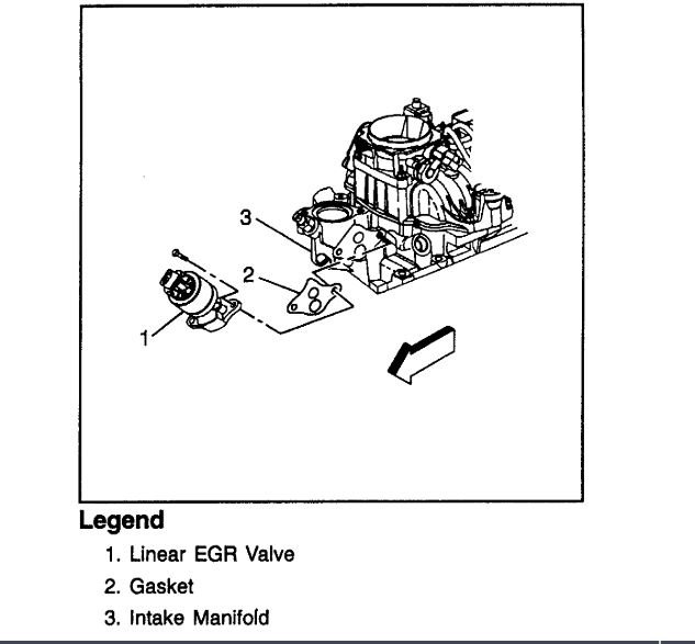

Also, a stuck open EGR valve will do this as well.

Yes, it would.
Can you 2 foot it and keep it running?
NOTE: The IAC valve is an electrical component and must not be soaked in any liquid cleaner or solvent. Otherwise damage could result.
IMPORTANT: Thread-mounted IAC Valves have a dual taper, 10 mm diameter, pintle. The flange-mounted IAC valve and has a 12 mm diameter, dual taper pintle.
Any replacement of an IAC valve must have the correct part number, with the appropriate pintle taper and diameter for proper seating of the valve in the throttle body.

NOTE: If the IAC valve was removed during service, its operation may be tested electrically with the IAC system analyzer (J 37027 or BT- 8256K). However, if the valve pintle is extended electrically, it must also be retracted electrically. Before installing an IAC valve, measure the distance between the tip of the valve pintle and the mounting surface. If the dimension is greater than 28 mm (1.10"), it must be reduced to prevent damage to the valve. This may be done electrically using on IAC system analyzer motor tester (J 37027 or BT-8256K).
MEASURE
Distance between tip of IAC valve pintle and mounting flange.
If greater than 28 mm, use finger pressure to slowly retract the pintle. The force required to retract the pintle of a new valve will not cause damage to the valve.
IMPORTANT: No physical adjustment of the IAC valve assembly is required after installation. The IAC valve pintle is reset by the control module system which causes the valve pintle to seat in the throttle body. The control module then has a reset procedure to set the correct pintle position. Proper idle regulation should result.
