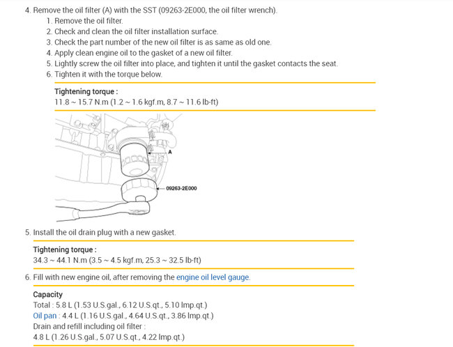

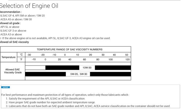

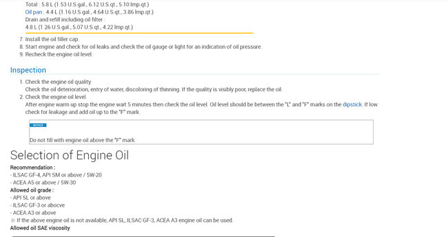

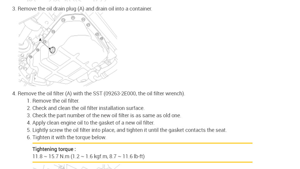

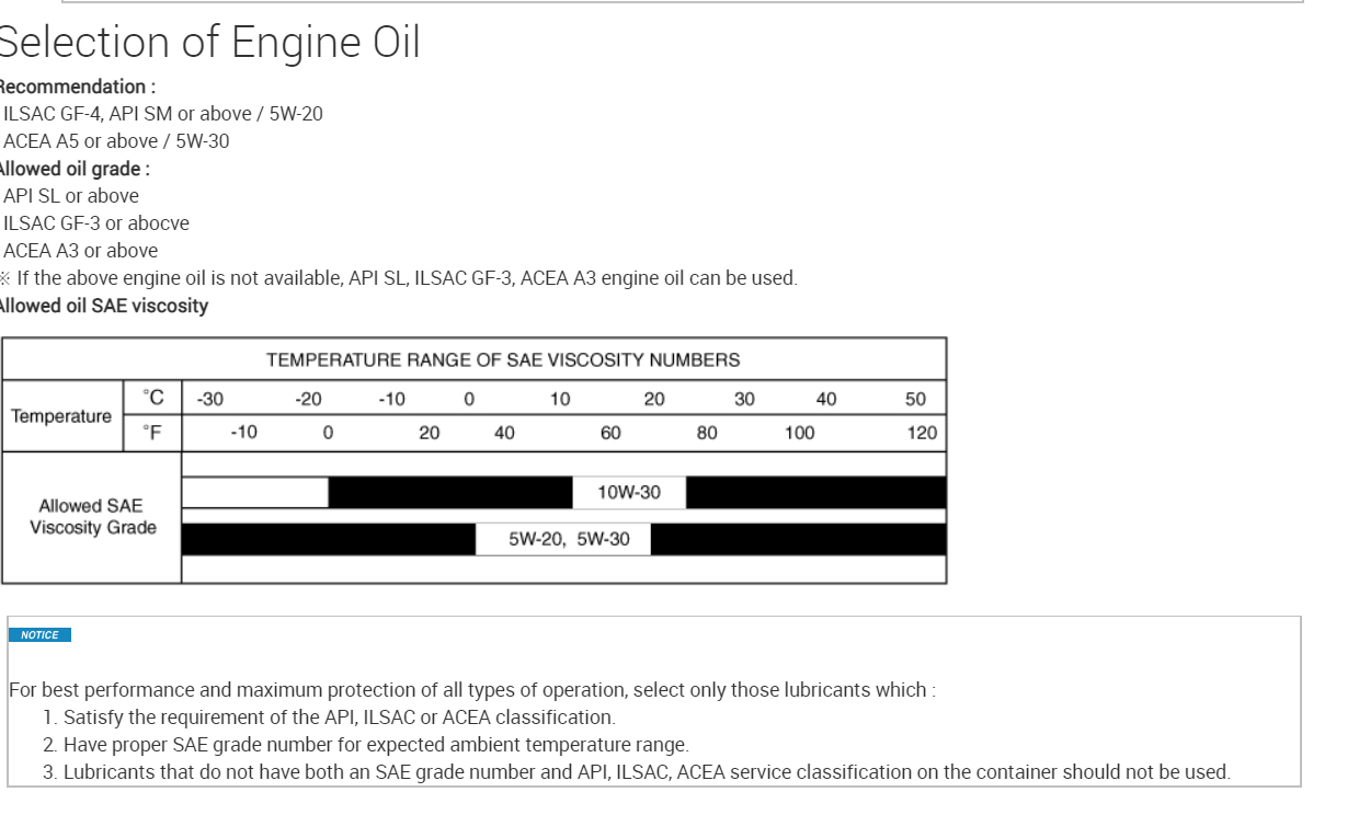

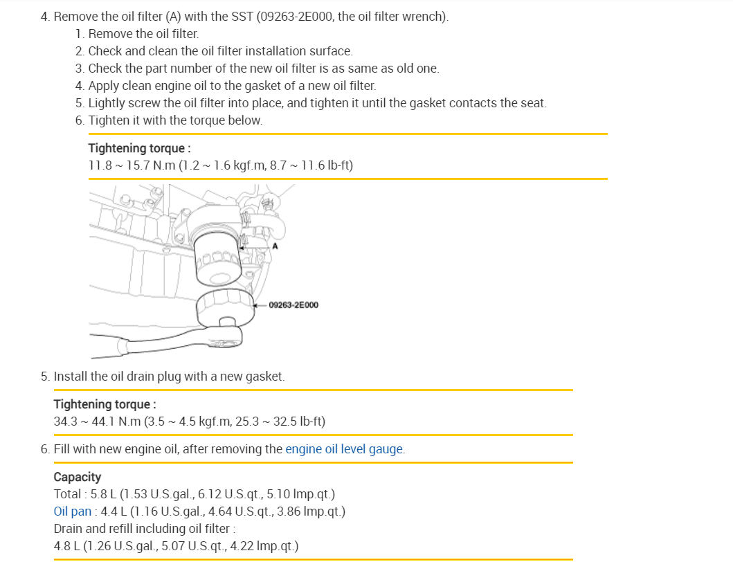

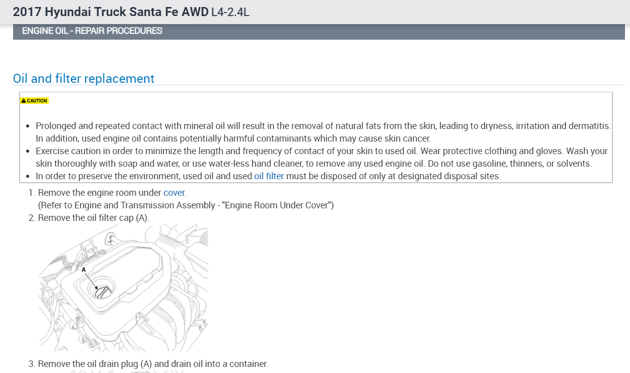

So, I would check the engine oil because the computer can tell when it is low on oil and shuts the engine off, so it doesn't lock up. If the oil is dirty change the oil and filter, here is a generic guide to show you how and instructions for your car int he images below.
https://www.2carpros.com/articles/how-to-change-engine-oil-and-filter
