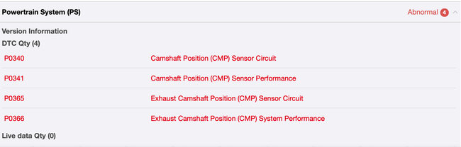

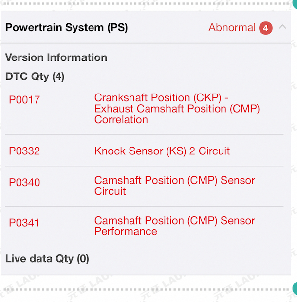

Yes, it is very interesting. The two photos show the diagnostic codes I am getting. This first one is when I am using the old Exhaust Sensor, and the second one is when I use the new Exhaust Sensor. I use the diagnostic scanner to reset, or I disconnect the battery for about ten seconds. Both will allow me to restart the vehicle with the old sensor, however if I use the new sensor in the vehicle none of the resetting methods will start the vehicle. I know if I take to the shop, they will tell me to change the sensors according to the reading they will get but all have been changed. Again, Exhaust and Intake Cam sensors, Crank Sensor, Fuel regulator, Fuel Pump. Once the truck is started, it runs great, but it just needs to get started. I thought about the timing chain, but I figured that can't be the issue as it starts the old sensor. It just won't restart once It's turned off. Will have to do a reset and who wants to be in the hood for every time.

If you disconnect the battery, try this. Disconnect both terminals from the battery and then zip tie them together for approximately 30 minutes. This will drain any capacitors in the system and hopefully, if this is a permanent fault, it should eliminate it.
Let me know if that makes any difference. Also, after doing this, see if there are any codes stored prior to starting it.
