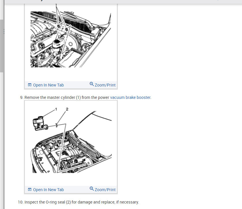

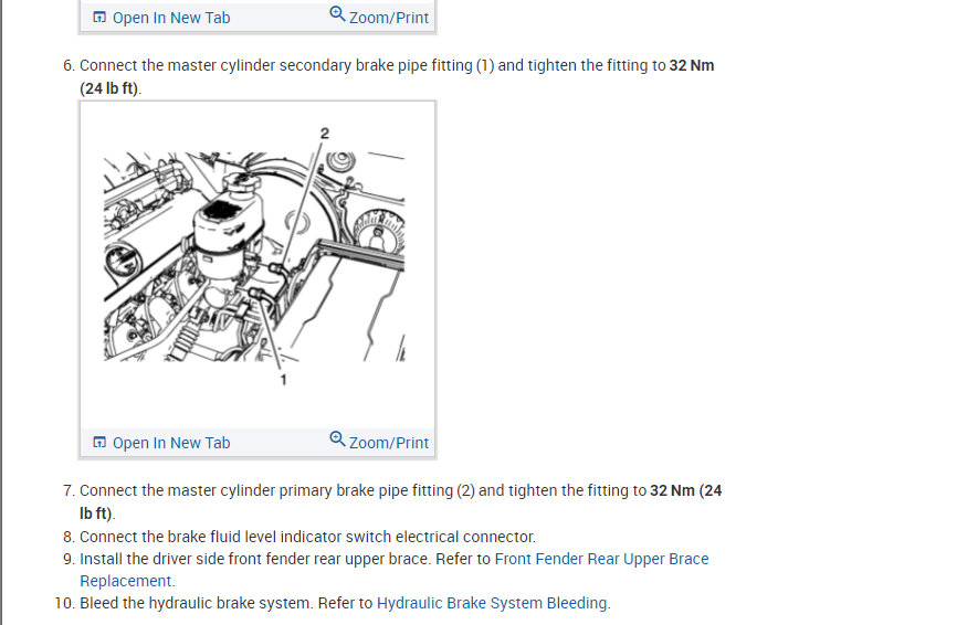

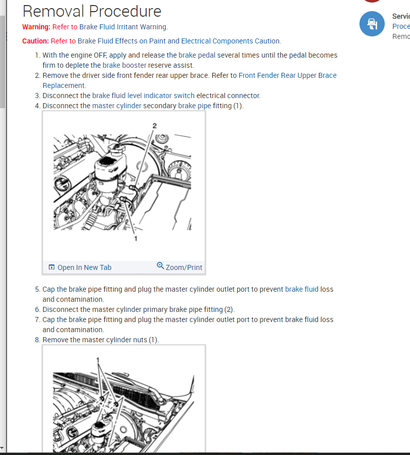

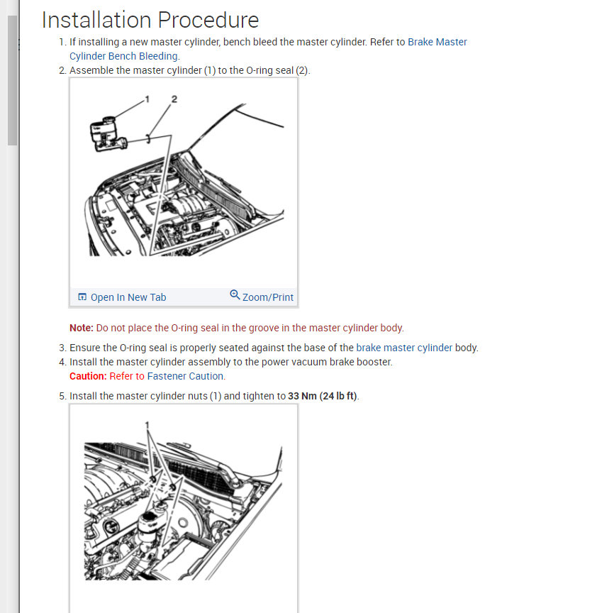

Below you will find the process from the manual on the master replacement.
Please run through this and let us know what you find. Thanks
