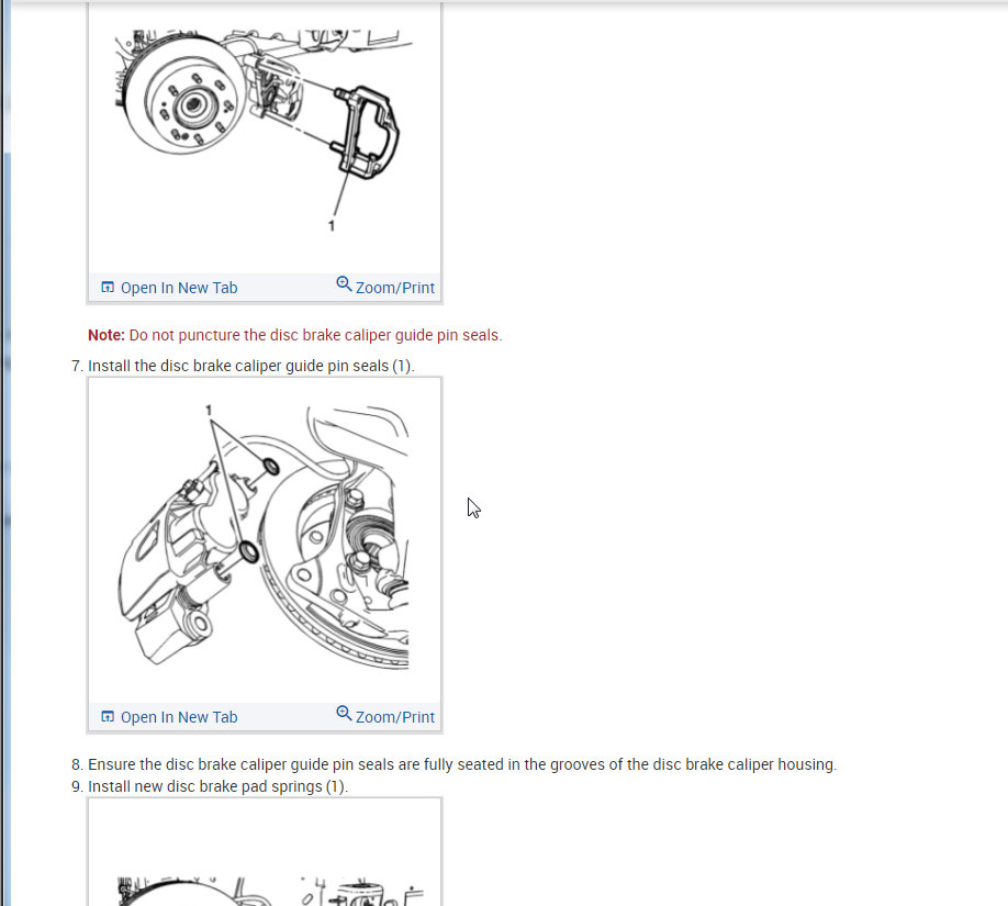

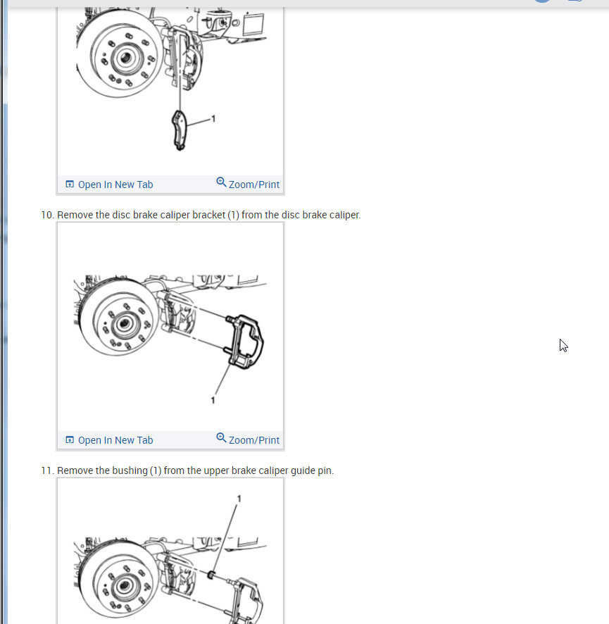

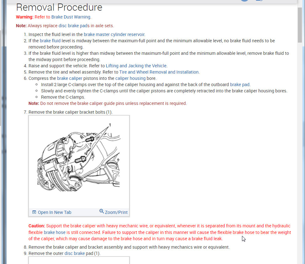

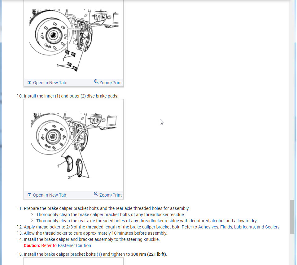

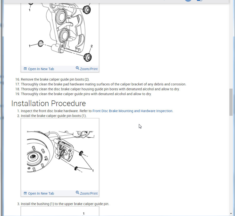

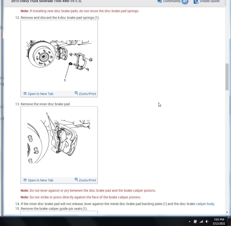

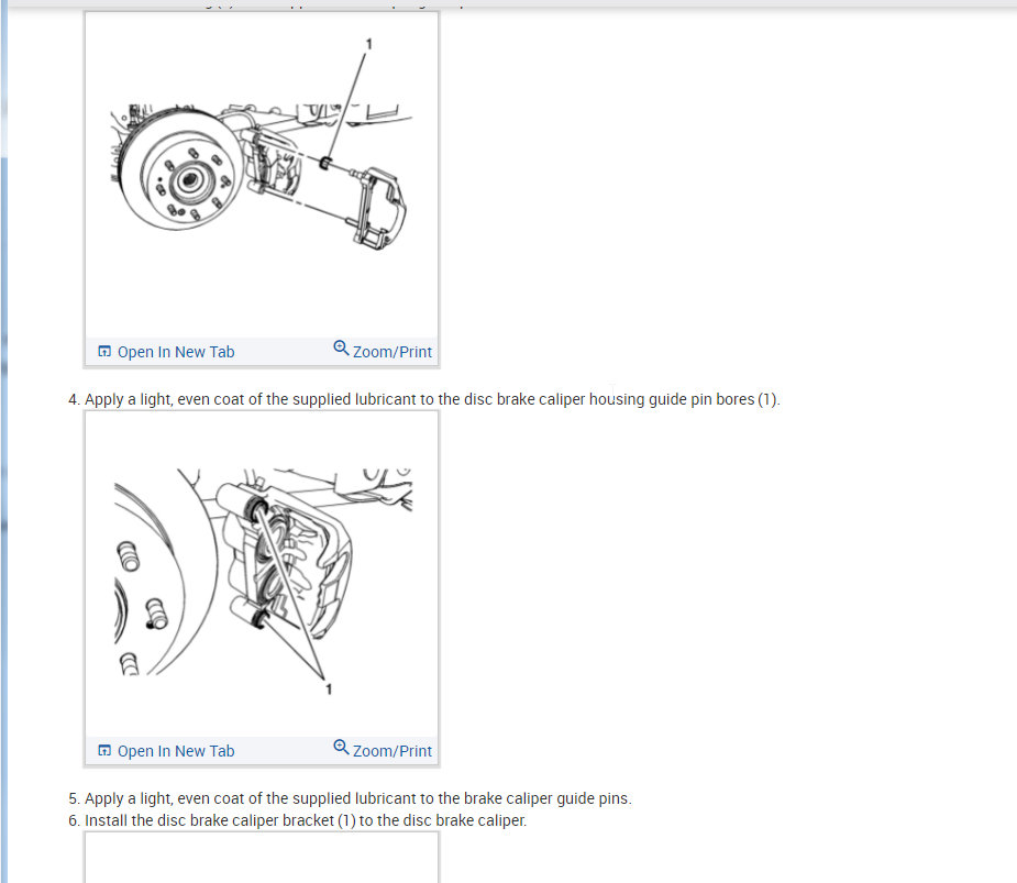

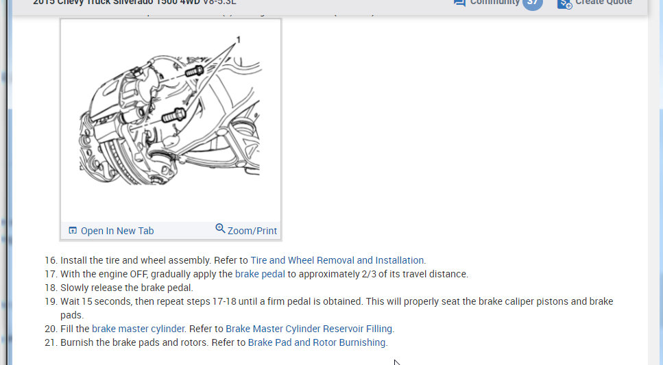

My wife called me about thirty minutes ago and said she was hearing some grinding from the front brakes I need to replacement them.
Dec 29, 2016 at 8:01 AM
Here is a guide that will help with this:
Here is a video that will help as well:
https://www.youtube.com/watch?v=jlKijXftTmw
Below is the process from the manual that will help with this. Please run through all this info and let us know if you have other questions. Thanks
