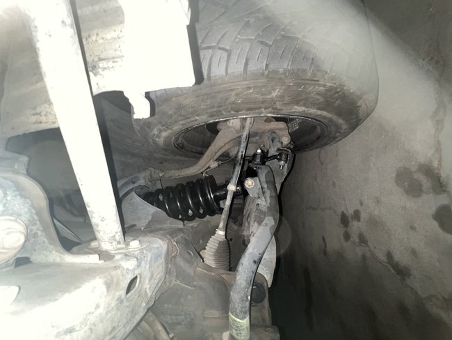

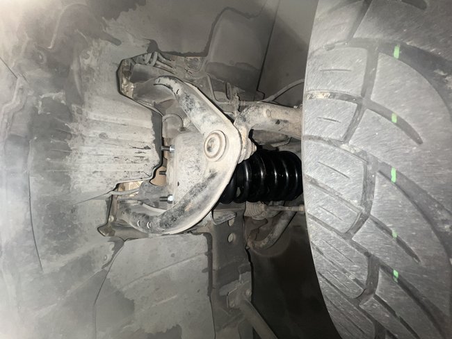

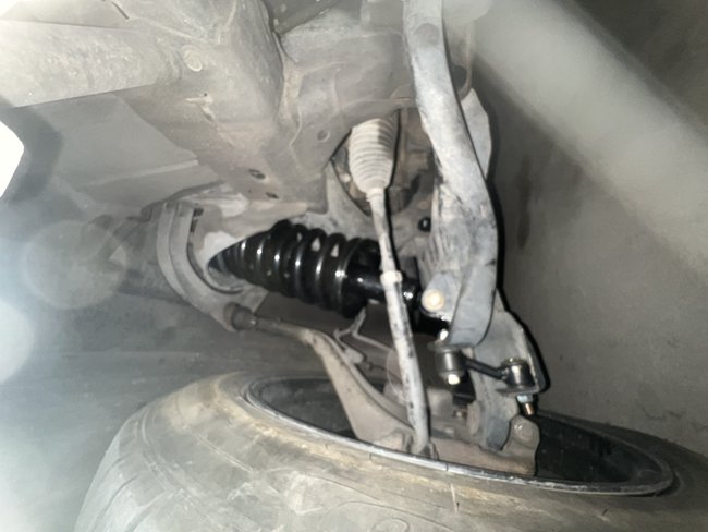

I used motorfab lifts 3” spacer and. Longhongauto shocks I used them on my previous truck and didn’t have this issue but thanks .Here’s the pictures:
Mar 13, 2022 at 1:00 PM
  • 110,240 POSTS
Hi, everything looks normal. I looked up the parts and they are standard. The strut is the only thing that can be causing the problem if everything is bolted in place.
I suspect you purchased the struts as an assembly. That is what I am finding when I look up the Longhongauto brand. Is that correct? If so, you wouldn't have been able to push the strut/coil to check it. I feel if you removed the struts and took apart the assembly, you would find the shock portion of the strut assembly has no or little resistance.

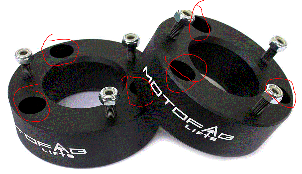

Let me know if the spacers below are what you have. Also, did the strut properly align with the holes on the spacer?

Yes, those are the ones and yes, the struts came assembled together all in one piece and the spacers aligned just perfect. I'm thinking it’s the coil on it does have 1 more or 2 then the factory one but it’s the same height.

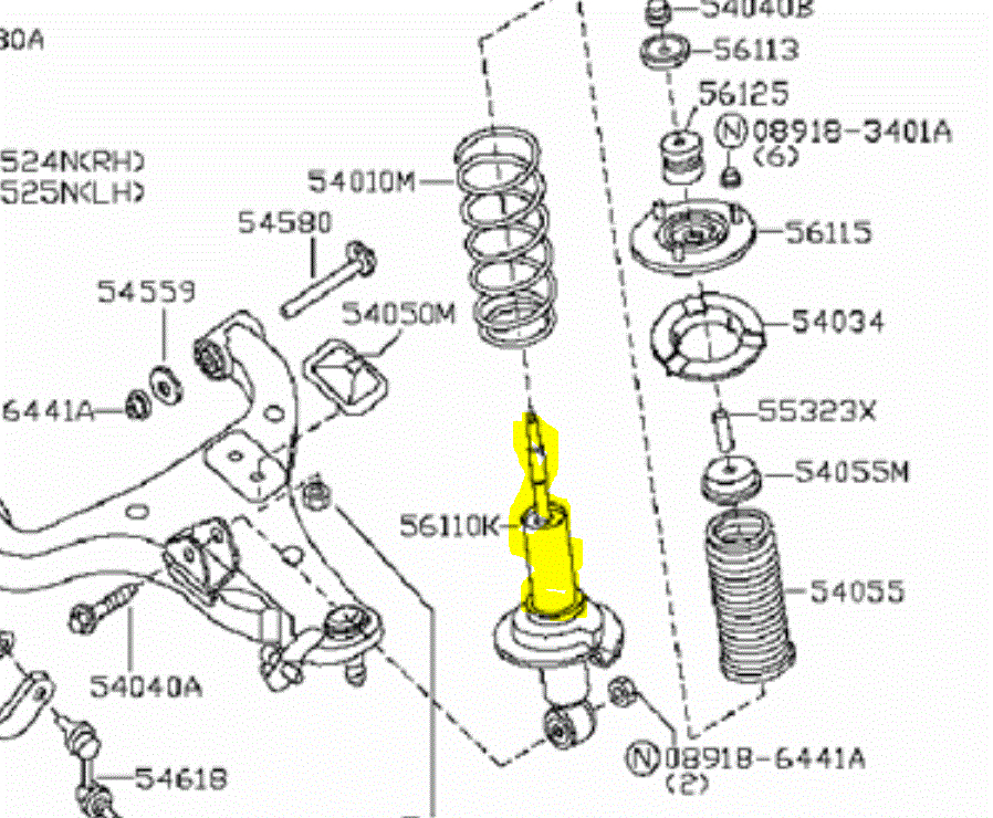

The coil springs only support the vehicle's weight. I truly feel that has nothing to do with it. The bounce is controlled by the shock absorber in the assembly. That is what I feel is simply no good. The only way to confirm would be to take the assembly apart and when the shock is no longer under coil spring tension, see if they move up and down easily. It shouldn't. It should require a lot of pressure to move up and down.
Note: Taking the assembly apart requires a spring compressor. Do not simply unbolt the upper strut mount. It can be very dangerous.
If you look at the pic I attached, I highlighted the shock portion of the assembly. That is the part I feel is bad.
Since they are new, I would return them and request a new set. That is the only thing that can be causing it to bounce excessively.
