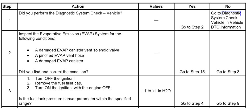

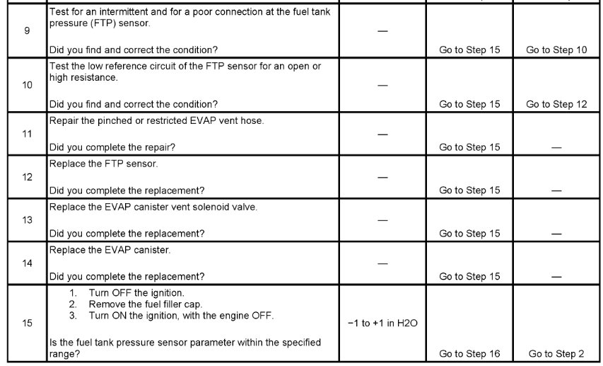

I do not know if this could be related, but I have also replaced the EVAP Purge Valve and EVAP Canister Valve and Filter trying to address DTC P0446 - EVAP Vent Solenoid Valve Control System. I was told that that code was related to the hard filling trouble I am having while filling the gas tank. I erased that code after replacing those parts and it has not come back yet.

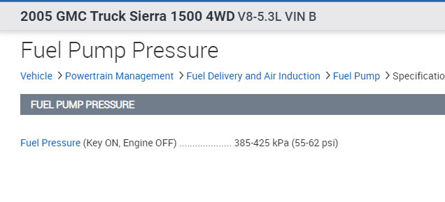

I attached the manufacturer's pressure specifications below. You will need a pressure gauge, but most parts stores will lend one to you if you don't have one.

To follow up on my previous reply, I was able to get a pressure gauge on the truck and run some tests.
Key On: 56-58lbs
Idling: 61-62lbs
Revved up: dips to ~60lbs
Under Load (Reverse and holding the break): dipped to ~60lbs
What does this mean along with the scan tool data?
May 30, 2023 at 9:16 AM
  • 110,244 POSTS
The fuel pressure is perfect, no problem. The readings are all good as well except the short-term fuel trims. You indicated bank1 sensor 2 is 99%. Do you mean bank 2 sensor 1?

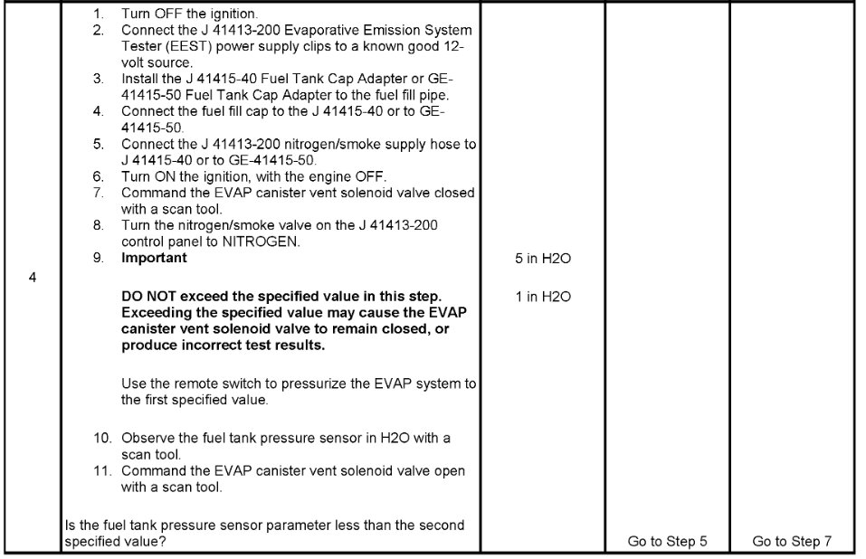

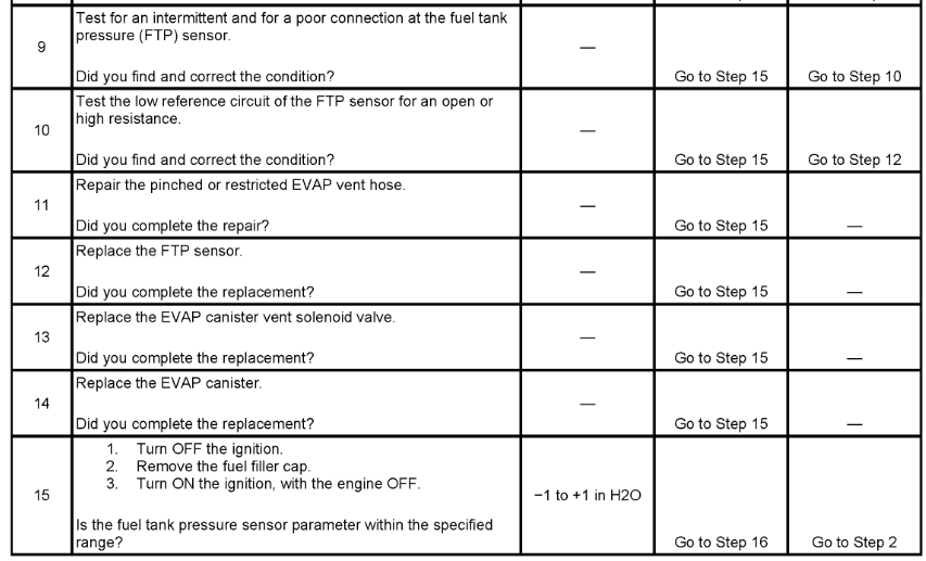

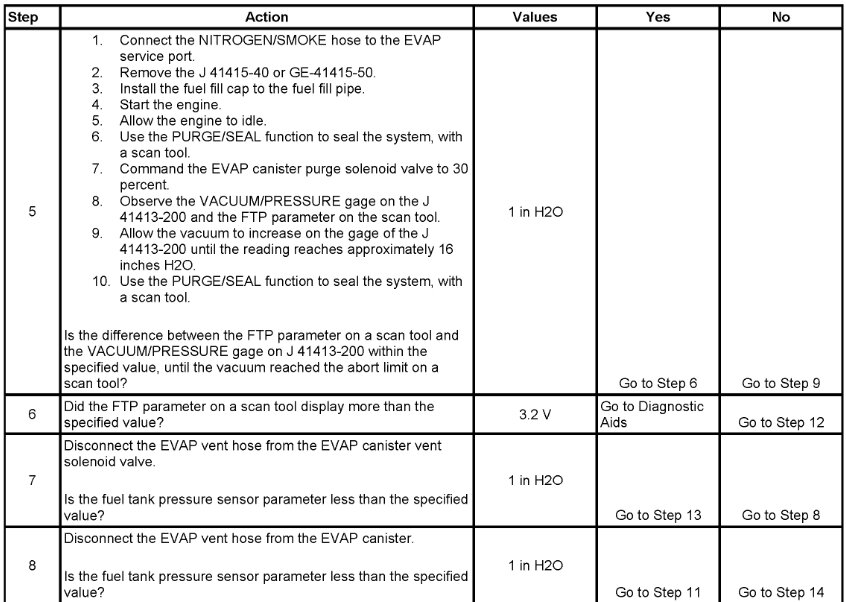

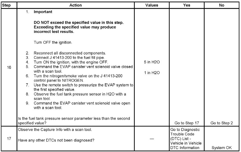

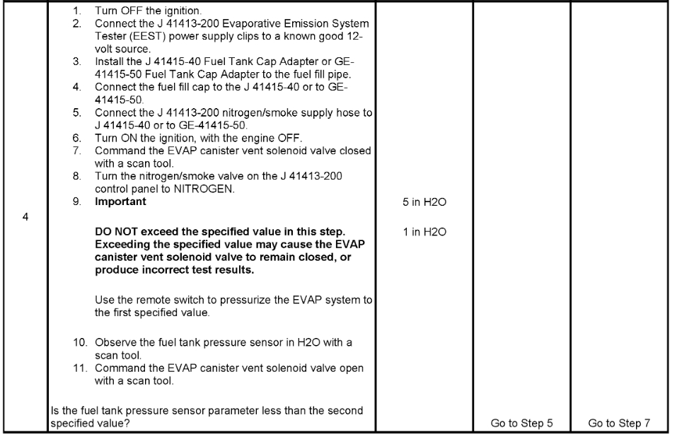

I went through the diagnostics for the code you have. Although I don't see how it would cause the sensor reading, it could cause a bog and stalling if there is a loss of vacuum. If you take a look below, I attached the diagnostics related to the code. Take a look through them and let me know if that is something you are comfortable performing.
Jun 9, 2023 at 8:50 AM

Joe, Thanks for the information. Unfortunately, I don't have a scanner that allows me to see the fuel pressure sensor data or a smoke machine to hook up. For step two, I replaced the purge valve and EVAP canister vent solenoid and filter. The EVAP canister itself, I have not pulled out and tested. That was my next thought if I could not get the code to go away. Along with blowing out the EVAP lines if the canister was bad, and the carbon pellets were spilling out.

I installed those parts because the gas tank was not filling well. They seemed to help, and the tank did fill better but still not able to fill with the pump on maximum.
I actually cleared the codes with the scan tool and the check engine light is out. However, I have a pending code that won't go away when I check using the scan tool. I've driven the truck a five or six times since replacing the parts, and the code is still pending when I run the scan tool.
Unfortunately, they did not help as far as fixing the stuttering when starting the truck.

A pending code is caused by an intermittent fault. The PCM needs to see it happen during two consecutive warm-up cycles to set the code. If the fault doesn't occur again over a period of 40 warm-up cycles, the code is automatically deleted.
