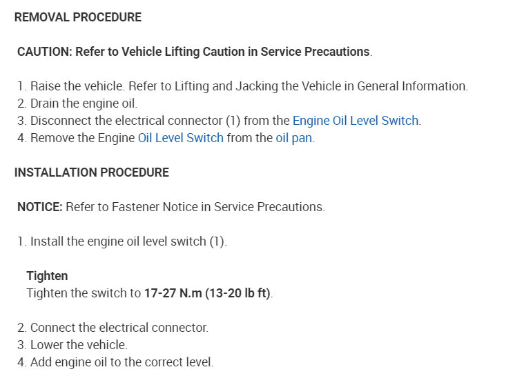

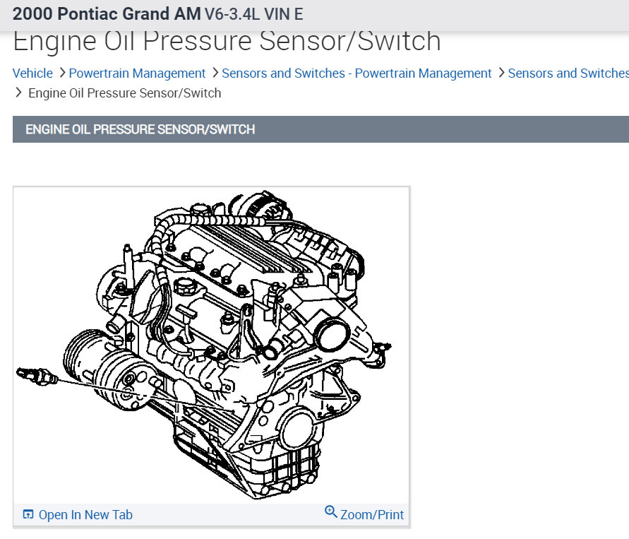

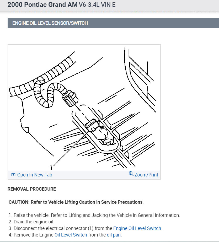

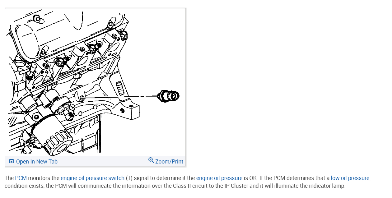

These engines have an oil level sensor and an oil pressure senser that will cut the fuel pump operation to help save the engine in case of no oil pressure or no oil left inside the engine if the pressure and level is okay the sensor can be bad giving the computer a false positive. Here are the sensor locations so you can check it out. Check out the images (below). Please let us know what happens.
