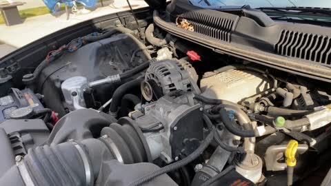

My car has an issue starting as you crank the key. At times, the very first start of the day is fine, other times its not. At first it seemed as though warm starts had more of a problem starting as you turned the key to crank but It has progressively gotten worse warm or cold.
No new additions to this vehicle, it's in great shape, oil changes, etc., as we only drive it in the summer. I would add that there are no warning lights or no check engine lights on dashboard.

It could be a few things. For example, fuel pressure drop off could cause a delayed start. Do you ever notice smoke from the exhaust or an odd smell? I ask because if there is a puff of black smoke, it could indicate a fuel injector is leaking or an extremely rich fuel mixture. What you could do is check the fuel pressure to confirm it is within spec.
Take a look through this link it explains in general how to check fuel pressure:
Next, there could be an issue with the engine coolant temperature sensor. That would require a scan tool to see if it is indicating an accurate temperature. If it is telling the computer it's colder than it really is, it will make the air/fuel mixture to be off. The interesting thing, if the temperature signal is wrong, the computer doesn't know it's wrong and won't set the light to turn on.
If it is possible, record it starting and upload it for me to hear. It may help me.
Take care and let me know if you have other questions.

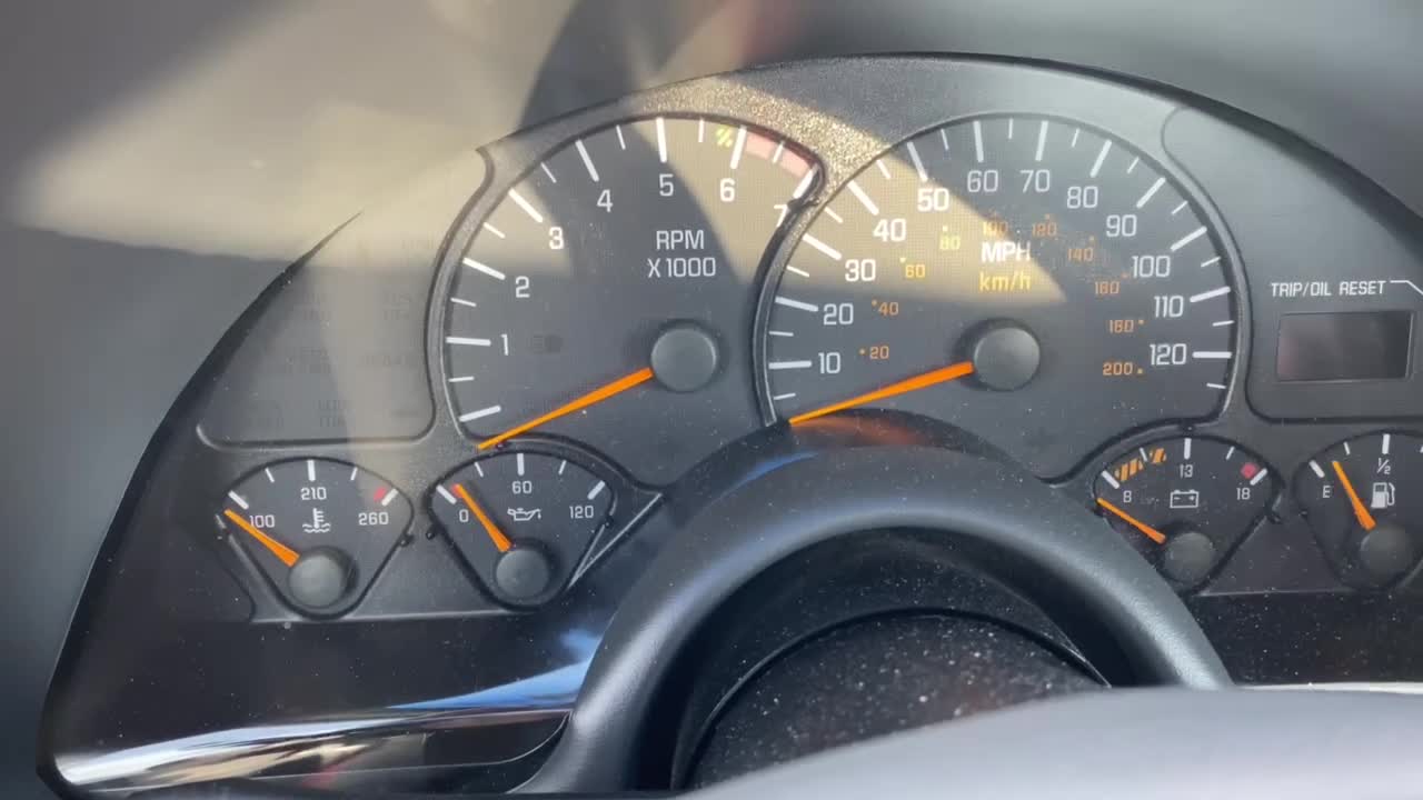

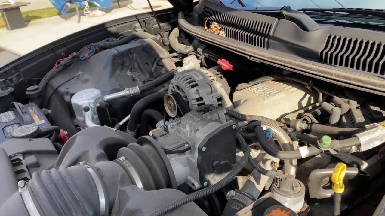

Thanks for the reply. This morning in Chicago it is around 30 degrees. The car is in the garage and I recorded the starting of the car this morning. It started successfully twice with no hesitation which is the normal way it would always start. We cannot tell anything from it other than the way it should be. I do smell exhaust when starting but that should be normal as it hasn't been started in about 3 days. I neglected to see if there was any black smoke from the exhaust upon startup.

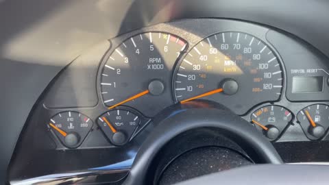

Here is the video of the cold start this morning. Let me know if there is anything else I can record.

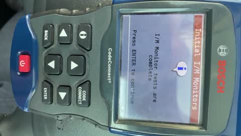

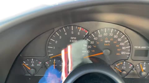

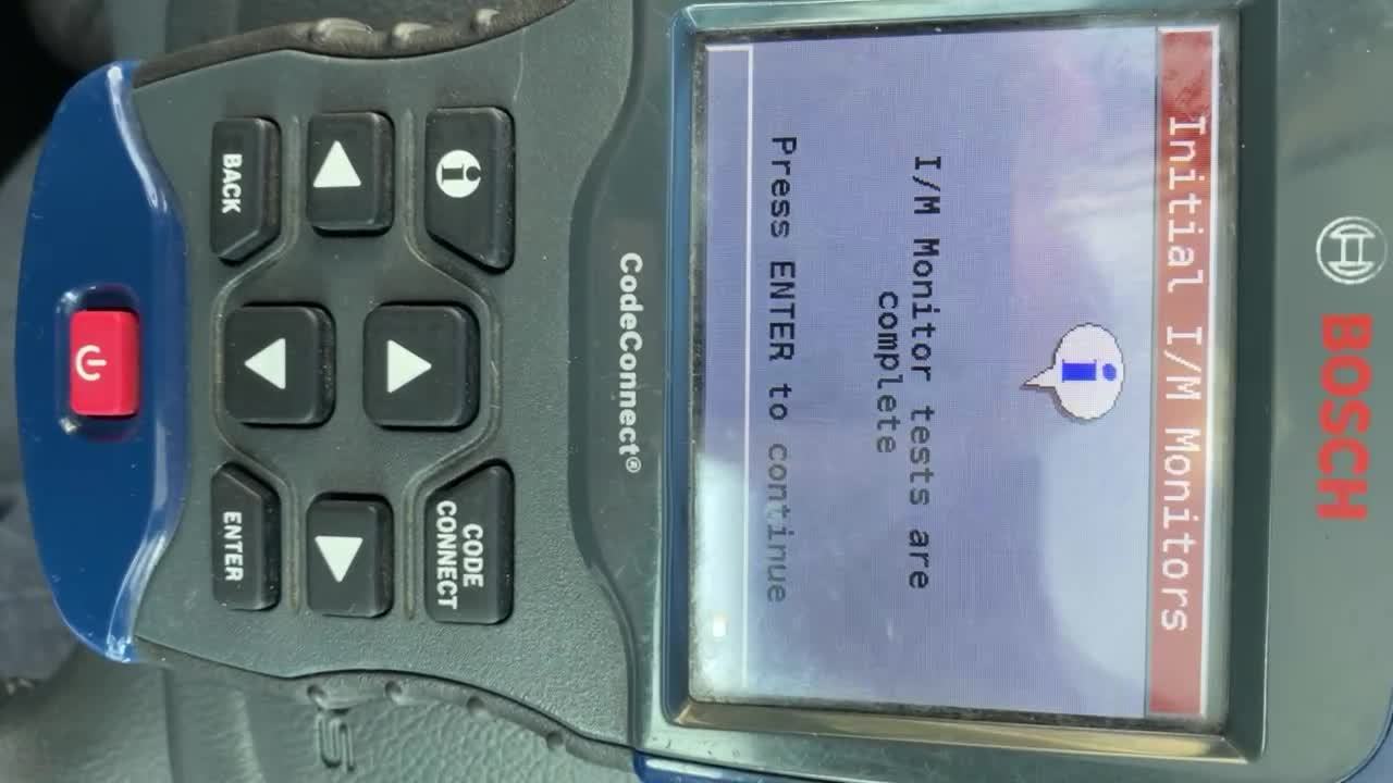

Okay, here is an update: I had took the car for a drive and sure enough after a short rest it hesitated on the start. I also have a video of running the scan diagnostics.

Scan tool results video.

I certainly heard it. The scan tool you used, does it provide live data? If it does, can you check a couple of things for me? I would like to know the short term fuel trims and the engine coolant temperature sensor signal. It sounds like there isn't fuel at first.
The short term fuel trims will tell me if there is a chance the fuel pressure is low and the coolant temperature sensor (ECT) can be sending the wrong signal causing an air/fuel mixture to be off.
One other thing, when cranking the engine, pay attention to the tachometer. If it is cranking, it should move a bit. If it doesn't and then starts to, it could be a problem with the crankshaft position sensor.
Sorry for all the tests, but without codes, this is what we have to do.

Hi Joe, my apologies for the long delay in responding. Holidays and winter weather do not give us a reason to use the Firebird in Chicago. Thank you for your assistance but I am not sure what I can do going forward.
The scan tool I used was available to me at no charge at my local auto parts store so its limited to what you saw, it records codes and gives the replies.
I assume a mechanic would have better tools, I assume?

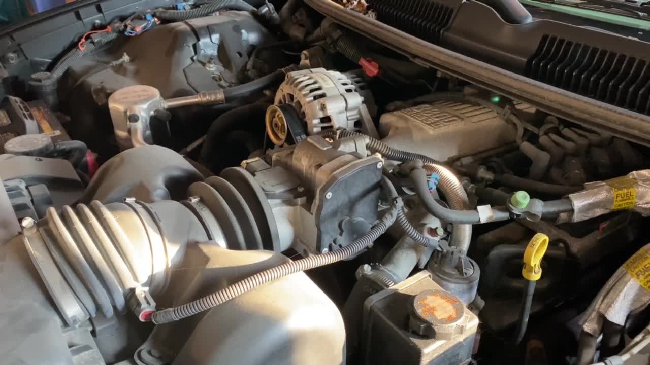

Hi Joe, I have an update for you.
In Chicago we have been going through some extreme cold and lots of snow but in between storms I was able to take it to my mechanic.
The short of it is that the Fuel Injection Pressure Regulator was faulty. There was also rust on one of the posts of coil 3/6. Not sure the coil was contributing but these two items appear to be the solution here. Thankfully, it wasn't too costly but like anything else, everything needs its time and money to repair and that is fair.
I am not sure if I can find a great video that illustrates or gives me assistance on where and what it would take to replace the regulator but I have a feeling that I probably could not have done this myself. Mainly because of the location and the tools I would need but also how to get the car started after the new part was installed because it seemed like there was a process that needed to be followed. Not to mention I don't do work under the car and dont have all of the tools, T-bits, like a shop would have on hand.

Fuel pressure can cause it. I could have provided the directions for you if you needed them. Regardless, I'm glad it's fixed.
