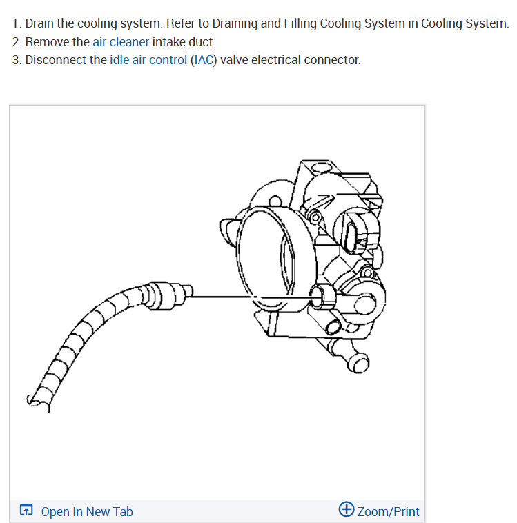

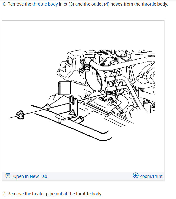

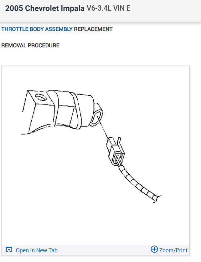

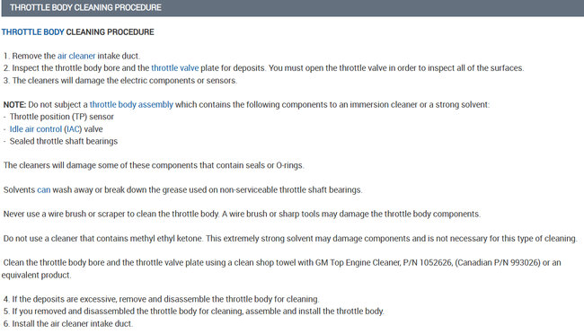

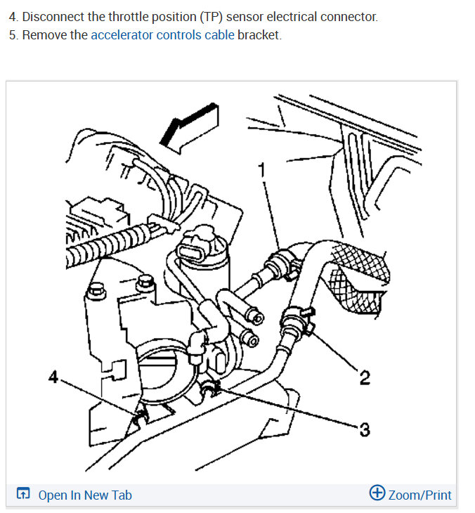

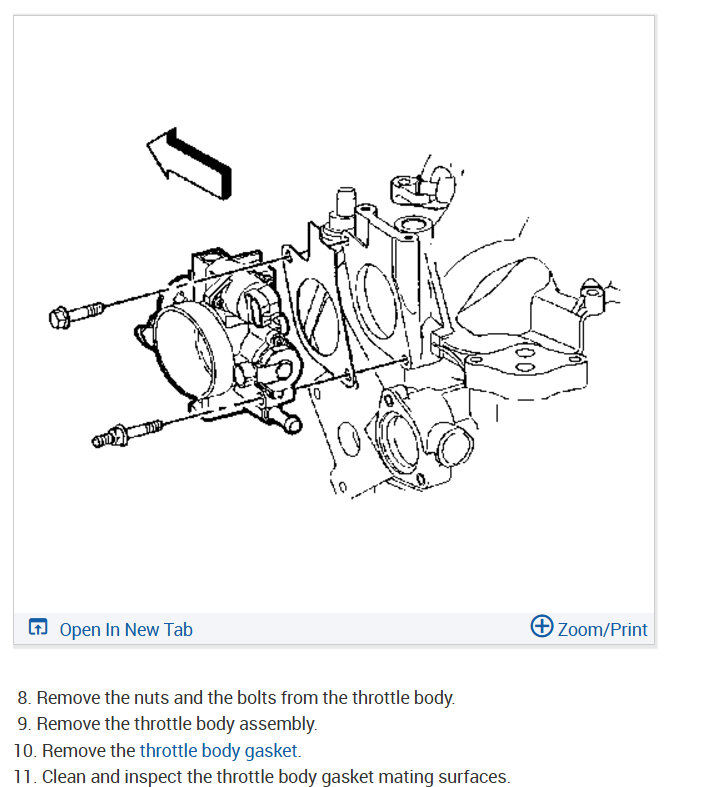

Most of the time this is caused by a throttle body that needs to be serviced, here is a guide to show you how and I have included instructions for your car in the images below:
Do you have any check engine light on? If so, we will need the codes, also clean the IAC valve on the throttle body as well. Check out the images (below). Please upload videos in your response of any problems so we can see what to help you with.
