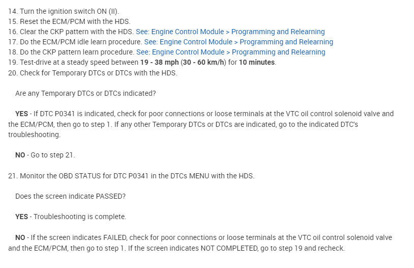

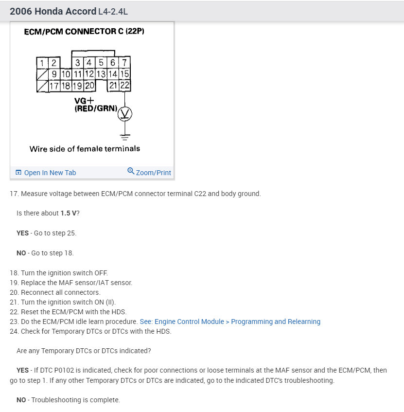

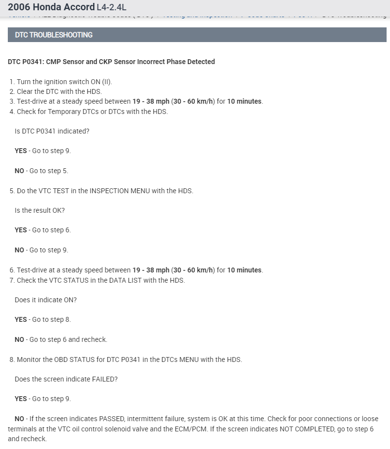

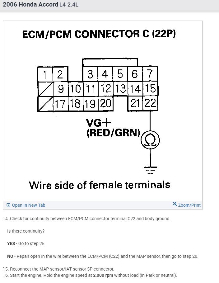

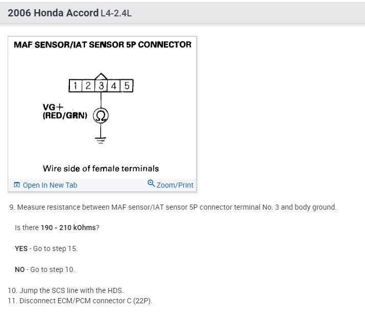

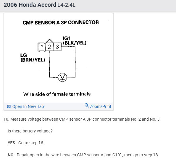

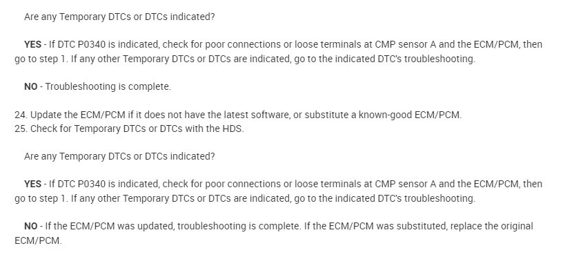

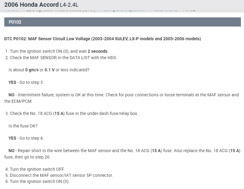

Hey, I have p0340, p0341 and p0102 codes. I want to know what’s wrong with the car?
Jun 17, 2022 at 2:13 PM
SQM
  • 6,383 POSTS

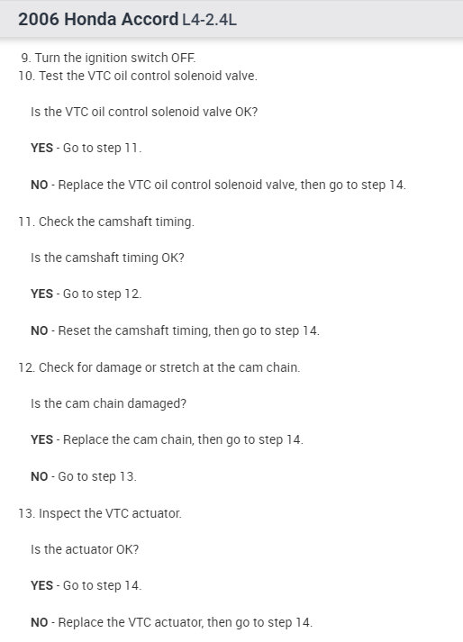

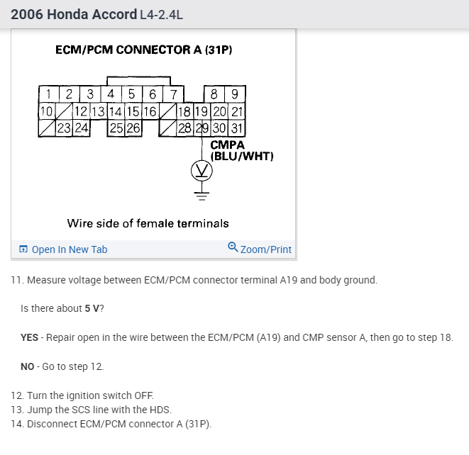

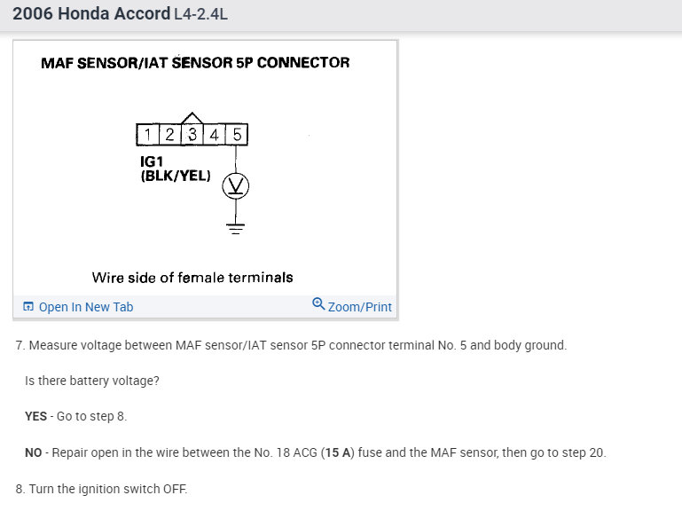

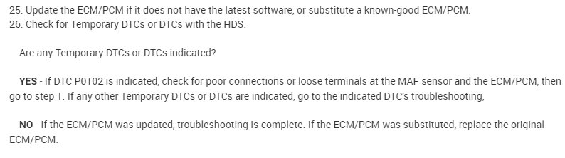

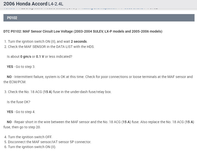

The codes

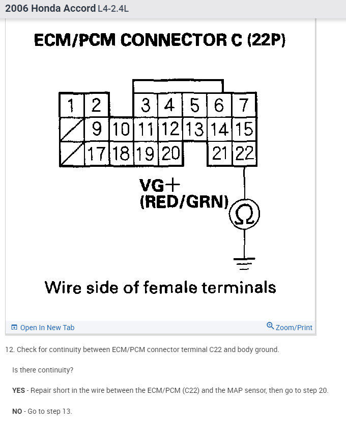

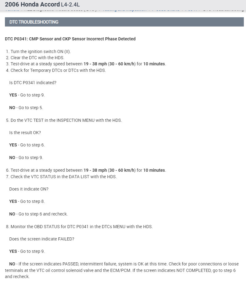

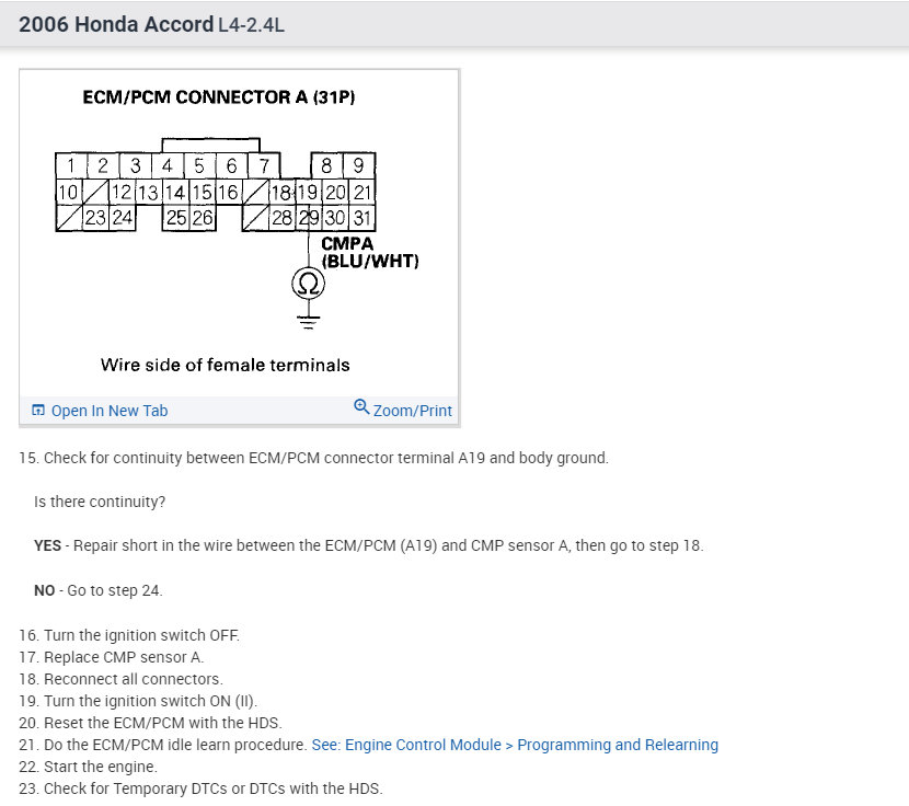

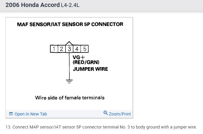

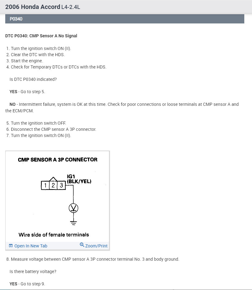

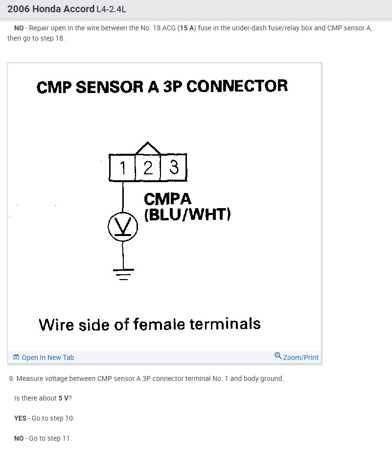

P0340: CMP Sensor A No Signal
P0341: CMP Sensor and CKP Sensor Incorrect Phase Detected
P0102: MAF Sensor Circuit Low Voltage (2003-2004 SULEV, LX-P models and 2005-2006 models)
These can get triggered due to faulty cam or crank position sensor, mass air flow sensor, wiring issues, could also be due to the ECM.
I have attached the troubleshooting guide for these codes below for your reference.
Follow those steps, as it can help you determine the issue.
Let me know of any questions.
