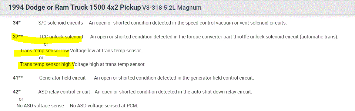

Getting both trouble codes. 32 and 37. 32 is EGR Valve but what is 37?
Also truck fills like it's taking off in second gear. Why would it do that?
Mar 18, 2022 at 10:03 AM
  • 110,240 POSTS

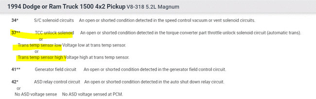

Code 37 is a transmission code. It indicates either there is an issue with the torque convert clutch circuit or the transmission temperature sensor. See pic below.
If it feels like it is in second when you pull out, there is a chance the torque converter is locked. Does it shift normally other than that?
See pic below.
